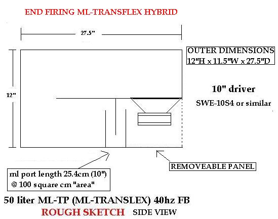

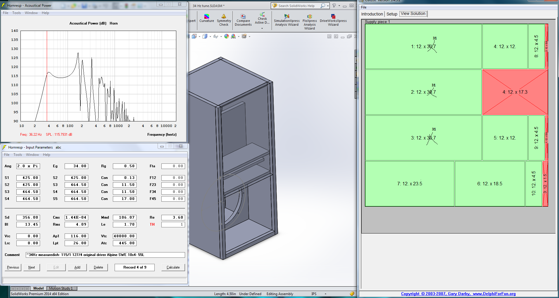

Question: what defines the conical connector lengths ? the box to the right of s2, s3, s4, s5 and by growing the box how much did they change? I have no idea how to convert the CAD for this into a number because I'm not sure what they are measuring.
Let me explain my reasoning behind using small strips (nominally the thickness of the material) running the joining side edges of the cab. at 12 inches wide per panel I don't have quite enough volume to get the tune/spacing right but 13 inches (or thereabouts) would not fit 4 panels to a 4x4, so I decided I would take a piece of alder, saw it up into strips the size i want and use those as "corner protector/panel joiners" with the side benefit of looking cool for when I eventually build a home theater version one of these and have different accents/stain for the different kinds of wood (eventually going to do a solid wood only variant).
I have no interest in response past 120 Hz and will be highpassing at 100 due to the Hornresp graphs but for educational purposes I'll definitely see what happens as I'm curious as to how accurate those insane spikes are as well.
One more thing* the rear panel in that model is set to transparent so you can see the inside, it extends as in you're diagram.

The fields next to "con" are centimeter lengths for the different segments of the pipe or horn, and normally they would help define most of the box with typical tapped horn , front loaded horn , tapped pipe etc boxes but since the majority of this box is actually made up of a giant throat chamber (defined by VTC and ATC) which means not only is this a little bit unorthodox but it also means that the S1 , S2 , S3 , S4 are just defining the very final section of the box (where the magnet of the woofer is) in other words the mouth of this box and it's associated chamber (section) ... The "con" after S4/S5 just sets the distance of the woofer's cone from the exit of the mouth...
"Con" (conical) can be clicked on to be made "par" (parallel panels) which is what we actually have when we build these boxes, but the difference between CON and PAR in the sim results are pretty insignificant.....Bass doesn't care.... Like most people I don't even bother with switching to PAR ...
I dont believe that the s1,s2,s3 etc will have to be increased by much in your scaled up model , only a little.. The sq cm should roughly match your "ATC" if it is a tapped pipe sort of configuration like this one is and your sim example is close enough ... and the amount of path length added by this section is effectively only several inches or so ...
To answer your question about moving the mouth/terminus to the bottom to make it end firing instead of side firing (or front firing), it is actually a great idea! , it extends the path length slightly which is good for you since you are trying to reach into the mid 30s 🙂 As you know it gives the box a different profile and a larger footprint, it would be a short & deep box arranged that way and if your friend is fine with that, then we have a winner 🙂 ...
Also , before i forget to mention, about inductance (le) , i usually run my sims slightly high on the inductance value just to try to get a slightly more accurate sim.. It is something i learned from reading the forums here on DIYaudio ... A higher inductance tends to smooth out the underdamped peak at FB and more closely matches the real-world measurements that people are observing ... However i have to say that it is not likely a discrepancy in inductance that causes the smoothing that people see in real world measurements, but rather the small amount of losses that come from building a box out of wood instead of unobtanium or granite (as hornresponse simulates).
It is likely that your real-world measurements wont actually show the saddle & peak , but if it does you can add some poly , wool , or fiberglass stuffing/lining to the first 20% of the path (the area where the front of the cone fires into) in order to damp the peak and fill in the dip .......

Trying to figure this out
So you're saying that for this box the S1=S2=S3=S4=ATC due to the way the design works?
I'm still not quite getting how I would modify the CON fields other than the last one. So the one's that you nominally set to 0.1, 10, 10 and I have as .13, 11.5, 11.5, what do those correspond to?
I bumped up the inductance from 1.7 to 2.5 to accomodate for what you said.
One issue I see with end firing is it would require a removable panel because otherwise you have no reasonable way to access the driver... Especially those 3 screws/bolts on top 🙂.
What kind of bracing would you use to reinforce the baffle mount? I was thinking a couple small pieces from the front to the baffle (opposite magnet side).

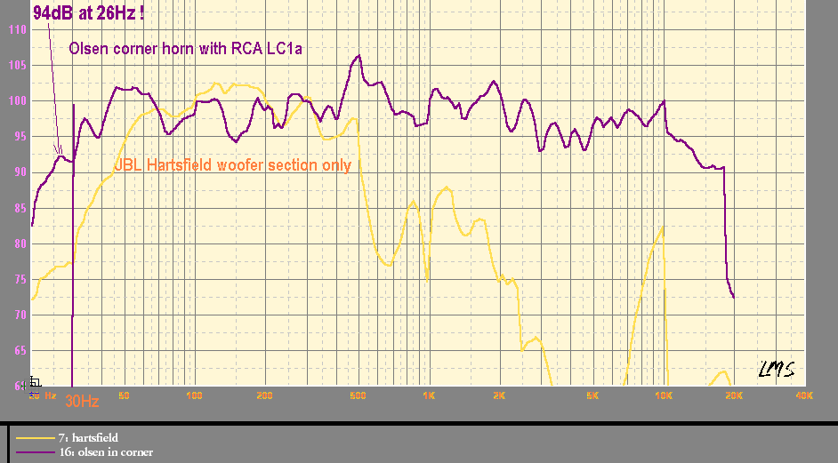

Right, Olson’s production compound horn studio monitor had this feature as did his corner loaded studio monitor, which even by today’s standards had an impressive performance loaded with his 15” ‘full-range’ driver [attached] and of course DSL’s end loaded tapped ‘horns’ do the same thing in the same novel way originally done by Jensen.

You pretty much got it, the throat chamber (ATC & VTC) make up the majority of this box , while S1, S2 , S3 and so on only make up the last bit of the box where the woofer's magnet and the box's mouth are ... The length of centimeters on S2,S3 etc is only about the diameter of the woofer since the woofer just barely fits in there (or the distance between the exit of the constriction (port) to the outside world which i suppose is roughly 12 or 13" at best measured diagonally on the non end-fire version , but with your end-fire it is a little easier to estimate...Nevertheless its a rough estimation but the cm length of that section being slightly off isn't going to make any big difference really ...
and yes, about the access panel, since you are doing an end-fire version i guess you will need one unless you build the driver into the box permanently😛 .... I suggest putting the access panel on the exit end of the pipe because pressures will be less there ...
Bracing would be moreso needed at the pressure end of the pipe (the closed end) and at the turn ... Arrange them parallel to the path like braces in tapped horns are arranged. Use thin material and be sure to put lots of big holes in them to reduce the amount of airspace taken up by the braces ...🙂

GM & Sabaspeed .... I decided to try to simulate this box in HR's "CH" (compound horn) mode ... 2 x SWE-10S4 per 100 liter cabinet ..... Interesting results IF the upper bandpass frequency is tuned to around 230hz it fills in the gap between the 3rd and 5th pipe harmonic and makes the response useable up to 300hz! (especially since the mass loading "constriction" of this cab shifts the frequency of the 3rd and 5th harmonic resonances somewhat higher than normal). This is great bandwidth for a 40hz tapped pipe!
Oh, and Sabaspeed, about the single driver cab, take a look at the sketch, im assuming this is what you were thinking about with the end-fire arrangement? A slightly scaled up version of what is in this sketch right?

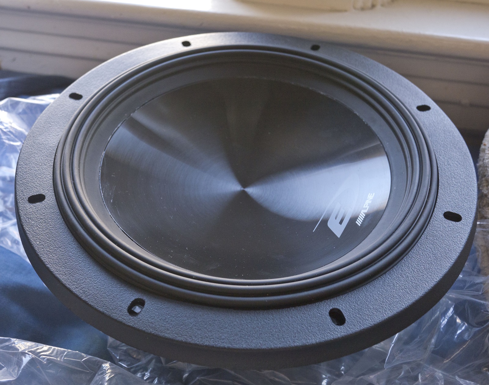

Drivers came early
Bolts with pre installed nut inserts are a pain in my ***, because they aren't always easy to find at your local store (with the size you want, and they take a drill press and time to get them done right).

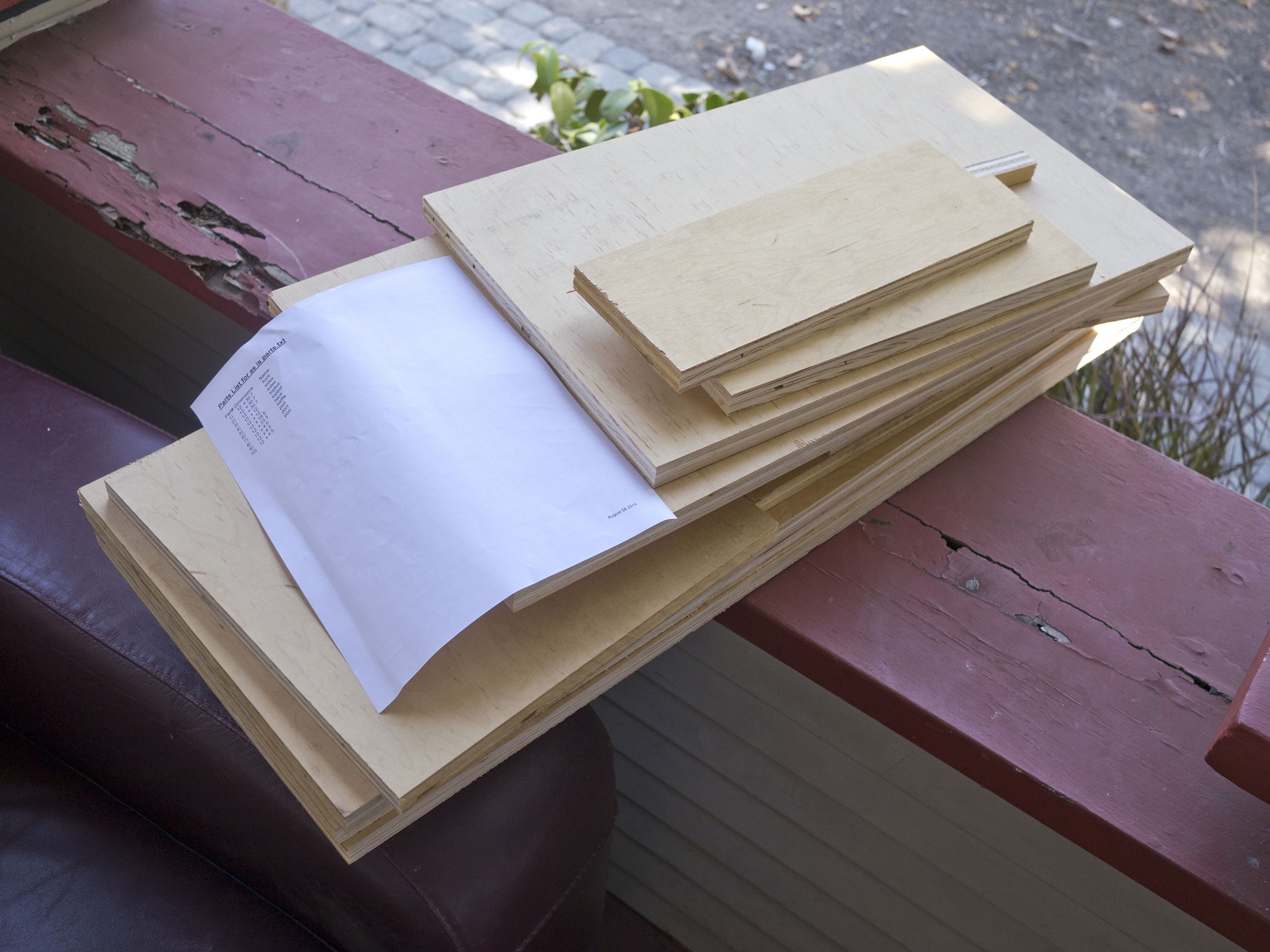

Driver in hand, wood cut. Probably starting assembly, trim cutting, and brace cutting on Friday.
Creative Car Audio is awesome, order drivers Thursday, shipped Friday, Arrived across country (California) Tuesday. Did I mention it was UPS Freight and free? I'm sure glad shipping was free, these things are 13 pounds each. Quite high build quality for a Car audio 10 IMO.

I am glad your order went so smoothly and that the delivery was prompt🙂

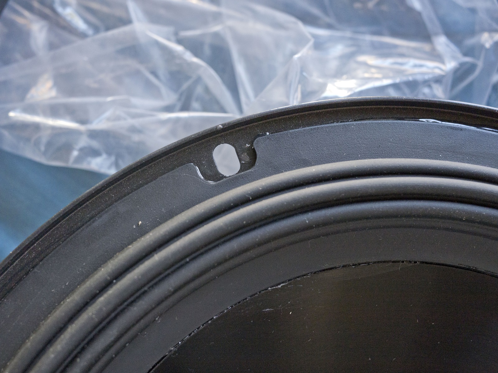

Did you know that those drivers use santoprene surrounds? Neat stuff, and tough! Should be long lasting and impervious to the environment, much better than foam in these regards..
The Alpine SWE & SWS series are revered as being well built, well designed, durable and great performers, especially for the reasonable prices that they go for..... Its also nice that they have the specs that can be useful in higher efficiency alignments, not just the simple car audio boxes that most people use them in ... You can find lots of positive reviews for these drivers online ....
Since your boxes are tuned down to 35hz some of the SWS 10s might also be a good option for you if you needed even more XMAX and power handling but of course they are a little more expensive, still a great value though considering what they are capable of ......

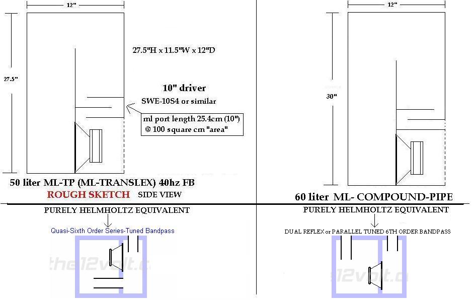

I made another sketch for you showing the differences between what i have simulated , you can see we are basically making equivalents to bandpass cabinets but working in some quarter wave action to benefit from the higher efficiency and increased bandwidth of using this type of loading... The plenum/bandpass (smaller chamber) resonant frequency is easier to predict with the parallel (compound pipe) version. ... These are 40hz versions just for example but of course you would want to scale up if needing a 35hz FB, however some of these sims show that even with the 40hz tuned cabs 35hz is only 3db down (excursion is exceeded below that at full power though) ...
For the sake of this comparison I made them similar in size with the larger cab being only slightly taller but I think that the compound version made even taller (longer path) simmed a little better with flatter response up into the midbass , however this makes the cab less deep so the plenum (small bandpass chamber) will be tuned too high to be effective, so some mass loading like what you saw in the compound scoop pictures i posted earlier would be required to bring that resonance back into the proper range .. Its easy enough to achieve, you just add a plate mounted in front of the small chamber with a constriction .. Easy to sim too ..
