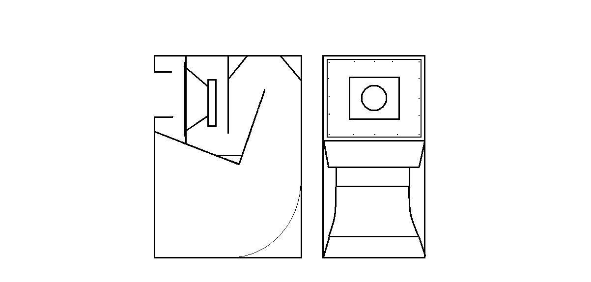

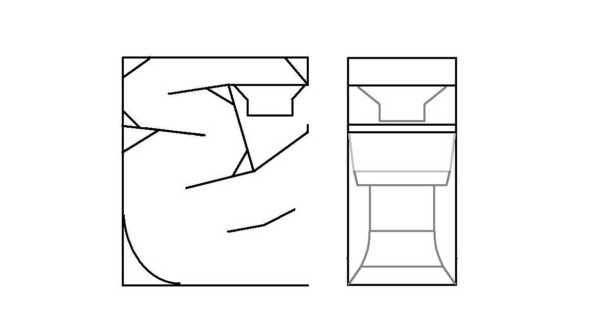

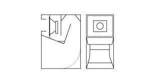

I tinkered around with HR a little more to try to approximate the proper shape of the first section and of course it puts the driver too close to the constriction , so even though there really isnt any way that i know of to fully sim this box in Hornresponse i do see that lo-and-behold this shape does shift the FB up by a few hertz ... So good call .. I didn't notice that before ..
I did however come up with a variation that we can fully simulate using the throat chamber function .... Looks like it only loses a db or so, and is still as simple as the other design while still maintaining similar outer dimensions (or even a little smaller) .... It is a little more flexible too and could possibly accommodate a wider variety of drivers since changing the shape and length of "Lpt" and "Ap1" seems to have significant effects upon the response curve..
Extension seems slightly better and the low compression ratio (almost 1:1) should reduce the likelihood of physical damage with the drivers such as cone failure ..
Tell me what you think of this ..
I don't see the constrictions shown in your drawing implemented in the HR input page. What you have is similar to a push-pull (PP) tapped pipe, here is a model I made for Legis in this thread: http://www.diyaudio.com/forums/subwoofers/258706-study-dipole-cardioid-bass-horn-14.html#post3994808
If you get AkAbak it would be easy to modify geometry of script to simulate your transflex PP tapped pipe.

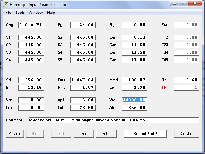

Ok , I will explain about this smaller box ,I refined my inputs on my Constricted-PP transflex design so now the area is the same on both pipe sections like you would expect with a tapped pipe ..... Take a look at the figures in the lower fields ... I am using the throat chamber function to create the first half of the Tapped Pipe ...
VTC= defines volume of first chamber section (before the constriction)
ATC=The area of the first chamber section
Ap1=Defines the area of the constriction (port)
Lpt=Length of constriction/port
I used a VTC of 48 liters and an ATC of 600 sq cm which creates a pipe shaped chamber of about 80cm in length .... The other pipe section is defined with the typical S1 through S5 inputs which i made to match the first section's length at 80cm also, giving a total of 160+20 (constriction length) for a total of 180cm path length which tunes the box to 40hz .....

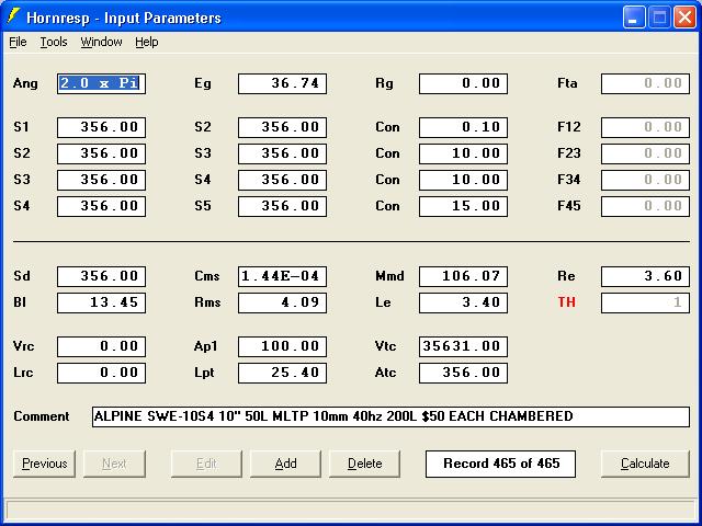

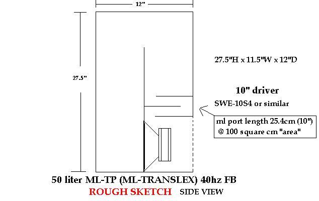

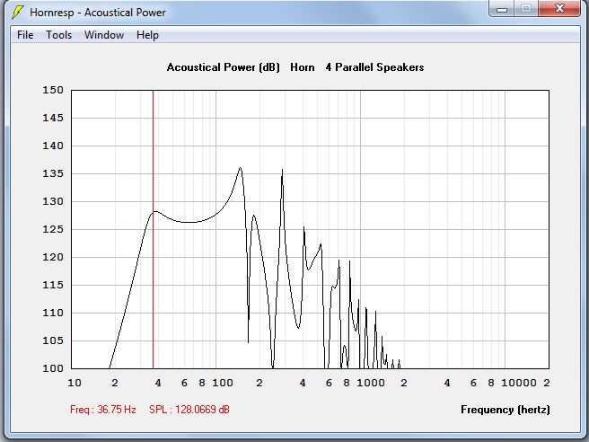

Of course one could say: "forget about these complications like saddles and constrictions, and lets just keep things simple by putting each 10" woofer into it's own 50 liter 40hz tapped pipe!" which actually looks really good in simulations but unfortunately as it turns out the slender physical dimensions of a standard 50 liter tapped pipe tuned to 40hz is a bit too small to shoehorn one of these Alpine 10s into, not ideal, magnet would probably stick out.... 🙁 ... hmmph ...

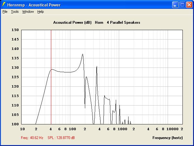

SO LETS EXPLORE ANOTHER OPTION 😉 ..... Something I came up with while experimenting with the throat chamber function in hornresponse some more last night .... It is possible to fully simulate A mass loaded tapped pipe, a sort of a mixture of an ML-TL (a widely used and trusted design) and a Tapped Pipe but the "mass loading" (a constriction) is placed in a spot that allows the upper bandpass limit to be raised giving this design more bandwidth than any typical 40hz tapped pipe! The mass loading also allows the physical line to be shorter changing the 50 liters worth of dimensions to something thats a little less toweresque and moreso cube-ish and fitting the 10" driver is now much easier 😀
Upper bandwidth cutoff is now 180hz instead of 140hz ... A little bit of stuffing/lining in the first 30% of the line would smooth out the small slightly under-damped response bump at 40hz (if it is even noticeable in the real world).. Response above 50hz is only down by roughly 1db compared to these other designs I have posted here, and it is a worthwhile sacrifice for the extra bandwidth ... Design is still very simple, and no need for an access panel! Cool eh? 😎

Using the constriction in the design above can help alleviate the "saddle" or smiley face response curve that you run into in some situations .... The "saddle" can become even more of a problem when you start spanning multiple drivers down the path due to having to move your "L12" and "L45" points further away from the ends of the pipe (IE 30cm instead of 15cm) In order to accommodate the extra driver or drivers being spanned down the path (when spanning you are supposed to use the center points between the two drivers for simulations) ... So in this case (multiple drivers spanned) a constriction can (under the right conditions) help compensate for the change in response and help prevent the saddle effect .......

Here is an alternate "Grown" version using 12 inch wide panels with connector joints such that the internal width and depth are 12 inches. I wanted something that would do 35 Hz because for EDM that is basically a must. This cabinet is usable down to ~33 Hz in groups of 4 and 34-35 in singles and the simulation uses the provided 1.7 mH value (from manual), It will be interesting to prototype this and see how close it is to the sim. If anyone else has actually built this design let me know, I'd love to hear about real world measurements.

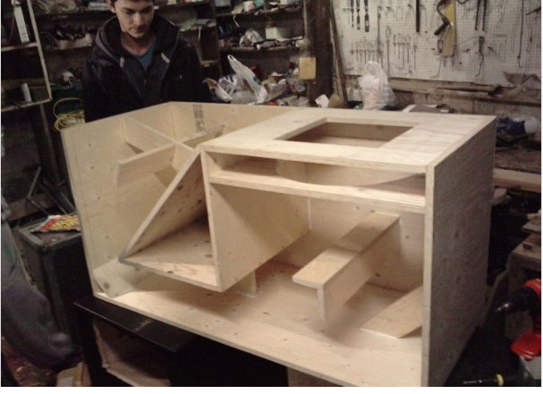

Cad completed and wood cut
Just cut the wood for the sub today, takes almost exactly half a sheet of plywood. I'll be using 3/4 inch because I have 2 4x4's of it that I got for free, half inch could be used with more extensive bracing. Drivers arrive Wednesday.
I will keep posted my build details/completion/testing because I believe I'm the first to test build this design (at least in this thread).
Sabaspeed ,
VERY COOL ! looking at the inputs im guessing this is a scaled up version of the ML-TP (ML-TRANSFLEX) hybrid that i posted earlier , right?
