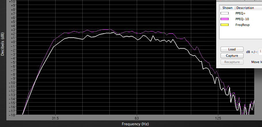

Now let's get back to this.
1) The port is doing very little in this design compared to the driver radiation, and the port is only 6 db down in output at 100 hz compared to it's 40 hz tuning. So this means that the port in this design is doing almost nothing, but the little it is doing it's doing over a very wide bandwidth so 40 and 100 hz will both be very much affected by port compression.
2)Ideally a completely different design would be chosen to study port compression, more like the one in my last post.
3) It's not a bad design but it's no good for THIS study.
JAG,
1) The Hornresp simulated output of the port below 50 Hz is louder than the radiation from the slot (Horn). The port output at 100 Hz is around 16 dB less than the radiation from the slot. The excursion minima at Fb allows a large EQ boost without over excursion, not possible in a sealed enclosure with similar raw response.
2) Ideally, a test of Mathew Morgan's Transflex design would be conducted at various levels to determine if the constriction leads to a compression issue.
3) As a study of port compression compared to predicted port velocity, though perhaps not an ideal case, it provides useful data. The measurement below using pink noise is more indicative of real world response than the sine wave tests we were looking at. The PPEQ+ curve shows response with the amp just hitting limit (around 2500 watts) using the EQ required to flatten response, including the upper crossover filter. PPEQ-10 is the response with 10 dB less drive level (around 250 watts) raised by 10 dB. Worst case compression appears around 90 Hz, compression in the range where the port's contribution is primary is just over 1 dB.
The "Shoehorn" PPSL2x15" has a Hornresp calculated particle velocity peaking at near 48m/s at 23 Hz, around 34ms at the 40 Hz Fb, falling to around 8m/s at 90 Hz (the slot output reaches a maximum of 16m/s at 18 and 78 Hz). The actual measurements show only one dB compression in the port range over a 10 dB increase in power.
The upper response exhibits more compression, while using only a fraction of the LF power, it appears that calculated particle velocity is not adequate to predict compression effects.
Art
