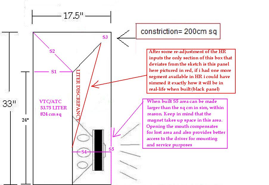

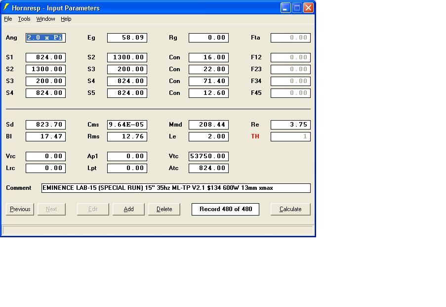

XRK ,
I put something together or you , maybe it will help you with the Akabak modeling.. ....
I used more than just the four segments because i also used a giant throat chamber to form the first portion of the path .... I added highlighted notes to the sketch which show how the Hornresponse segments and chambers correspond with the actual parts of the cabinet as it would be built ....
I was also able to adjust Hornresponse to more closely approximate the dilation in the path (S2) just before the constriction (s3) , it really didn't change the response too much but at least it matches the sketch more closely now..
On my brightly colored sketch notes, the red text and red depiction explain the one shortcoming of HR to sim this box, i would need one more segment to fix this area in order to match the sketch perfectly .. So that last section shows a longer portion of pipe with expansion in HR when in reality it should be a shorter area with expansion followed by a straight segment with no expansion which then leads to the mouth/exit ...... This accounts for the discrepancy in volume seen in HR versus the box's outer dimensions ... The actual built box wont have any wasted space internally, and the slight downward shift in FB caused by the altered contour of the S3-S4 segment can be offset by making the mouth/terminus large enough to have easy access to the driver ... So it should all work out well !
I am feeling pretty good about this updated Lab 15 (special run) ML-Transflex design now, it has a flared vent, and the velocity in this Eminence box is now lower putting it within the same range as the Alpines in the earlier style of the ML-Transflex cabs like Saba built, and according to the feedback we are getting from Saba it looks like neither chuffing nor port compression are really much of an issue at all with these boxes even at these power levels (250w for the Alpine and 600w for the Eminence in the bigger box) =)
Now, perhaps i will try to adapt this same thing to the smaller Alpine box to update it and lower the simmed velocity on that one as well .....

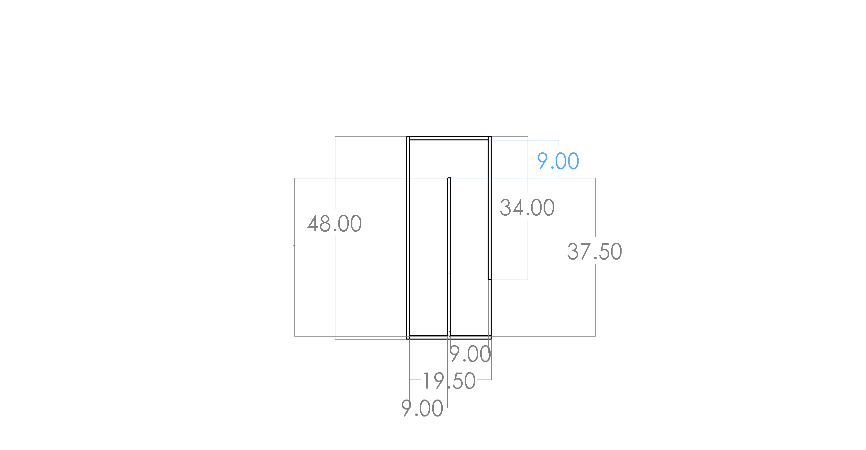

Rather than talking about the small alpine box can you guys critique this "big" straight pipe alpine box and label the respective hornresp parameters on this side view?
I have the full model in solidworks for the alpine sws15d4 and was hoping folks could comment on how I can make the hornresp match the drawing.
Here is what I tentatively have as inputs (image 2)
How can we make this simple alpine pipe into something a bit more compact like the lab 15 design in such a way that it doesn't exhibit port compression and is still easy to build?
Maybe we can see if a slightly flared shorter version of this could work.

Saba ,
That is a classic tapped pipe or Transflex (or JBL Air coupler) ... It is basically a tapped TL (or more specifically a tapped "QWP") and it can work very well if everything fits and the driver's parameters are appropriate for such an alignment ...
It is very easy to simulate in Hornresponse and easy to build... I can post the inputs if you like ...
It was actually the first thing i tried for the Lab-15 but the footprint was a bit too small for that driver in my opinion so that is what prompted the need for the constricted version, in order to shorten the line by a bit and allow a bigger footprint with less height.
Another option (as JustaGuy suggested) is to use a reverse taper, that also allows a reduction in path length and a larger footprint, yet a nice compact box ....
There are many ways to skin a cat as they say (what a horribly sadistic saying that is , who came up with that?!?

That would be great if you could post the inputs, I think the alpine 15 should work for that kind of alignment.
Sidenote: why couldn't you just make the box deeper to accomodate the lab 15? I see no reason why you couldn't do that.

S1 is the throat, S2 in the driver center point a few cm past the throat, S3 is the mouth. You could break that up into more segments if you wanted but those are necessary. That's really all that's shown there.
There are a few tutorials on this. Soho54 made all kinds of pictures to explain everything if you can find his tutorials and posts.
As these are areas, where is S2 vs S1, what do you mean by a few cm past the throat? The whole pipe is the throat...
Just trying to make sure I get what you're saying.
The examples I see by google searching tqwt all are "tapered quarter wave tubes" and as is mine isn't tapered at all, I'm open to looking into that but I'm not sure how to "set the taper" if you will. Will do more research.
Here's a few images from google image search. None of these are straight pipes like yours but this shows how the Hornresp input markers line up with the physical parts in different designs. The 2nd pic is a tapped horn, so just change the segment shapes a bit so all the segments are equal csa and that's it. Horn folding is a whole other ballgame, there are many ways to do it and you already had a few links posted for you. Advanced centerline method is more accurate than centerline method or the Sketchup tutorial method.
