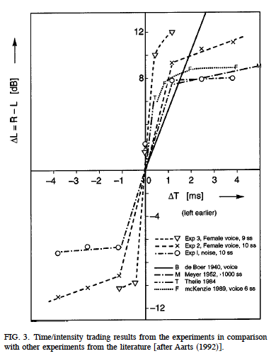

I was more asking what you think the intensity difference needs to be for a working time-intensity trading effect. I've tried speakers with even higher directivity than the Nathan's and there was no trading effect.
It doesn't matter what the ideal is, it matters how well real speakers can do this and how best to set them up to achieve it. The theory says that this trade-off should work and for me and most others it does and it does it very well. Why it fails in your situation is not something that I can explain. Maybe your speakers are broken?

I've tried with other speakers and it also didn't work. The effect seems to be very fragile and signal-dependent:
From Rodenas et. al., "Derivation of an optimal directivity pattern for sweet spot widening in stereo sound reproduction"
J. Acoust. Soc. Am., Vol. 113, No. 1, January 2003
Not sure that I understand the graphs. Is this for a complete pull of the image to the nearer speaker? Or is this a just detectable pull? It's not clear. I don't have the JASA journals to read.
If its a complete pull to the nearest speaker then it is way off from Blauert. If it is the detectable level then it is completely consistant with Blauert and what I am doing. I have trouble believing that Blauert could be so far off.
