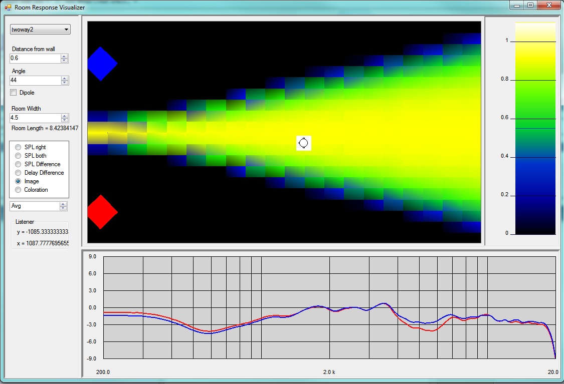

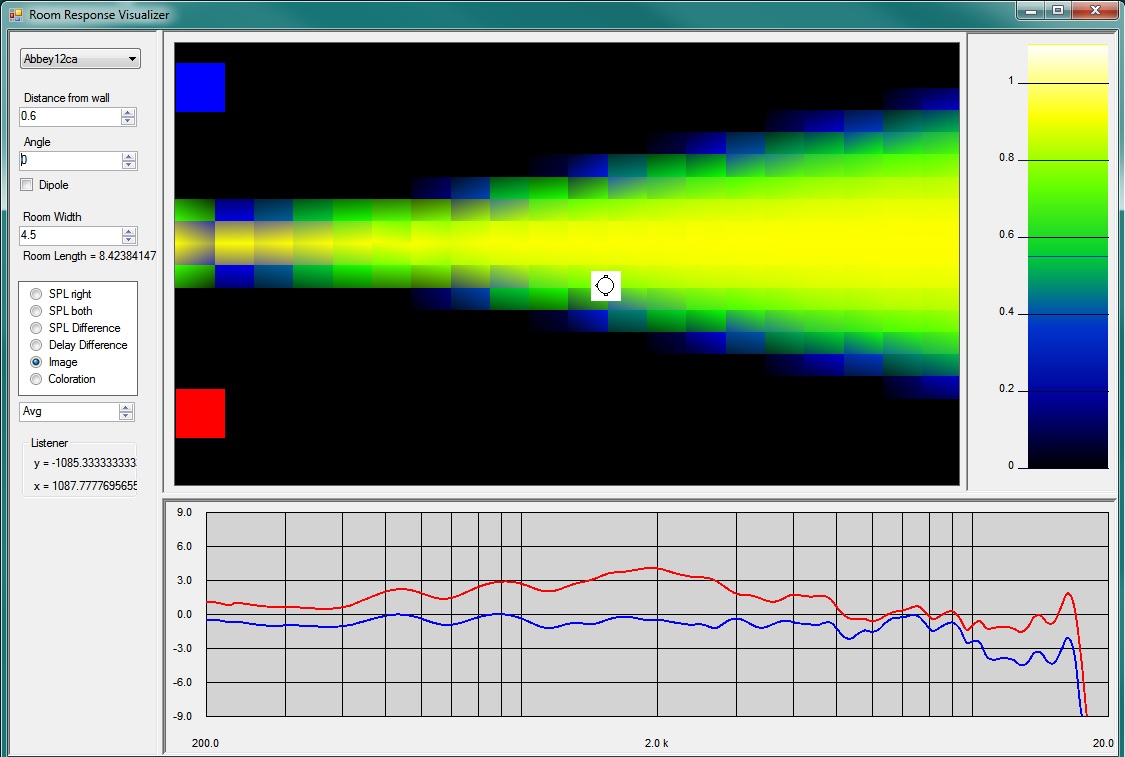

Here is the same room and listening position but a standard two-way speaker. Image is about the same as the Abbey pointed straight ahead.
Second pic is the same speaker toed in. Not much improvement in image, but some degradtion in frequency response.

I will admit that the entire validity of these plots (for image) is founded on the validity of Blauert's Fig 3.5. I assume that this figure accounts for head diffraction since the setup shown has crosstalk.
Blauert also says "These curves have not yet been sufficiently verified by measurement to be useful other than for qualitative study." Precisely what is being done here.

As my app will show, it does not work for a lot of speakers. The image may not shift, but the frequency response goes all to jell.
So for what speakers does it work? The Nathan is not one of them.
The "frequency responses" in the pictures are complete bogus. It does not model the comb filtering of the interference field from the two speakers.
It doesn't? Then what does it show?
I also don't know what pictures Earl is referring to as I only have the German version of Blauert's book.
He himself said "The right speaker feeds the right ear only and the left speaker feeds the left ear only."
As I said this is equivalent to headphone listening. No interaural cross talk of any kind.

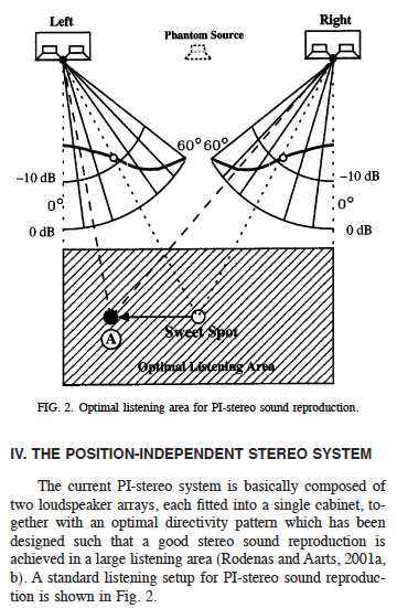

A geometrical model is described in Kates, "Optimum Loudspeaker Directional Patterns" (JOURNAL OF THE AUDIO ENGINEERING SOCIETY, 1980, NOVEMBER, VOLUME 28, NUMBER 11)
