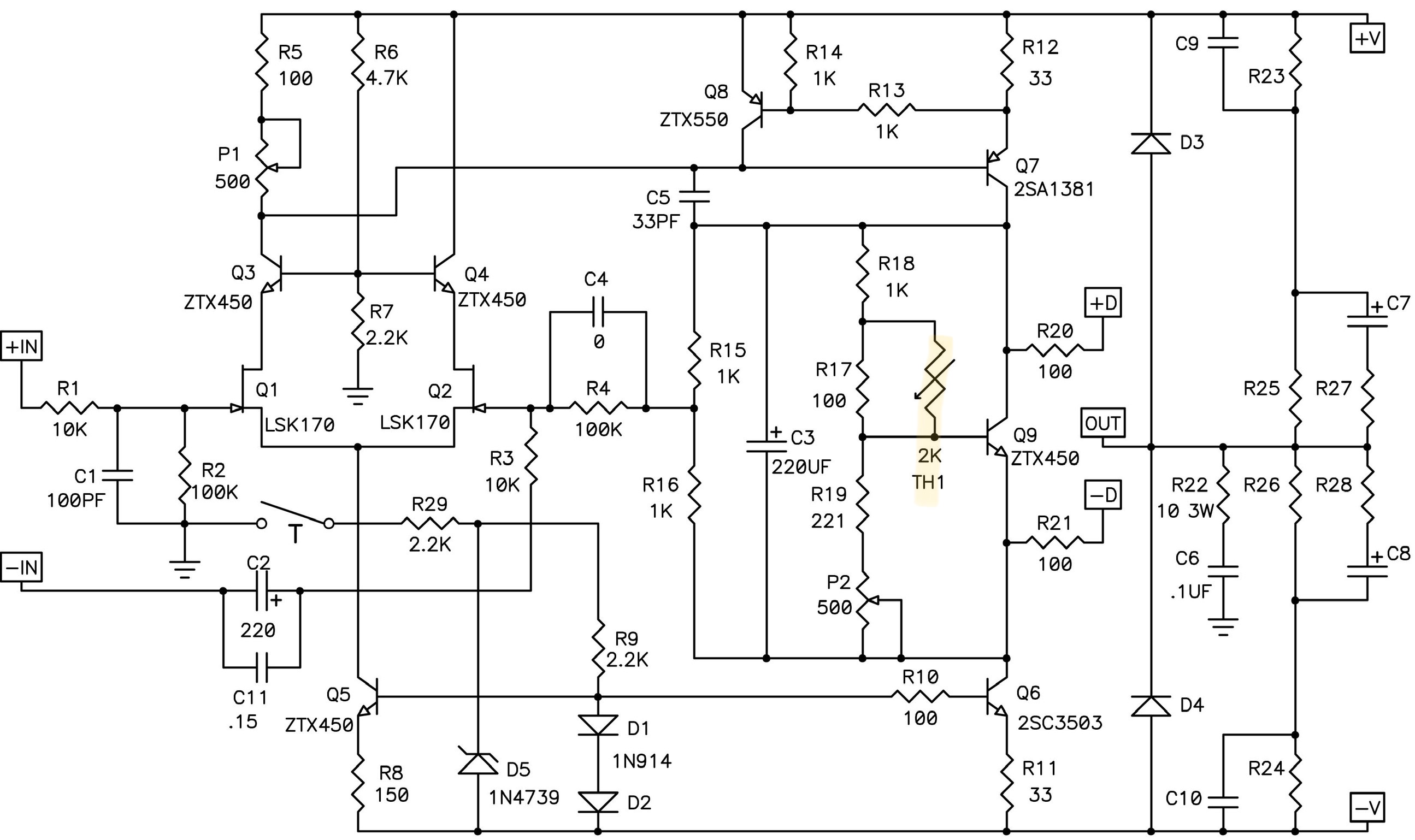

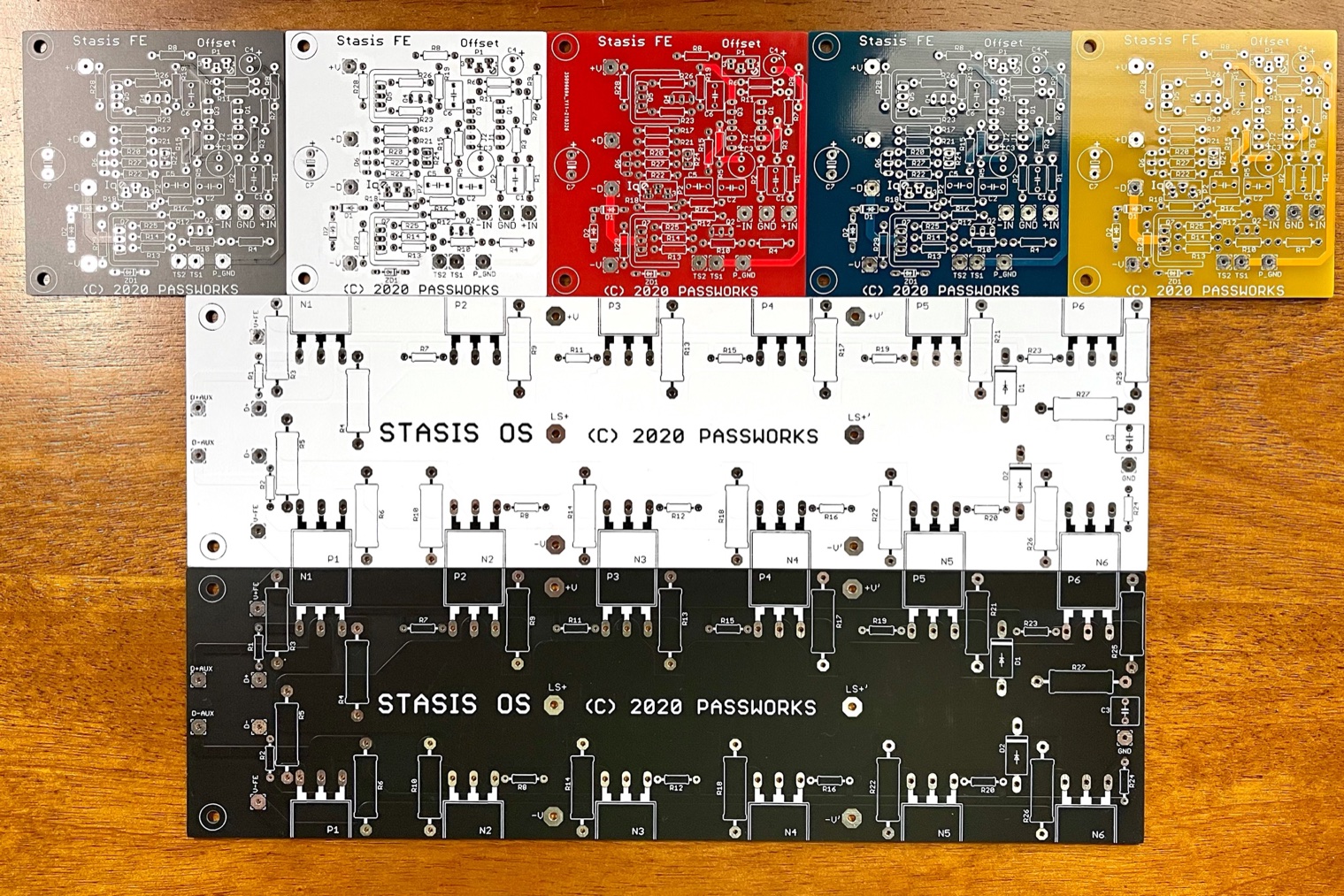

OK, I'm about to order the FE and OS parts but I still have a few noob questions:
I'm thinking 2 * 6 Deep OS PBs per channel so 11 Pairs per channel, 80 VDC Rails?
1. I know I have to change ZTX450 and ZTX550, do I need to change Electrolytic Caps C3, C4, C7 for a higher voltage Rating?
2. Is Mouser Part# 527-NK202C2R5 a good option for R24 2K Thermistor?
3. KSA1220 is Out of Stock, any other good pair to substitute 2SA1381 and 2SC3503?
4. Has anybody tested any Capacitor in C5?
Any suggestions on a good Power Supply Design 😀 ?
Thanks in Advance!

80Vdc rails ?
no need to change any cap voltage
need to recalc R8, R9 , to keep JFet voltage at bay ...... say no more than 15-20V (ZM Chicken Book sez so); no need for more than 1-1.5mA through these res.
trannies - account on both voltage and dissipation; more than 200mW per tiny TO-92-like, use slip-on heatsink
same applies to Q5,Q7 - check temp. when done and- if you can't keep fingers on them , increase length of h'sinks
2. seems OK
3. eek, next question
4. Pa sez - do not; when done , observe squares; then you'll know
really - 80V ....... better wait Big Boy to chime in, to give few advices ........ he's the one who knows that OS
all part names ref. to schmtc of my Picolo pcb

TH1 is it possible to use 1K instead of 2K .
Possible, but 2k gives the best tracking for the original design. Go ahead and try it.
Ok, I’ve been running some simulations and looks like for 80V rails I need to change R8 to 20k, R9 to 6k to keep JFET voltage around 18V, sounds right?
Also simulator shows R13 going PoP, having to dissipate over 2 Watts, so looks like that one needs to be changed to 30k to stay under 250mW or 20k and use one of the small .5W resistors. Does that change have any adverse effect?

80V rails
R8 68K, R9 12K ; normal peanuts 600mW will do
R13, increase to 9K1; dissipation is then 550mW - you can buy 1W MOX in 0207 size, just elevate it from pcbm some 5mm or so
or even better - put two 4K3 (600mW peanuts) series in R13 position - vertically, connect them horizontally in between
again, everything ref. to small FE pcb
