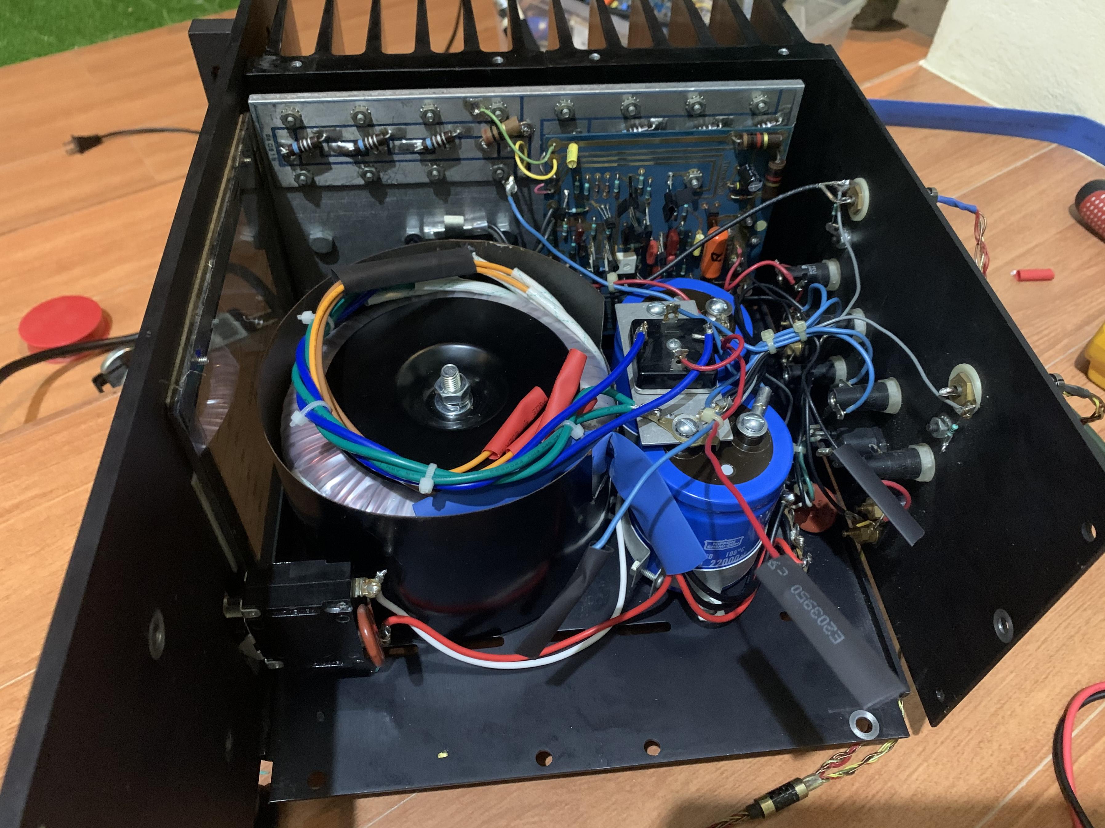

Built the boards, just waiting for the case to arrive...

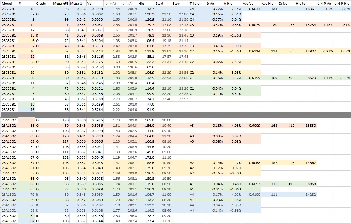

What’s a good tolerance for matching the output stage BJTs?
It's a compromise between what you want and what you get.
I bought a batch of 40 pulls (used) from Ali and managed to get 3.5 sets of 2 x (1 driver + 3 outputs), with a Vbe match < 1.5% and a Hfe match < 5%. The .5 set (light blue) is because I ran out of suitable driver, so, the Hfe match is off; the Vbe match is still good though. Anyway, 2 sets is all I need.
Interesting to note: in the world of semiconductors, sexual equality doesn't exist, and the PNP's/P-channel's always perform better.
Ah I see. I was looking at 1% tolerance on the Vbe and 10% on the Hfe so I’ll tighten up the Hfe tolerance. Thank you
