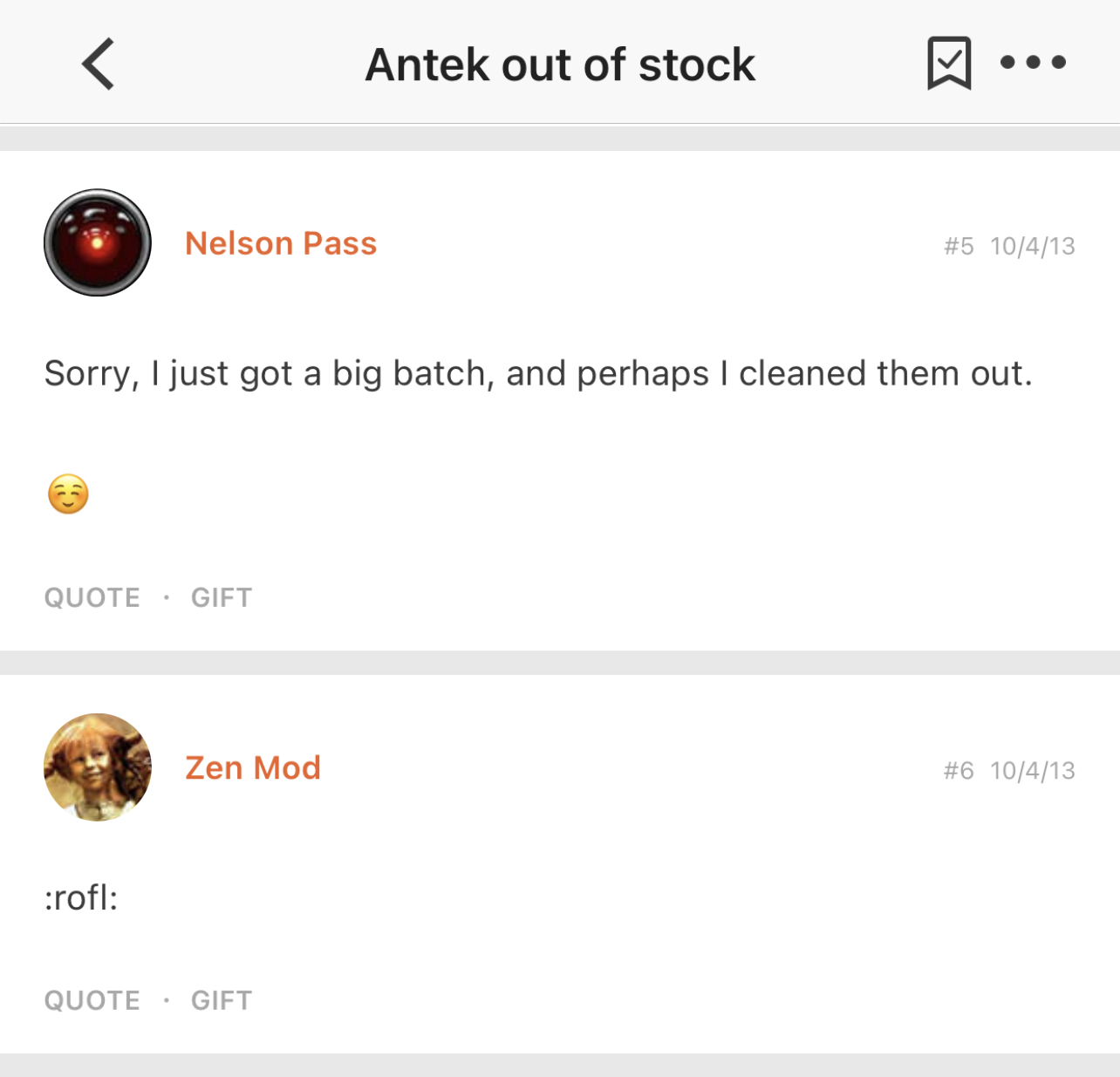

As I try to design the Welder Power Supply I’ve been looking at Antek Toroidals and I found Papa’s comment (picture) in a post, I guess that’s enough for a blessing?
Is there any other brand that won’t break the bank, fairly priced like them that you can suggest?

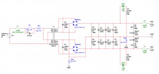

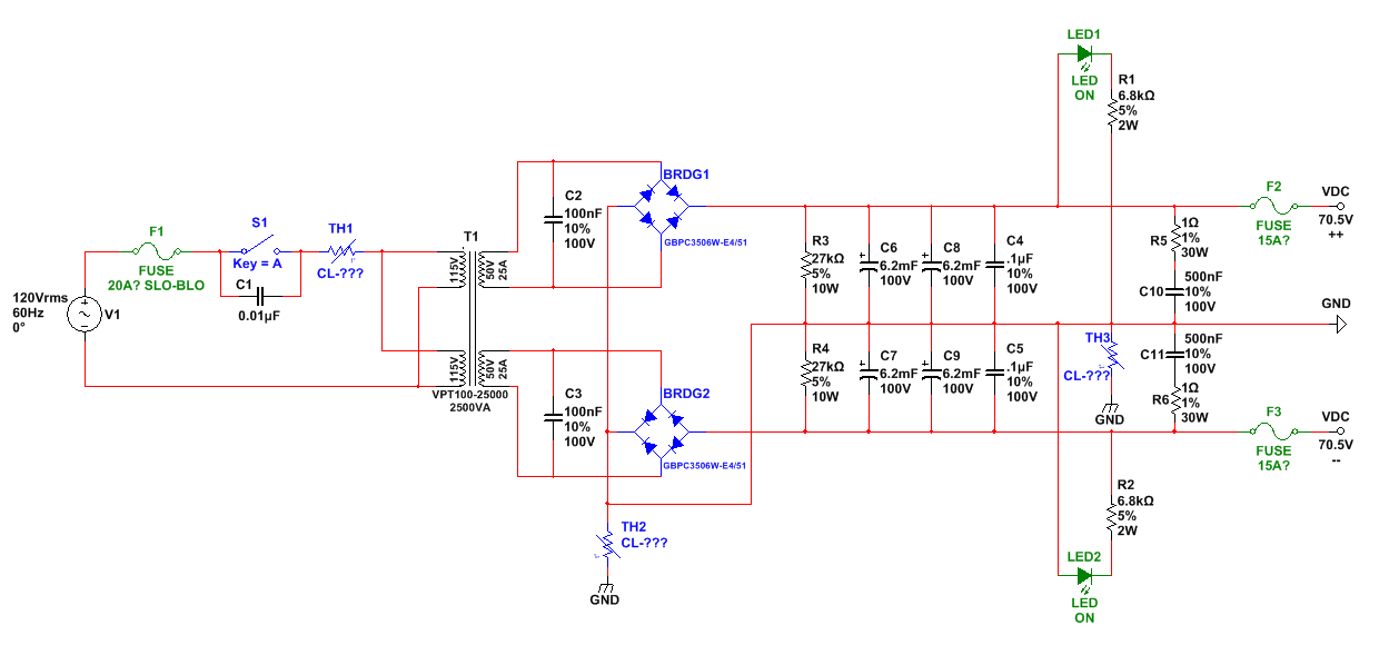

OK please be kind with me, I´m new...
Here's my first take for the Power Supply I´ll be using 11 pairs per OS channel, all ZM Boards, I have some Toshiba 2SA1986/2SC5358 pairs so I will start with those.
I´ll be using a 2500VA Toroidal and I hope 124mF of filtering per rail are OK, I have a ton of questions but the initials are:
1. The Inrush Current Limiter on the AC Mains, how do I chose an appropriate one for a Transformer this big? The typical CL-XXX series only go to 16A (CL-101) with .5 Ohm resistance but, should I go with something bigger? I have some Anthem brand that are 30A with .3 Ohm resistance and 50A with .5 ohm resistance.
2. I have seen Papa using either CL-40 or RC Parallel network to connect to chassis ground on his Adcom designs so I added that, what´s better? If the Inrush Current limiter is, what value do you suggest?
3. I added only one little snubber 100nF cap per bridge rectifier just as a textbook value but I intend to make improvements later on when I have time to build Mark´s Quasimodo test-jig, anything better you can recommend in the meantime? Is the typical RC network (0.1uF + 1R) in parallel per rectifier diode worth it?
4. I also added 2 symmetrical RC networks at the end for any residual capacitor inductance but again, only used textbook values, are they OK or no need for that?
Thanks in Advance!

Mark, for soft start and a bunch of related goodies, check out:
PCB: low voltage On-Off switch drives AC mains relay \ includes soft start .. H9KPXG

Thanks folks, it’s hard to find any readily available module that’s advertised both for 120V Mains and capable of handling up to a 2.5kVA Transformer, I found this one from another Alex that seems to work using the relay/resistors combination plus a time delay circuit, I think I’ll give it a try!

If you use that PCB from eBay, you'll still need to find a power on/off switch whose contacts are rated to handle a steady state current of 20 amperes (2.5 kVA when AC mains is 120V). That PCB doesn't switch the AC on and off, it merely implements a current limiting resistor + time delay, when an (external) switch first turns on.
I also think it you would find it highly beneficial to study Cornell Dubilier's "Quencharc" product line, and all of their supporting technical information, when dealing with 20 ampere switches. And remove all rings, watches, and metal jewelry before servicing the equipment!

Should work.
... you'll still need to find a power on/off switch whose contacts are rated to handle a steady state current of 20 amperes (2.5 kVA when AC mains is 120V)...
It's the upper limit of plain old toggle switches, but still available off the shelf at affordable prices. And yes, using a spark suppressor/snubber would be a good idea: it reminds me of the old days when people used compressed air to blow away the spark. I don't know what they do nowadays, probably the same trick when dealing with high power.

diyAudio PCB free gerbers "H9KPXG" includes a footprint for a relay whose contacts are rated only 16 amperes, not 20. Sorry about that. On the bright side, you could instruct the PCB fab to deposit double-thick copper (2 ounces), whereas the eBay board is single thick 1 ounce copper only.
