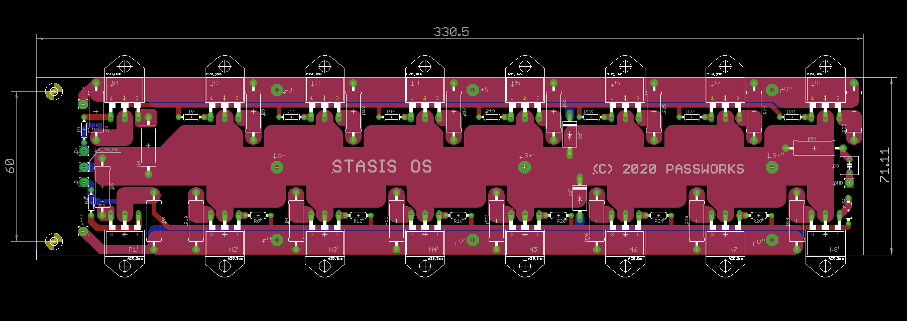

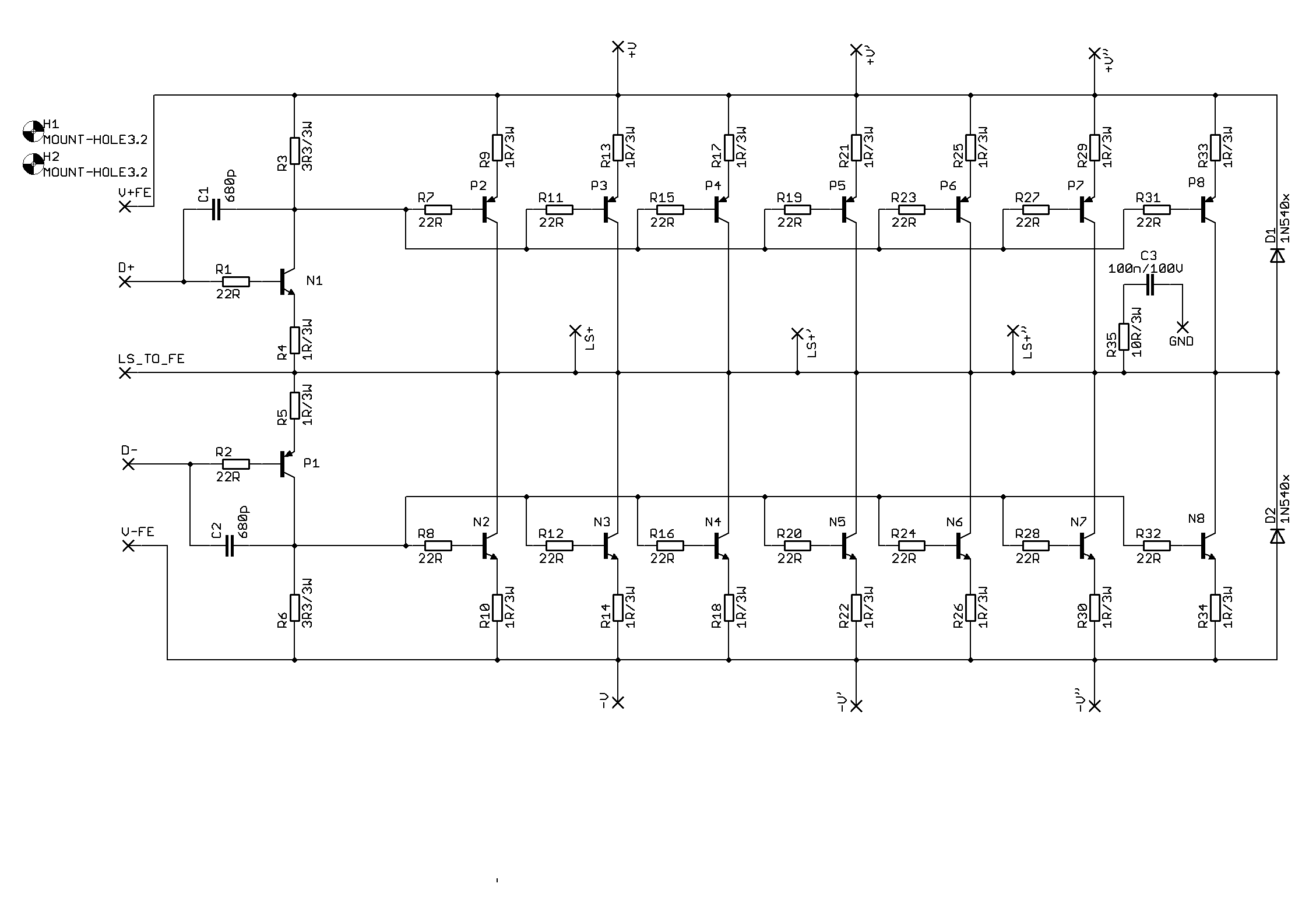

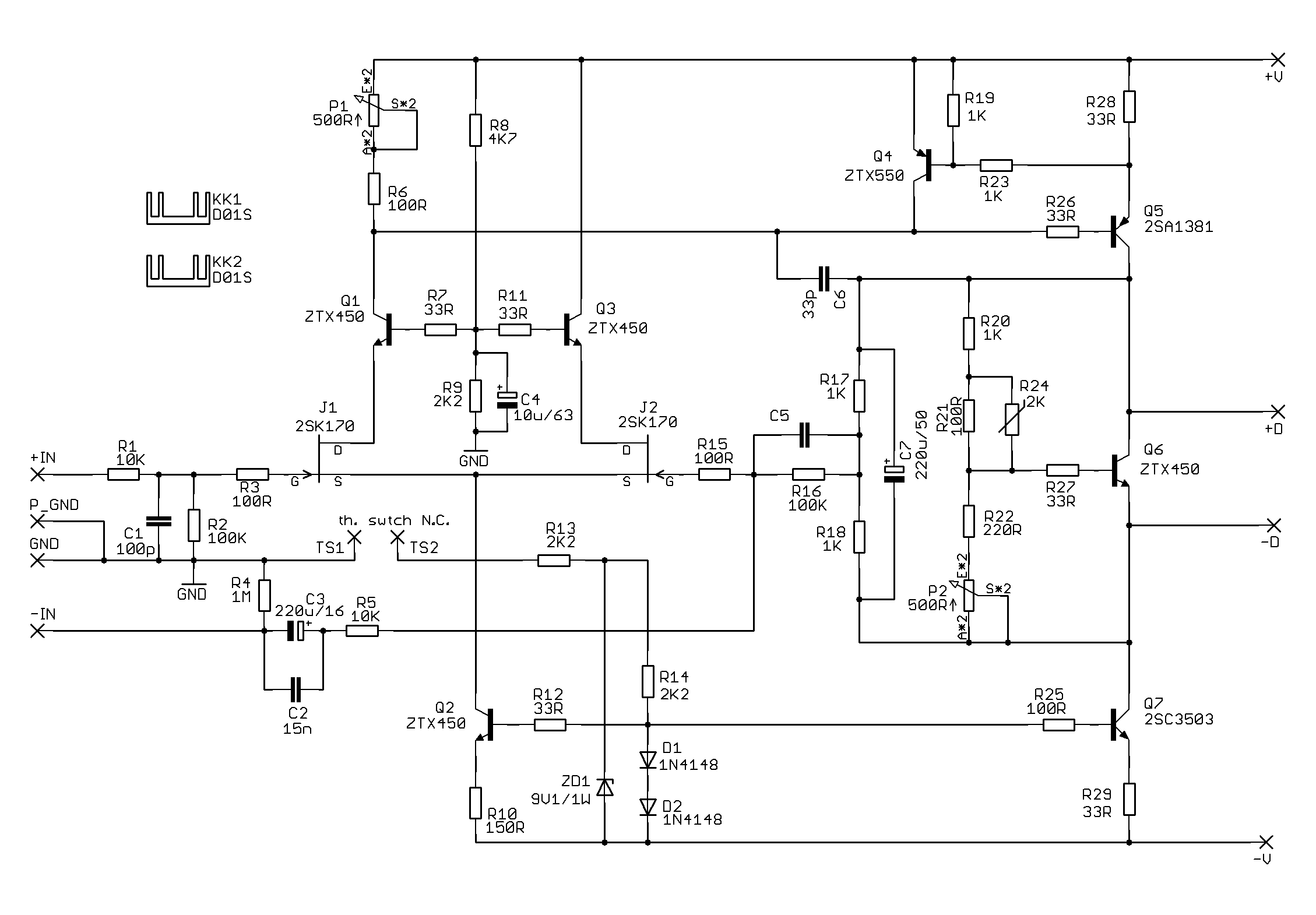

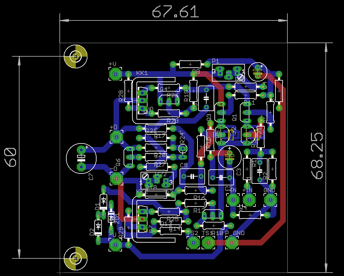

FE + OS pcbs package
OK, wasn't that much alleluia moody, but I know Pa have these days some other things to think of, so here it is ....... maybe some work shaven from his pile
(Pa - remember that scene from War Lover book - two old guys moving load of planks from vehicle to ground ...... and bunch of eager young guys did that for them in 10 mins.... )
anyway , to cut story short, here is first hand of FE pcb made ditto for OS pcbs posted few days ago
mounting of FE to OS with 2 spacers (holes 3.2mm) , all connecting pads aligned
resisted Babelfishing urge, added one cap and few base/gate resistors
shoot me
few minor important changes from Pa's schm (post #1) - no output signal return from OS to FE, thus protection diodes and Boucherot cell are placed on OS pcb; price is small - separate wire from PSU central GND point must be wired to OS pcb
no SMD parts on FE, even if I started with few .... 🙂
I'll optimize everything in next few days, but simple Yay (or Nay) nod could save my day
be well, stay safe, all
edit: oh yes - didn't resisted putting bottom footprint for my fave 2SK2145

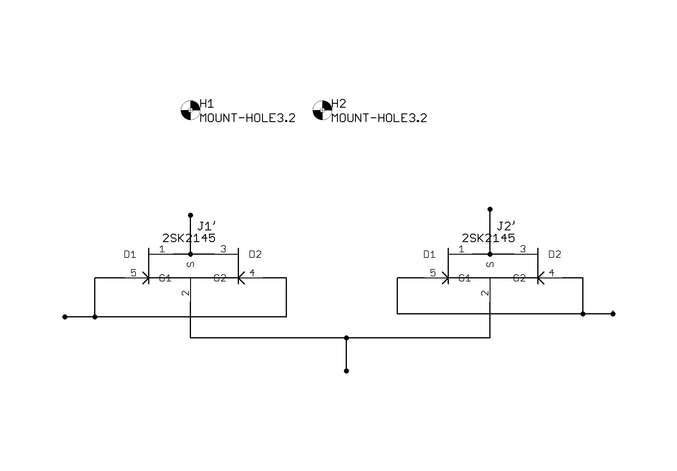

By the way ZM, what Idss grade do you use for your fave 2SK2145?
Now all we need is a sign off on all of this from the ultimate amp guru.
Thanks again ZM, you must have been up early this morning there. Nelson has replied to me that 6 to 8mA Idss will be fine here. I do have some tightly matched 2SK170BL in that range, although Nelson also said matching to 1mA will be fine.
I assume the 2 JFets in the SMD package are already matched to some degree by Toshiba?
This is very cool.
Yes, of course. (they are on the same die)
good enough
and because I'm using them (two) in parallel, effectively as one JFet, matching of two in same case/die is effectively irrelevant
