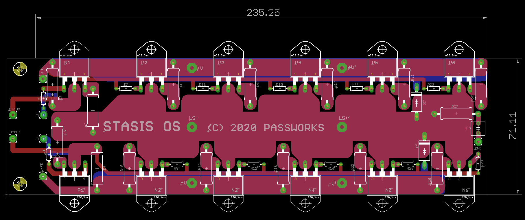

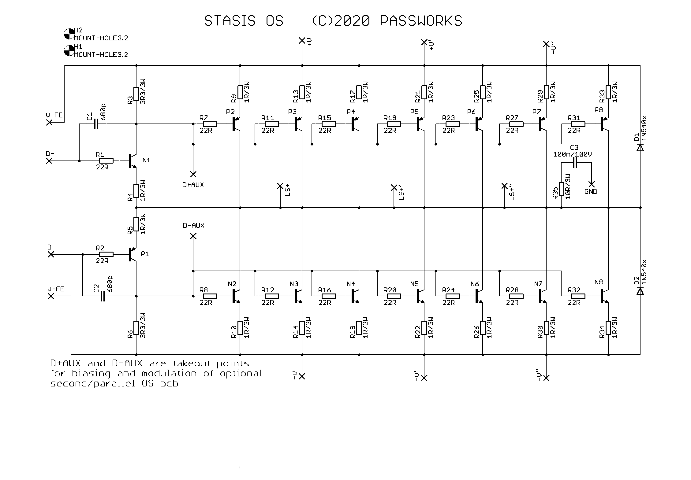

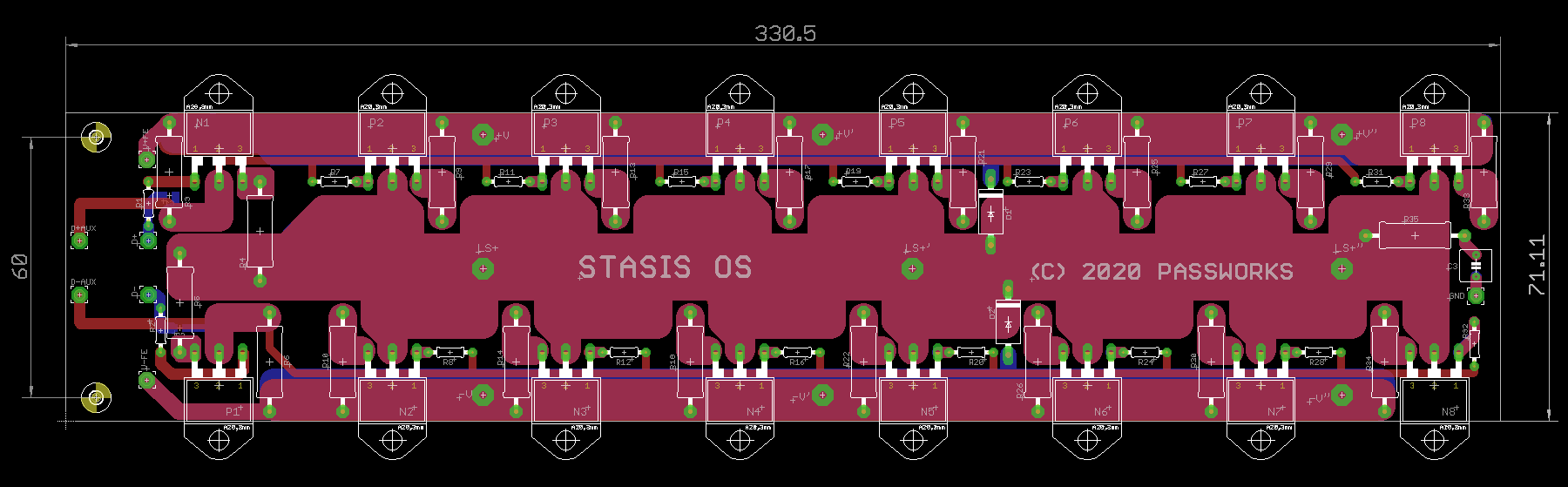

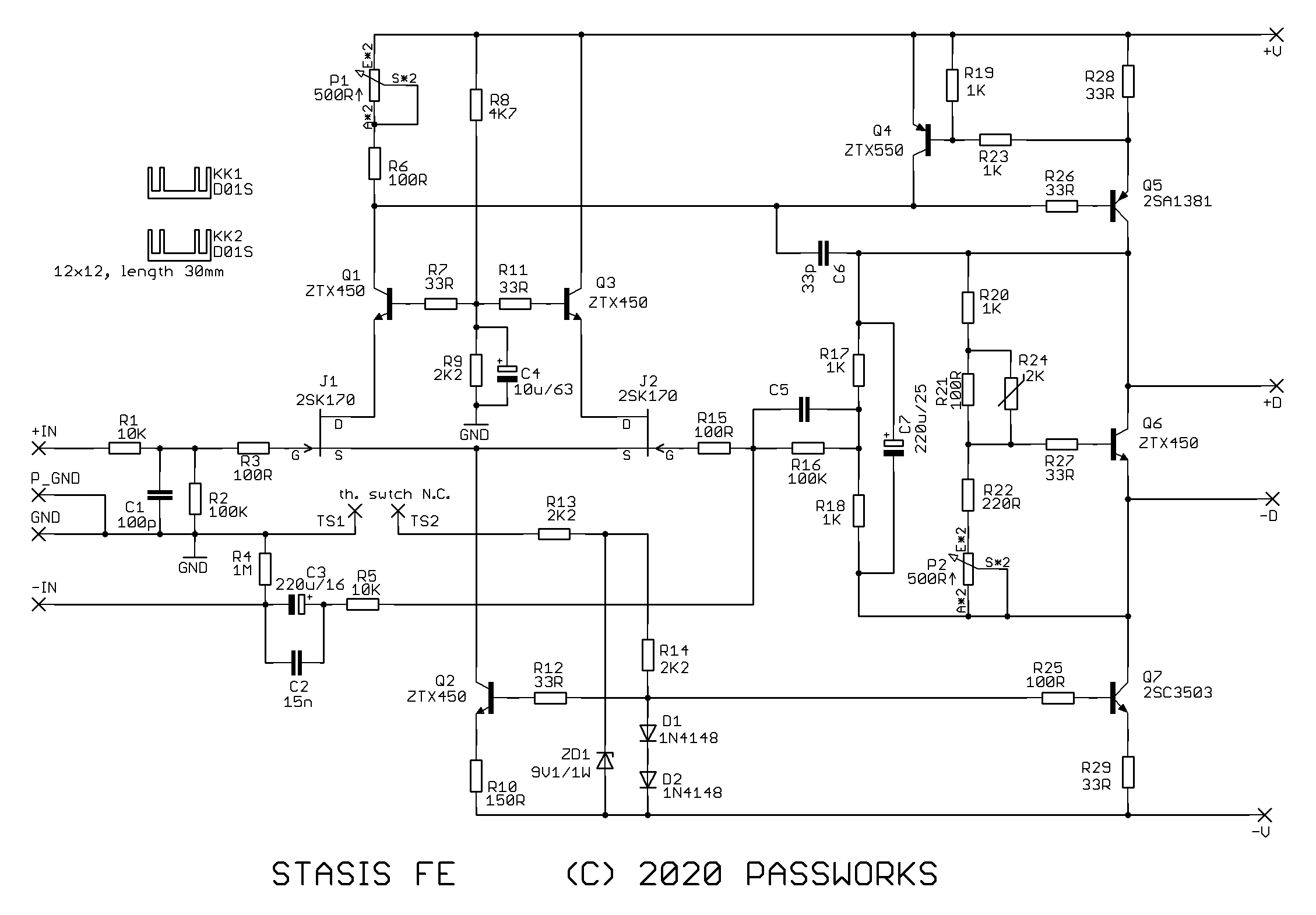

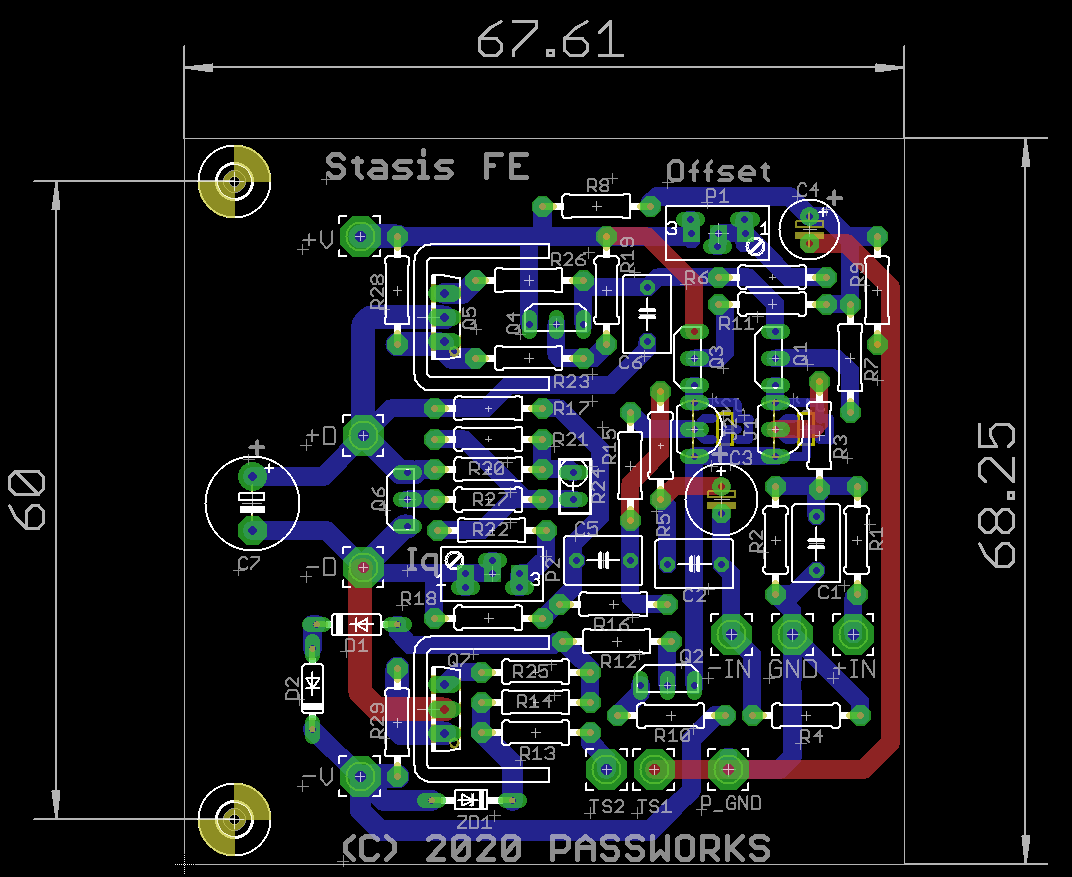

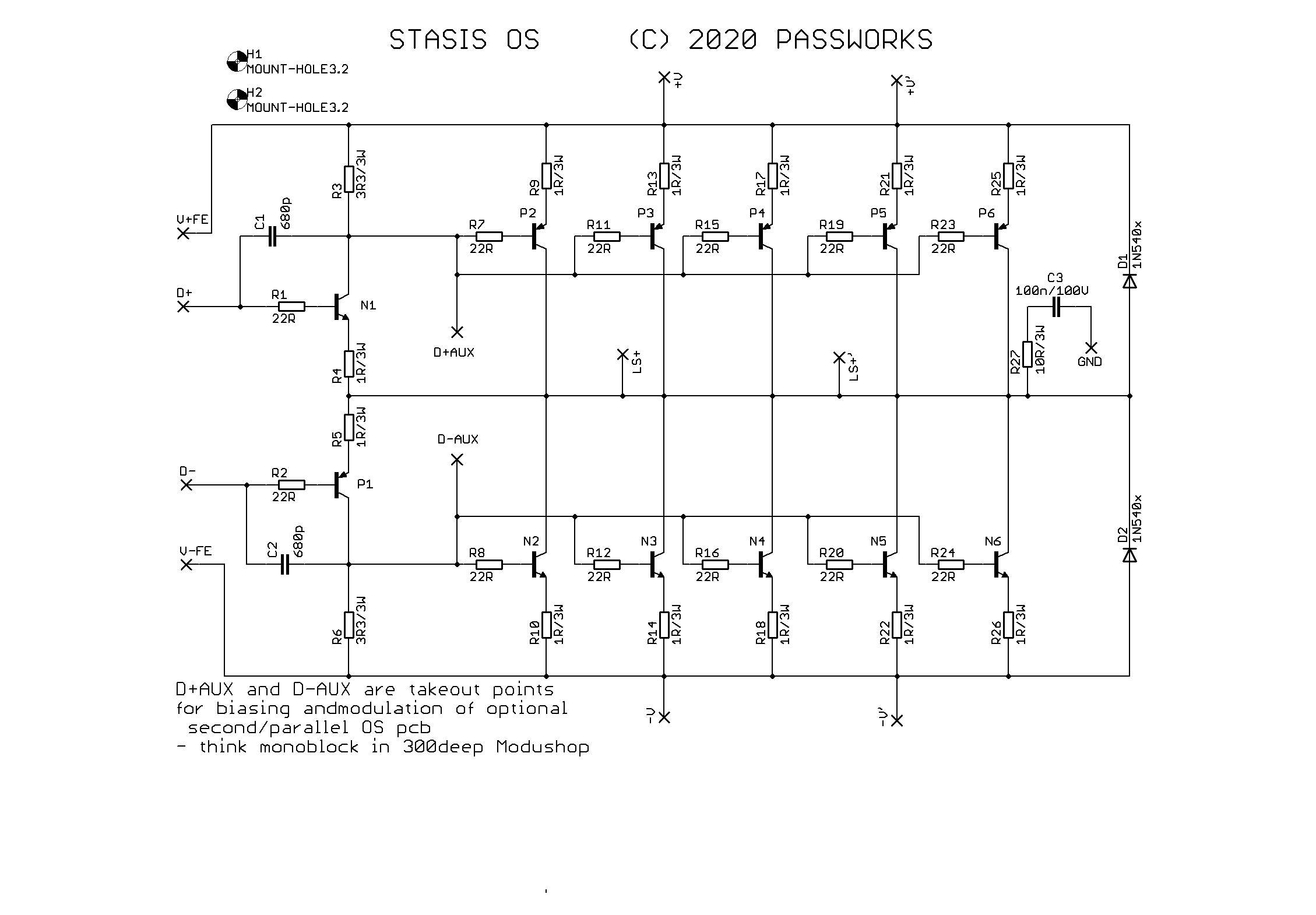

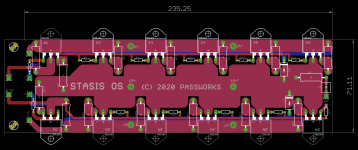

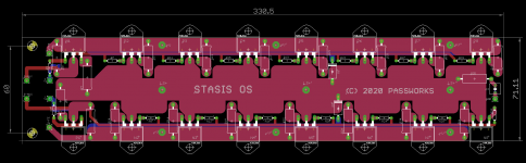

preliminary final files
I've just sent e-mail to Pa, with sch files enclosed, asking for his comments regarding values etc.
Hoping that we'll have his answer soon, here is a set with final files in which, as far as I can see, only some values on schm can be altered
when I have that, I'll post final graphical files and Gerbers, so you Boyz can proceed in organisation
if Pa and Jim thinks that's OK, everything can go to Store, too
Well if one uses say a 10mm board spacer between the 2 boards, then those connections will be 10mm long, using say a piece of tinned copper wire link. When you look at ZM,s 2 layouts the lands for those connections line up with each other. One can use what ever spacer length they like, to make sure the components mounted on the OS pcb have clearance from the FE board.
Sorry, but I chose the original design post # 1 who are much easier to ensemble and sound quality stay the same ,
one or two inches more longer PCB traces or two inches more wire length don't make sonic revolution in my opinion.
Yours choice is different and I respect that 😉 Good luck
They will both work equally as well as each other - so no problems.

Word from Mithrandir
So, got Word from Pa.
it starts with heartwarming "You Silly Boy!!", which I perfectly understand, but then follows a part mentioning bothering and harassing, which really belongs in Higher English, so really out of my reach ..... so let's just skip that
then he sez (let avoid paraphrasing, Higher English again):
"Those all look good to me. Design is not very critical of values - largest values
are usually the safest"
Anyway, I read that as comforting, just need to find some stronger spectacles, there is some small print on end of Word....... for now I can read just few ones, something as "on your own", "bunch of crybabies", "spoon-feeding" .........
But I believe that last paragraph is of no big consequence, so we can proceed .....
