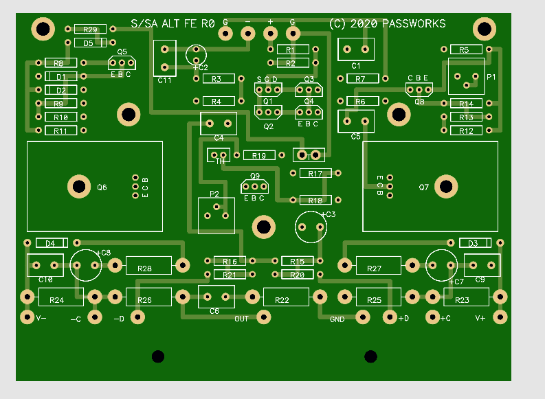

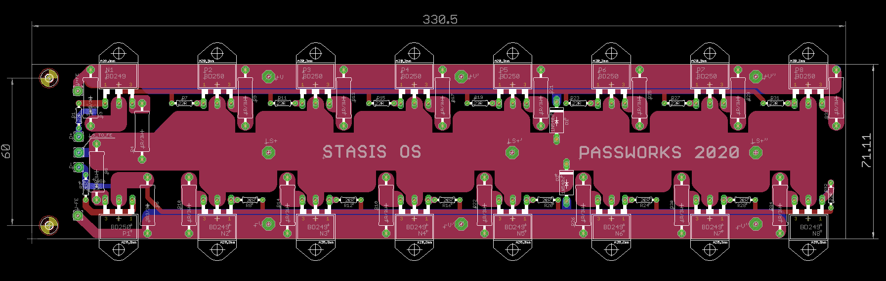

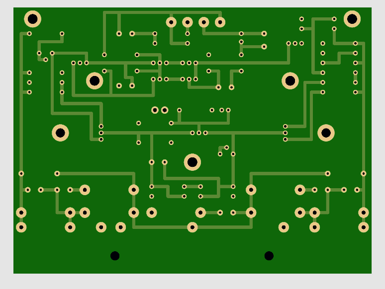

Nice output boards - useful for more than just this project
Just a suggestion - can mounting holes be placed on the OP board to align so that NP's FE board can 'stand off' the OP board? Just an idea...

Mostly speaking of mounting the fe board onto the OP board, as it would be sort of similar to the original. but here I am being rude because it's not my work and it's a nice job gents.

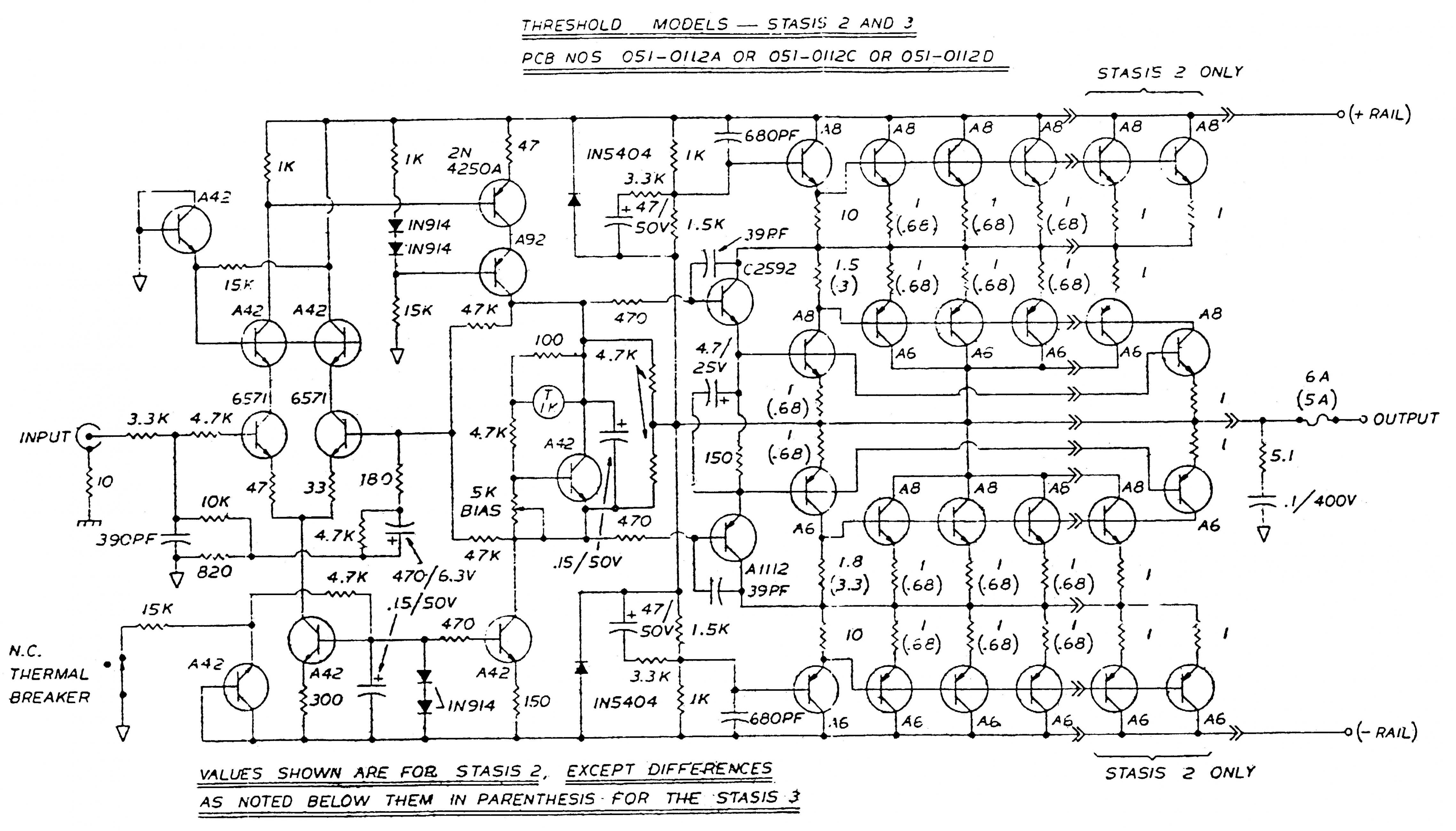

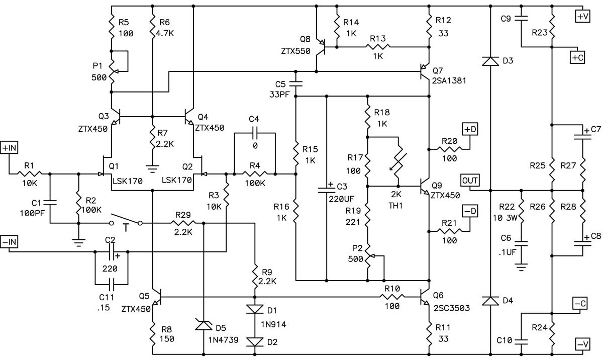

In the new front end what's the function of c9,r23 c7 r25 r28 and c8 r26 r28 c10 r 24 ?
voltage biasing of cascoded (style) of Stasis OS
see enclosed sch, reposted from post #1
also, attached edited sch of new FE, added missing "C" pads (present on pcb), here for same purpose
though, I need Papa's clarification of (reasons for) new time constant, introduced by R27 and R28, in series with C7 and C8, respectively
As can be seen in the photo of the test rig in post #1, and Nelson's email back to me about this, you simply do not load those components for non Cascoded (series) output stages - simple. Which I assume is how most builds will be done by the way. Maybe someone keen will attempt a cascoded O/S build.
