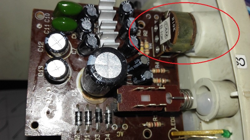

Cannot remove board due to volume contrl
I cannot remove the volume control knob to free the board from the case, any ideas? The rest of the board is loose, removed the hot glue supports to the case. Should I desolder the volume control ?
You can snip it off easily with some little side cutters. Then desolder the legs left over.

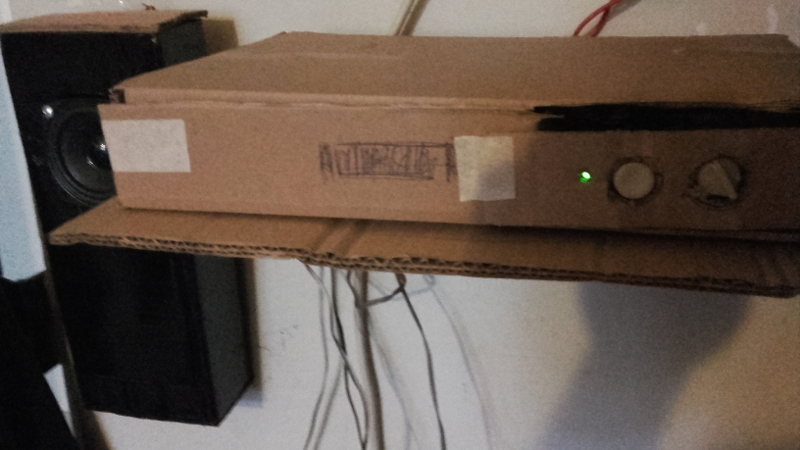

Cardboard Prototype Amplifier completed
Construction

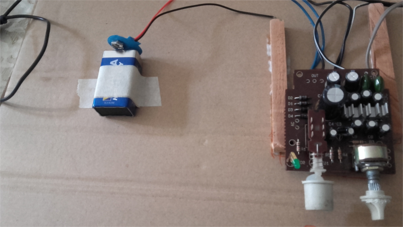

I managed to remove the board and after testing it with a 9 V battery, connected the 9V battery and attached the board to a cardboard enclosure for testing. Cutting out the holes for the knobs proved to be a bit of a task, also constructing the enclosure needed to be better thought of. The thing works off a 9V battery.
Testing
I think the Hi Fi magazine calls it insight. I am hearing sounds I never heard before. Clarity is excellent, and imaging is something I have not heard before. I am setting here and hearing some favourites (70s and 80s pop) as if for the first time. In fact it reminds me of listening on headphones. Some bass would make the sound perfect.
Next Steps
I need to connect an AC-DC adapter, but I remembered just in time that I should put in a fuse, so for a 1 W x 2 amplifier, with the 12 V input to the board, I would expect to put in a 1 amp fuse ?
I also need to construct my hardboard enclosure - anyone want to comment on the fire hazard of such a thing?
