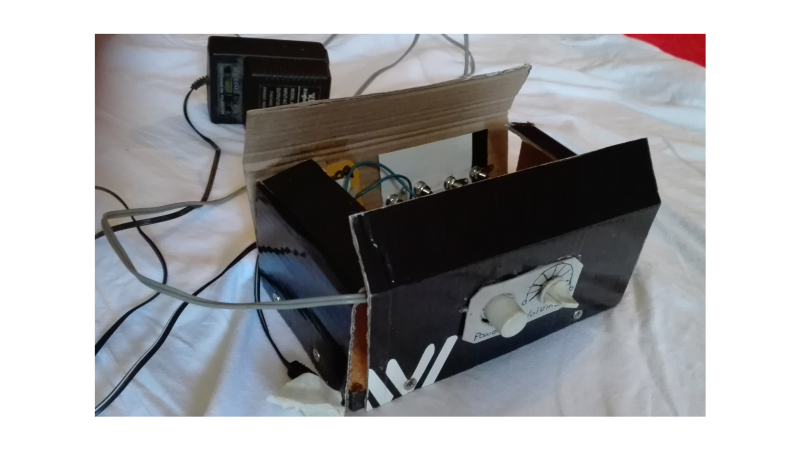

Second Prototype Completed
Fixed the board in an enclosure of cardboard to do a trial on installing and fixing connections : power, speaker outs etc. The function of a prototype is to fail. So here it is.

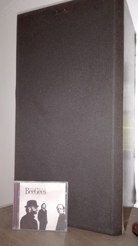

It did not work too well with my full range desktop set up, so I went ahead and connected it to the Sony SS-333 speaker only left speaker to start.
With digital streaming material it sounded good, with the vinyl to CD recording I have the recording sounds a little limited. Overall I was very pleased, and the fact that the ES is a two way with a tweeter really balanced the bass- heaviness of the little amp.
Bottom line is I could listen to this forever.
It was not long ago that I used to gaze at advertisements in Stereo review, wondering when I could buy a $100 amplifier and some speakers.
Well the speakers need to be good, but I am jut amazed that I am listening on an amp that cost virtually nothing, and enjoying music so much. I really pleased with this more than the Lepai- type I purchased for around $30 a year back.
I took about 5 minutes to sit down and contemplate the journey that has led me to almost where I want to be. All that wasted time.
Next is to complete my 2 way speakers that I can set at ear level.

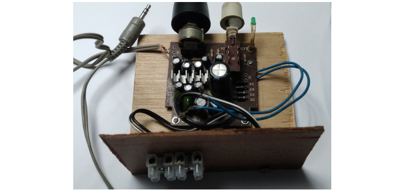

Update : new case
Update: TEA 2025 board mounted on to a new base. Sounds great with my desktop open baffle, and the rear speaker connector type is much more convenient and easy to use than the ones I had earlier.

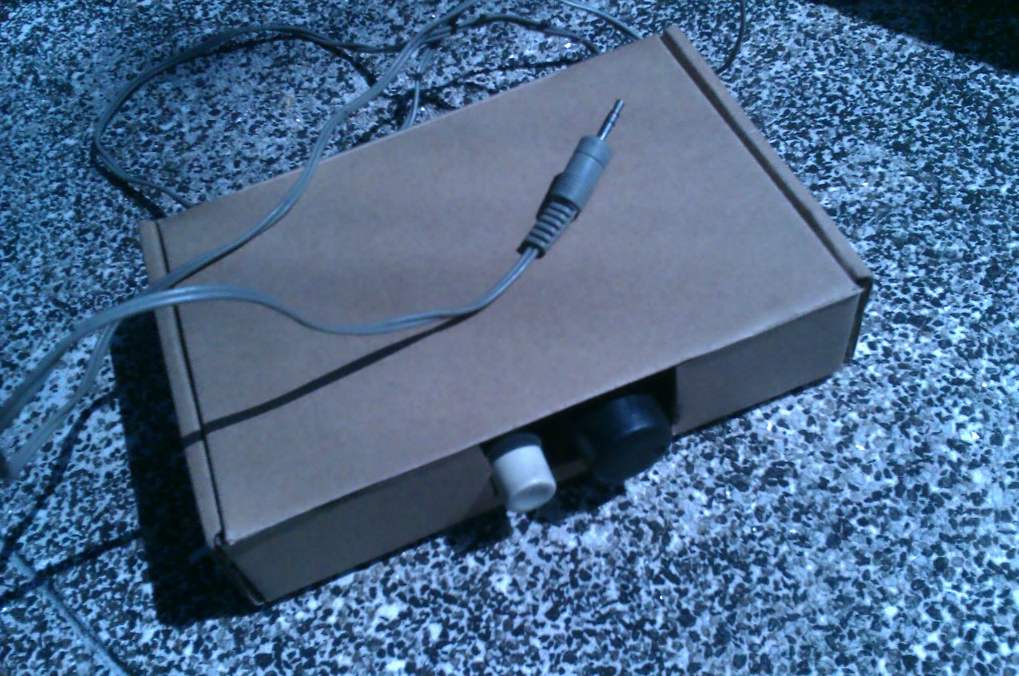

Cardboard enclosure...
I finally caved in and found a good cardboard box that my replacement computer adapter came in, and in 45 minutes or so had cut the holes and installed most of the wires required to make this a reality. I added the rubber supports today, and finished up the wiring.
Lessons learned:
1. Obtain a professionally made box or get the box sides cut out professionally and correctly
2. Quickly and neatly drill out the holes and openings required - have the tools and techniques available beforehand.

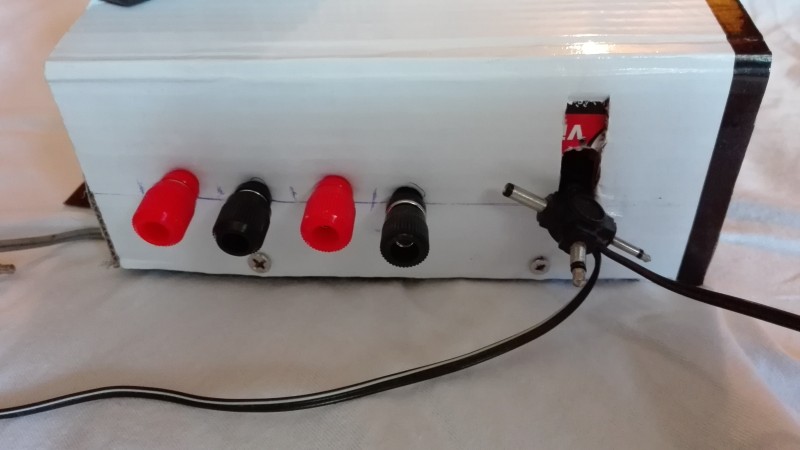

The latest prototype. I know it has taken years, but at last a presentable enclosure for the TEA 2025. The case is made out of cardboard, from a box, hardboard or metal would have been more suitable and not too difficult to construct, however the latter two materials are not available to me right now, nor the tools to work on them. The corrugated cardboard box is covered with vinyl sticker paper of light wood finish.
I am very pleased with the finish of the case, fireproofing concerns and long term durability will be a concern.
