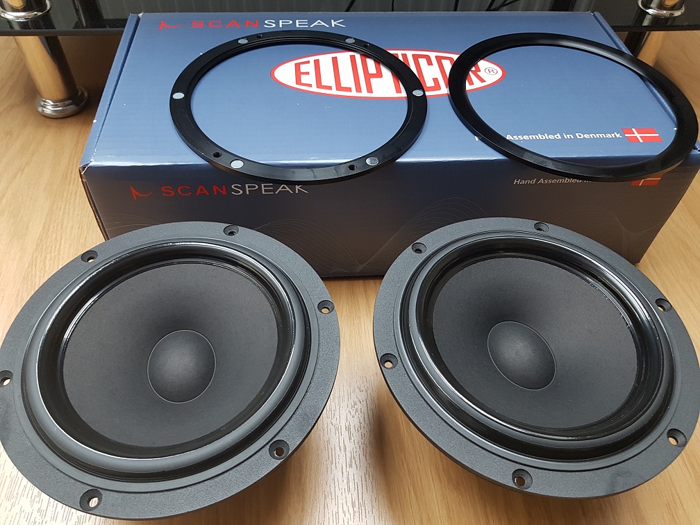

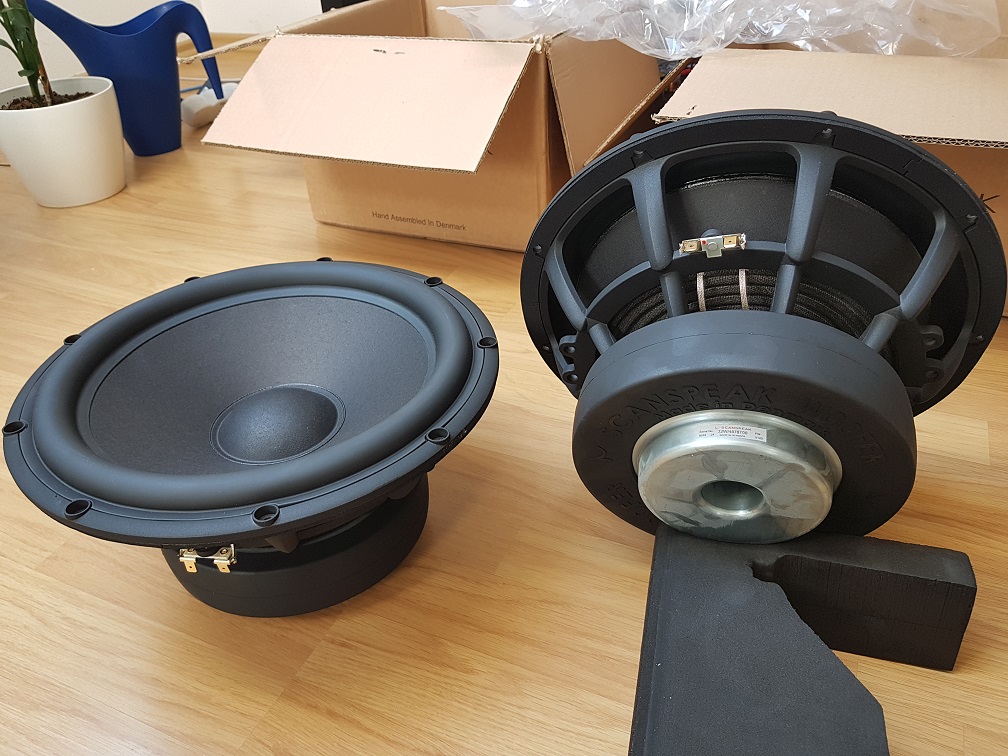

New project: Bliesma T34B in WG, 18WE, 32W
Woofers arrived. It is pleasure to see perfect Scan Speak quality, no excessive glue, consistent centering and gaps,...

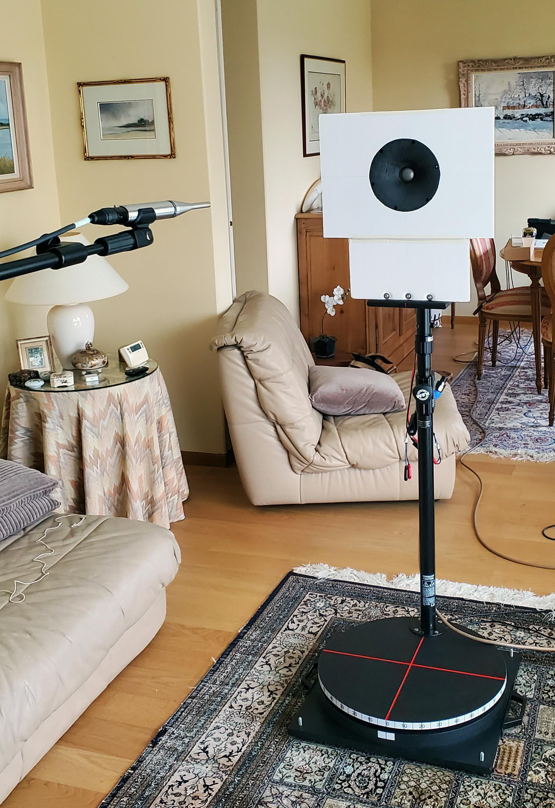

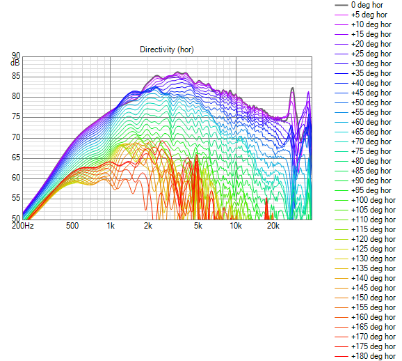

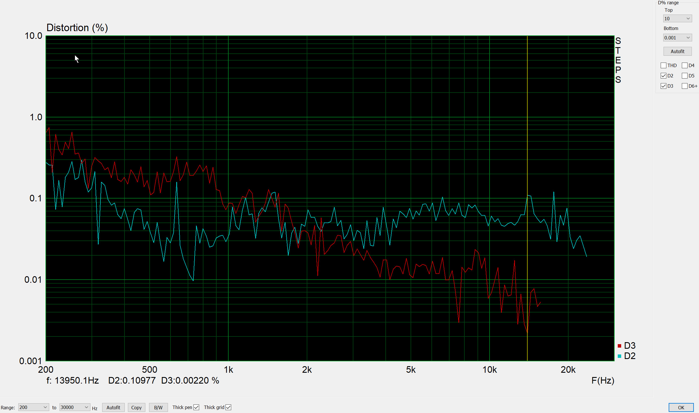

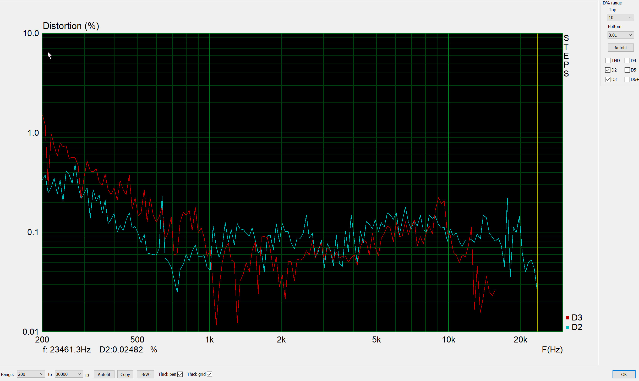

I had the opportunity to test "Pida" waveguide with my Bliesma T34B and in short I find it very impressive. The combo of a proper OSWG perfectly fit to the already remarkable driver from Bliesma is, imo, a winner.
Of course it comes at a price but I think it is well worth it. On pictures below, if you omit the artifacts from my very quick and dirty setup at about 1.5kHz and 2.5kHz I was able to get in a manner of minutes quite a nice result (LR4 1.5kHz cutoff freq). Notice the very low distortion as well.
Well done Petr !
Jean Claude

Yes fully calibrated at 94 dB.
I use this relatively level for two reasons:
- very bad support gear (cardboard)
- bad 3Dprint with low infill
The results were so good to me that I have ordered a pair of better quality at i.materialize and I will build a better test gear to further investigate

As I don't want to hijack Pida's thread to much, here is the link for the measurement table
Polar measurements with automatic turntable
Be aware that the original motor used in this project is not available any more and the one suggested for replacement doesn't work very well with the original hardware interface that you can still buy. In fact interface has problem to read the properly the Polulu encoder ! No solution provided yet.
