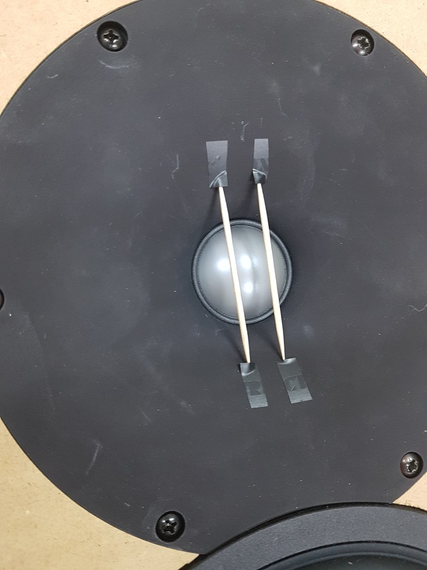

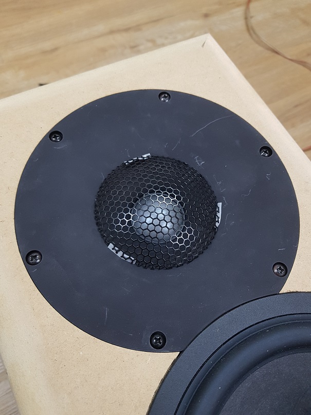

Measurement of some protection elements of Bliesma done today. As I was not able to safely fix the toothpicks and grid to the waveguide, I did measurement on the loudspeaker on the floor. I did not bother with damping material around the speaker, which would remove some reflection....
Ok, the results..... 2 toothpicks seem to have very little efect around and above 20kHz. Original Bliesma grid did not hold on the place due to strong bliesma magnet, I had to use double sided sticky tape, and here we can see it caused small irregularities around 12kHz and above 20kHz. In both cases, I think the sticky tape protruding from the waveguide surface caused more problems than toothpicks and grid themselves.
For now, I incline to using of the grid. To fix it properly to waveguide, I would make 1mm circular groove and sit waveguide into it.
Hmm, I think I will experiment more with the grid, and fix the tape better.

Maybe, off axis measurements with grill before final decision should be done. The distance between the dome and the grid in the waveguide is greater then in original Bliesma position so I'm wondering if it will have an impact

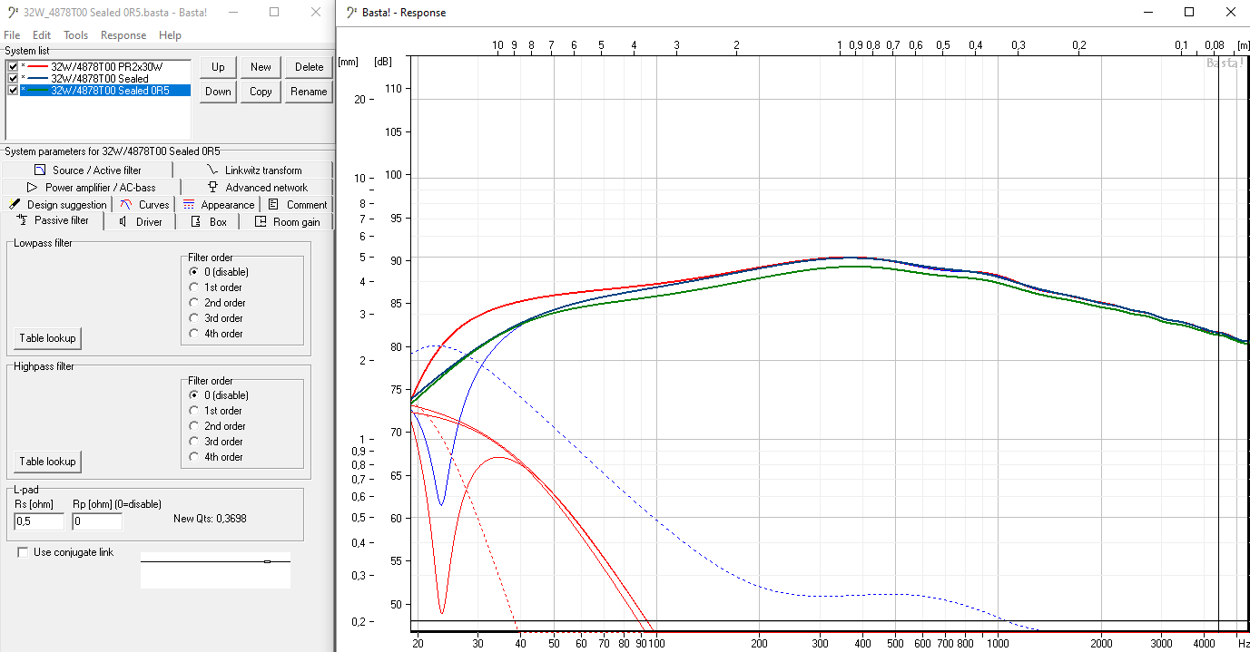

I attached 32W simulation, comparison of sealed, sealed with 0R5, and pasive radiators, both in 75l. Pasive radiator system with 2x30W scan speak PR per cabinet, system tuned to 20Hz. Simulation contains baffle step.

Pida
Calculating the PR response with my calculators shows that an enclosure volume of 75 L is too low for a flat low frequency response. The response is boosting. For a PR system with the 32W, a cabinet volume of 120 L is required.
Using two PR Scanspeak 30W, the mass on each PR has to be 400 g for a tuning at 20 Hz. That is a lot and not so ideal IMO.
A more interesting result ban be realized using 2x 10 inch Dayton DS270. They have a lower Vas than the 30W, a more stiff suspension. In 120 L a tuning frequency of 24 Hz can be realized with 200 g on each PR. That is more realistic.
Just to check. For 2 PR in the same cabinet, Vas and Sd have the double value.
For the same PR system in the same volume with 2 PR instead of 1 PR, double the mass for each PR is needed.
I use the VituixCAD Enclosure tool and the R.Small PR formulas for my calculations. Both almost have the same results. The VituixCAD Enclosure Tool works excellent and is very accurate.

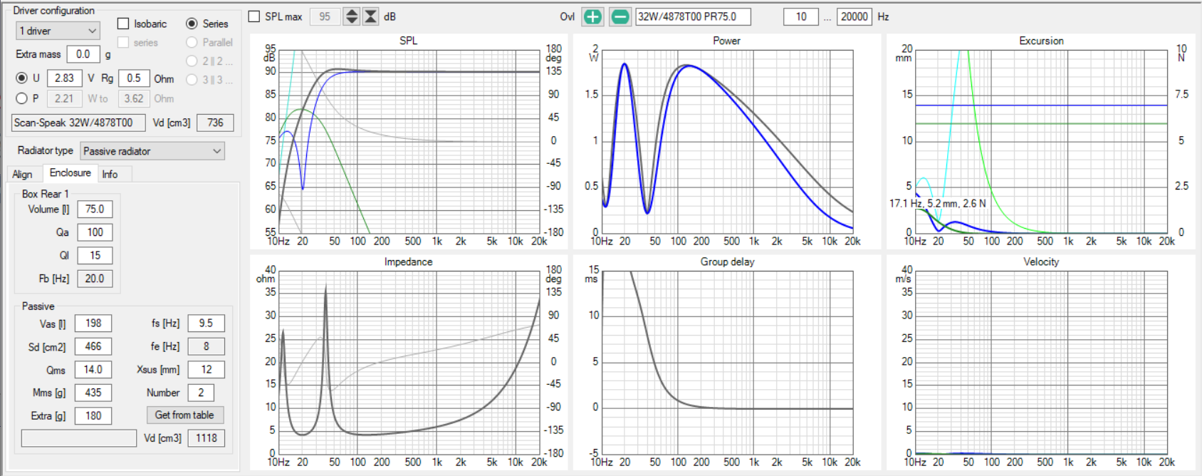

Paul, I tried 32W with 2x30W passive in 75l tuned to 20Hz in Vituix, see attachment. 30W has Mms 435g, and for two of them in 75l and 20Hz tuning I have to add ~90g to each. I am not sure I see any boosting.
I checked your files, thank you for them.
Is there any negative aspect of using passive radiators with Mms 435g and additional weight ~100g?
Generally I am not after the lowest possible extension with that driver and also like more reasonable cabinet volume. I chose this driver based on experience with 28W and other scan speak drivers. I also listened to Xavian Opus Magnum, using 8ohm version in 80l with 2x30W passive.

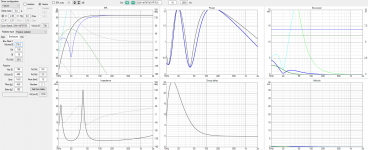

Pida
We used different settings in VituixCAD Enclosure.
I had chosen Rg = 0.5 E, and I did use other values for Qa and QL.
(I didn't see before that the number of PR's can be defined also, that is nice).
With Rg = 0.5 E, Qa = 100 and QL = 15, there is a boost of 1 dB at low frequencies, see attach.
With Rg = 0 E, like in your simulation, there is indeed no boost.
You add 180 g extra to the PR in your simulation. I understand that it is extra for each PR? Then the total moving mass is 435g + 180g = 615 g. That is a lot, but maybe that PR can handle that. If the minimum Mms is already 435 g and you can add extra weigth, I expect 180 g extra is no problem.
My last VituixCAD file again attached.
I assume Rg can represent Rdc of the coil. I checked and it seems better to keep Rg~0.3ohm, and cabinet volume 85liters, with that the boosting is minimized. I am still not decided whether to go closed and PR in pasive crossover version, there is plenty of time to decide that anyway, and I will listen to active version before that anyway.
Yes, I have taken 0.5 E for the serial coil(s) Rdc. Rg = 0.3 E and Vb = 85 L seems to be ok.
With some dampening material inside the cabinet, Qa and QL become lower also. Qa = 20 and QL = 7 are more realistic values for a system with some filling in the cabinet.
To know it all more accurately, you need the measurements.
