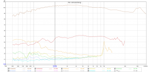

Distortion measurement of T34B in WG, mic distance 50cm, 1.41V (already very loud with that tweeter).
Fantastic project!
What SPL does that come to, and what would the peak SPL be without distortion crossing a reasonable number say -35 or -40db?
Bliesma only or whole loudspeaker?
Blisma only, in WG, I think 110dB is quite conservative estimate. Considering you mean THD ~-40dB. 32W in closed box will run out of excursion limit at 20Hz at around 107dB, half space, one loudspeaker, no EQ.

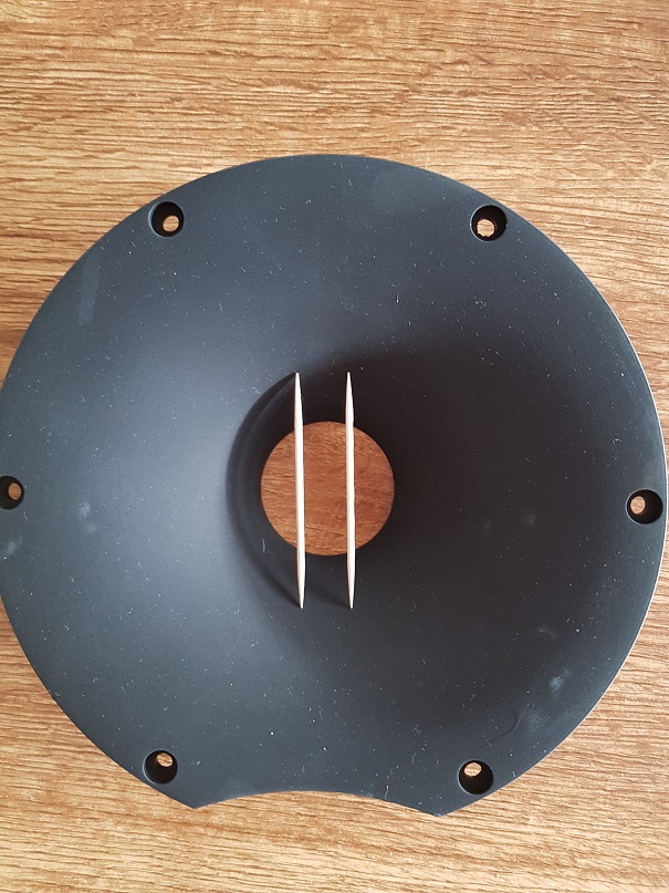

- hopefully this week I would like to measure the impact of some protective elements for bliesma (I will use two toothpicks for the beginning)

It will be interesting to see if / how the toothpicks change the acoustics of the tweeter / waveguide. Looking forward to a comparison between no / one / two toothpicks 🙂
I am hoping toothpicks will have almost zero effect, but.....
It is probably safer to keep those protective elements further from the dome. Another aspect is, they should have the surface area as small as possible, and not flat, so it doesnt reflects energy back to the dome.
Don't be afraid of that.
Wavelength of a 20 kHz tone is 17 mm......
Sometimes you guys see ghosts where there aren't any 😱
