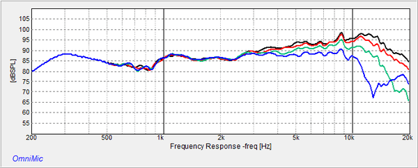

I am using the GRS PT6825-8 8", the wide version, not the skinny version which starts to diverge off axis @4kHz and peak and roll off at 10-12kHz.
I am crossing over to the ribbon before the midrange's off-axis plots start to diverge significantly.

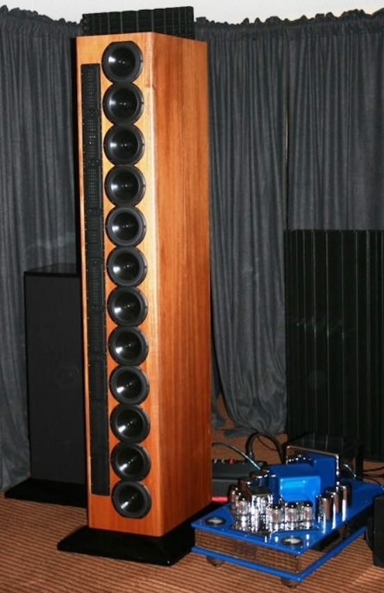

That looks nice! But I did not do the accounting but this could be rather costly if you make this 2 meters high? So cost is one of the reasons 🙂
You don't have to make a 2 meter version, you could get inspiration from this thread: https://www.audiocircle.com/index.php?topic=159717.0
and the image comes from this video - they are called the GR Research Line force:
The reason I recommend using both is a much better and wider dispersion, using only the 8" or 10" will produce to much beaming, like a needle, above 10kHz and that is not pleasing.

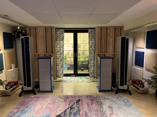

I second looking at the LineForce threads for ideas. Also, take a look at the Mockingbird LSX Line array, another of Danny's designs using both cones and NEO8's. There is more than one thread on the LineForce including a very recent build in the break-in stages. HAL on that forum made a tall pair by using NEO 10's and a different brand of ribbons using digital XO's.
If you plan on making a tall version, spend a bit of time designing a rigid baffle. Danny's design uses a deep wing on the midrange side which adds rigidity to the front baffle. My baffle is fairly rigid, but I decided (after testing with steel bases) I am going to add struts in the back similar to the MyeStands to prevent sway because they are so narrow and tall. The baffle is 86" tall above the base stand to center the drivers vertically on an 8' ceiling.
Mockingbird LSX:
Hal's Megalith (NEO10 and Ribbons):

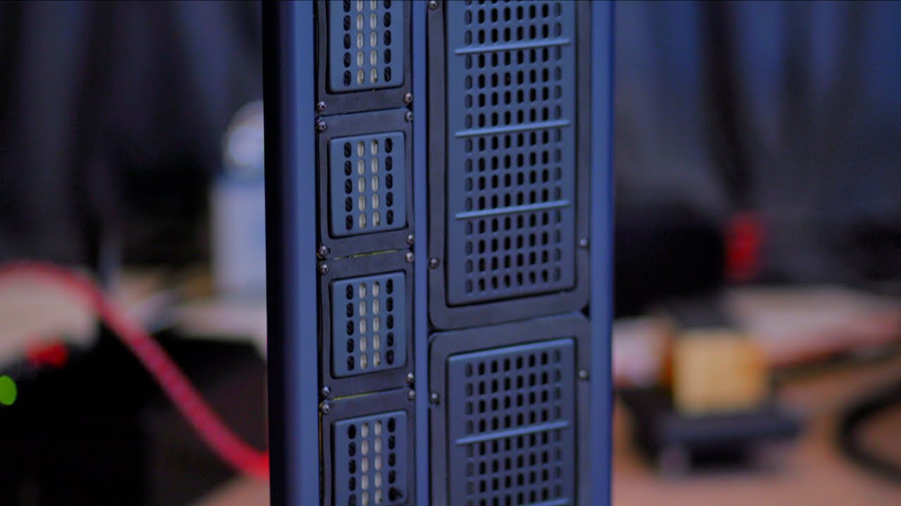

Found an interesting comment on one of Joppe's videos where he dissects a B&G Neo 8.

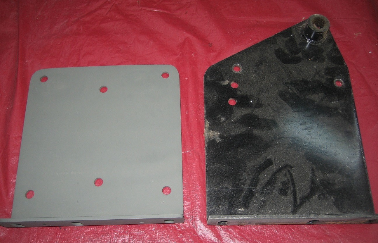

Some minor updates.

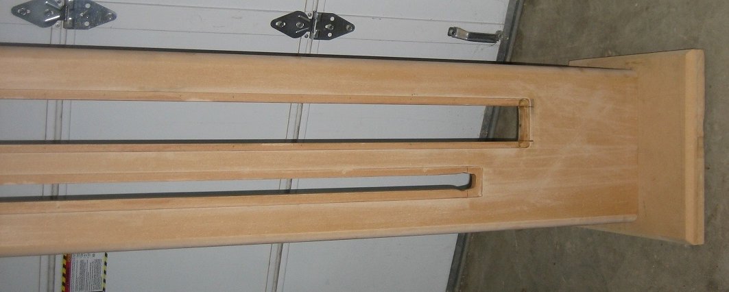

When we replaced our old single-panel wood garage doors, I saved the old steel mounting hardware assuming the scrap metal would have a second life in the shop sooner or later. Well, it is later and it won't be the shop.
These are 3/16" inch thick plates that will bolt to the bottom back of the baffles and pedastal feet. I welded the original bolt pattern shut, cut to size (tried Diablo's new Steel Demon blades which worked surprisingly well) and then drilled new bolt patterns for the narrow baffles with threaded metal inserts.
I will be using wood pedestal feet, but could weld on steel feet in the future if desired. Either will have leveling spike options.
(left gray is the modified and primed bracket, right black is the original scrap minus the hinges and angle iron).

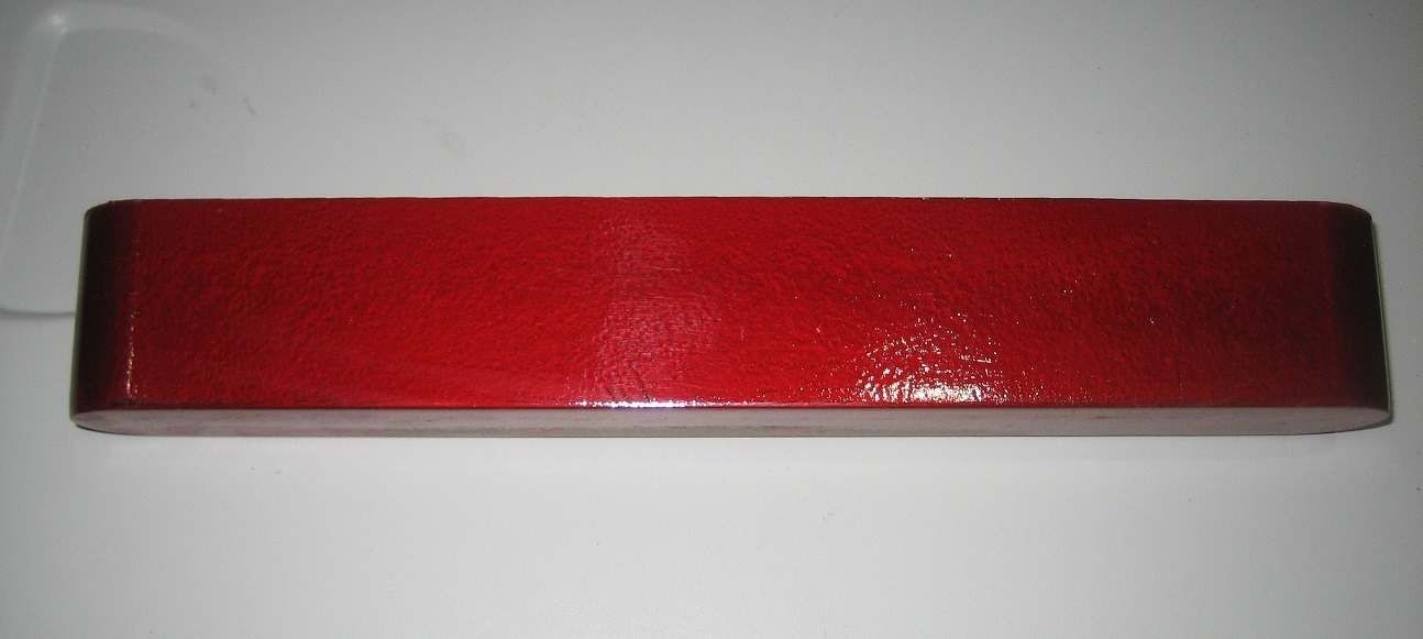

I am not a spray painter (other than house & fence paint). I have been playing around with paint options and am leaning towards an analyzed red over metallic silver to contrast the black drivers. Here is a sample sealed MDF cut off using Rustoleum's hammered silver as an undercoat and Duplicolor's Metalcast Anodized Red translucent top coat. No clear coat yet, but considering a 2K variant with hardener.
I have discovered various paints don't play well together and lift the undercoats. Also discovered that paint prices are fluctuating widely, currently North of sanity.
Once the paint is on and dried, I am ready to mount and wire the drivers.

Some of the newer professional paints are pretty nasty from a health standpoint. This is mostly referencing your 2k with hardener comment. Depending on what and where you are painting, a disposable respirator of the appropriate type may be in order at a minimum. And that "of the appropriate type" is important - you're dealing with a chemical hazard, not just particulates.I am not a spray painter (other than house & fence paint) . . . . considering a 2K variant with hardener.
As a hobbyist, I'd stick with paints you can get at typical retail outlets, and stay away from anything with a terrifying SDS.
I have seen the recommendations online about proper ventilation and filtration with 2K paints/clears. I have shop fans, cross ventilation and a fairly descent mask with dual screw on filters. I will probably setup a vented/filtered paint tent to control the dust. The 2K clears are also supposed to be much better finishes than the 1-part clears but have a very short shelf life once mixed.Some of the newer professional paints are pretty nasty from a health standpoint. This is mostly referencing your 2k with hardener comment. Depending on what and where you are painting, a disposable respirator of the appropriate type may be in order at a minimum. And that "of the appropriate type" is important - you're dealing with a chemical hazard, not just particulates.
