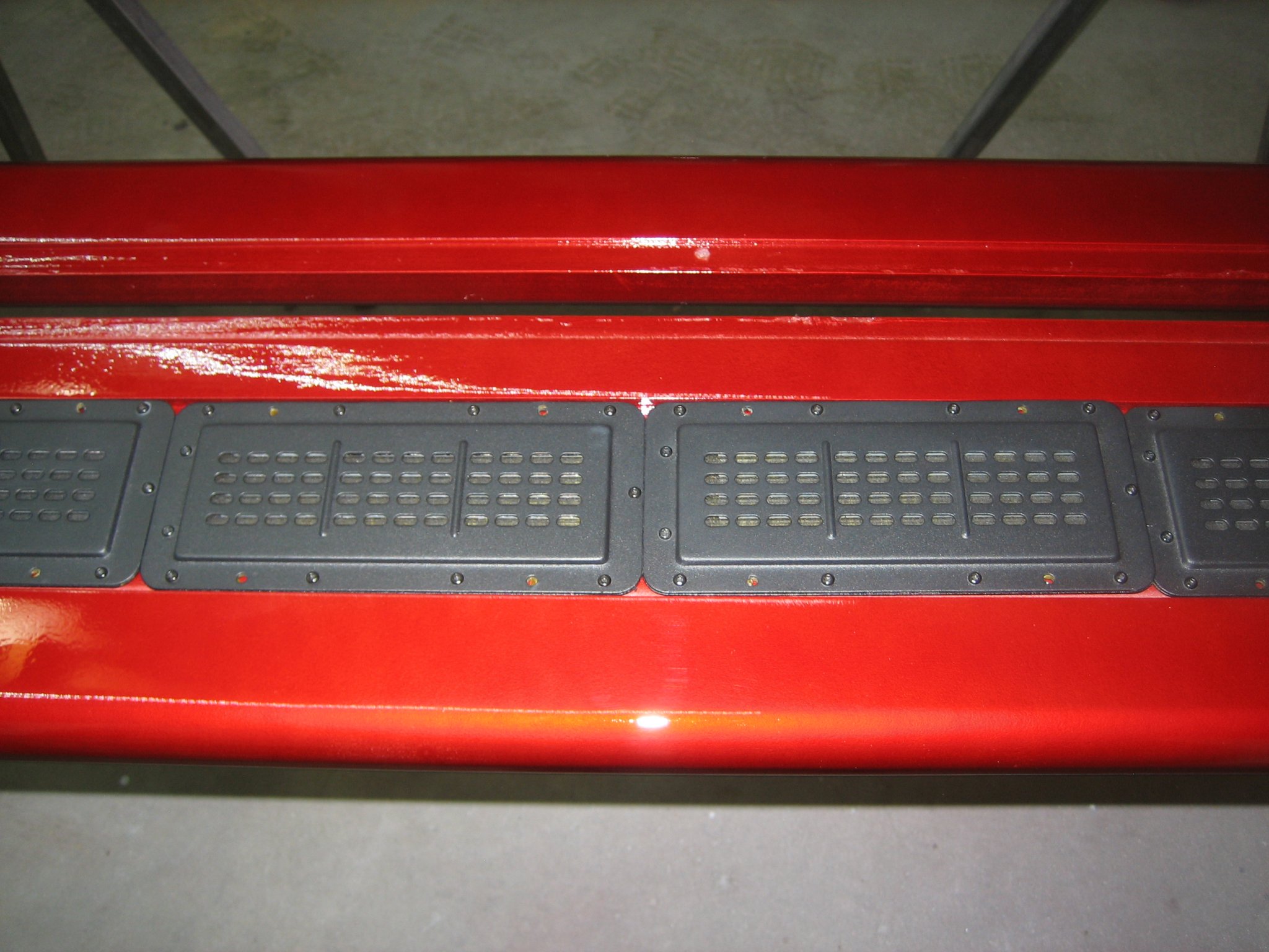

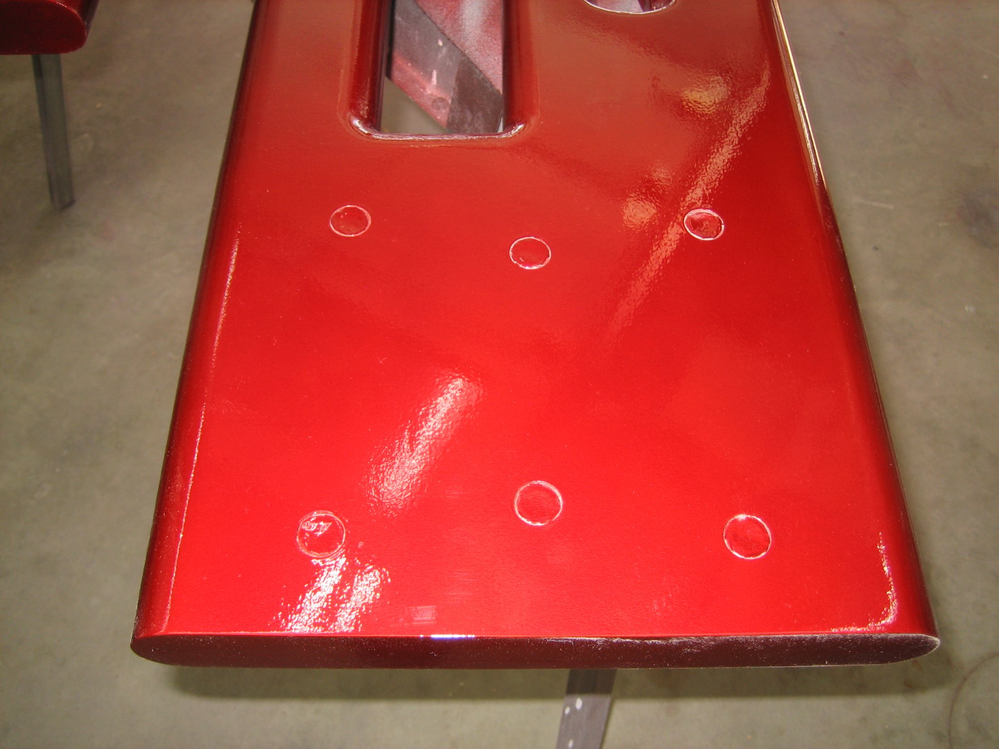

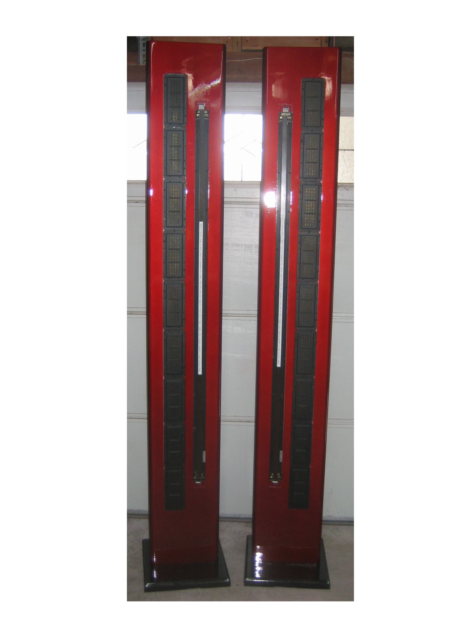

Another update before wet sand, polish and assembling.
The circles are painter's tape covers over the threaded insert holes.
This is the first time I have tried this so it is a learning/experimental curve. I had to experiment with different paints to find a combination that didn't lift/crinkle each other. Not able to buy lacquer paint which would have made things much faster and easier and vastly better drying times. I discovered that even different types of Rustoleum do not play well together.
Layers:
Layers:
- Minwax Polycrylic to seal the porous MDF
- Gray Rustoleum sanding primer
- Silver Rustoleum Hammered base color (Hammered holds the red top color much better than the Rustoleum Mirror)
- DupliColor Metalcast Anodized Translucent Red top color
- 2K Gloss Clear top coat (supposedly harder finish with better UV protection to prevent oxidation)

Last coat of clear is finally on the fonts. Time to set and wire the drivers.
And another update.
The white strips on the ribbons are their protective strips that get removed before playing.
The space above and below the ribbons are for filler pieces to cover up the wiring.
Standing upright starts interacting with the garage door opener trolley.
I would have said Mazda red. One of the best automotive paints out there.

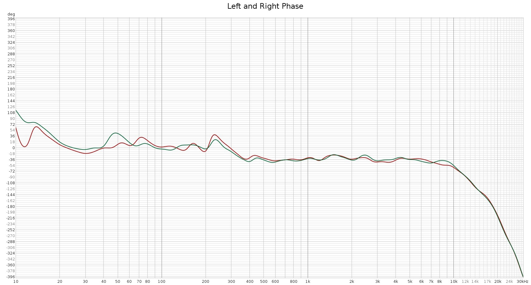

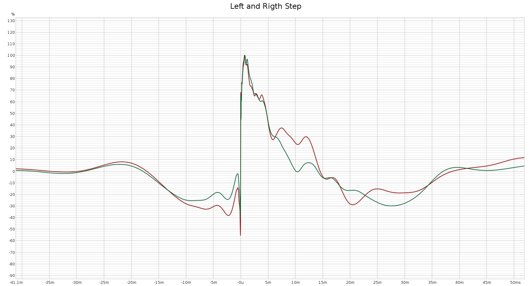

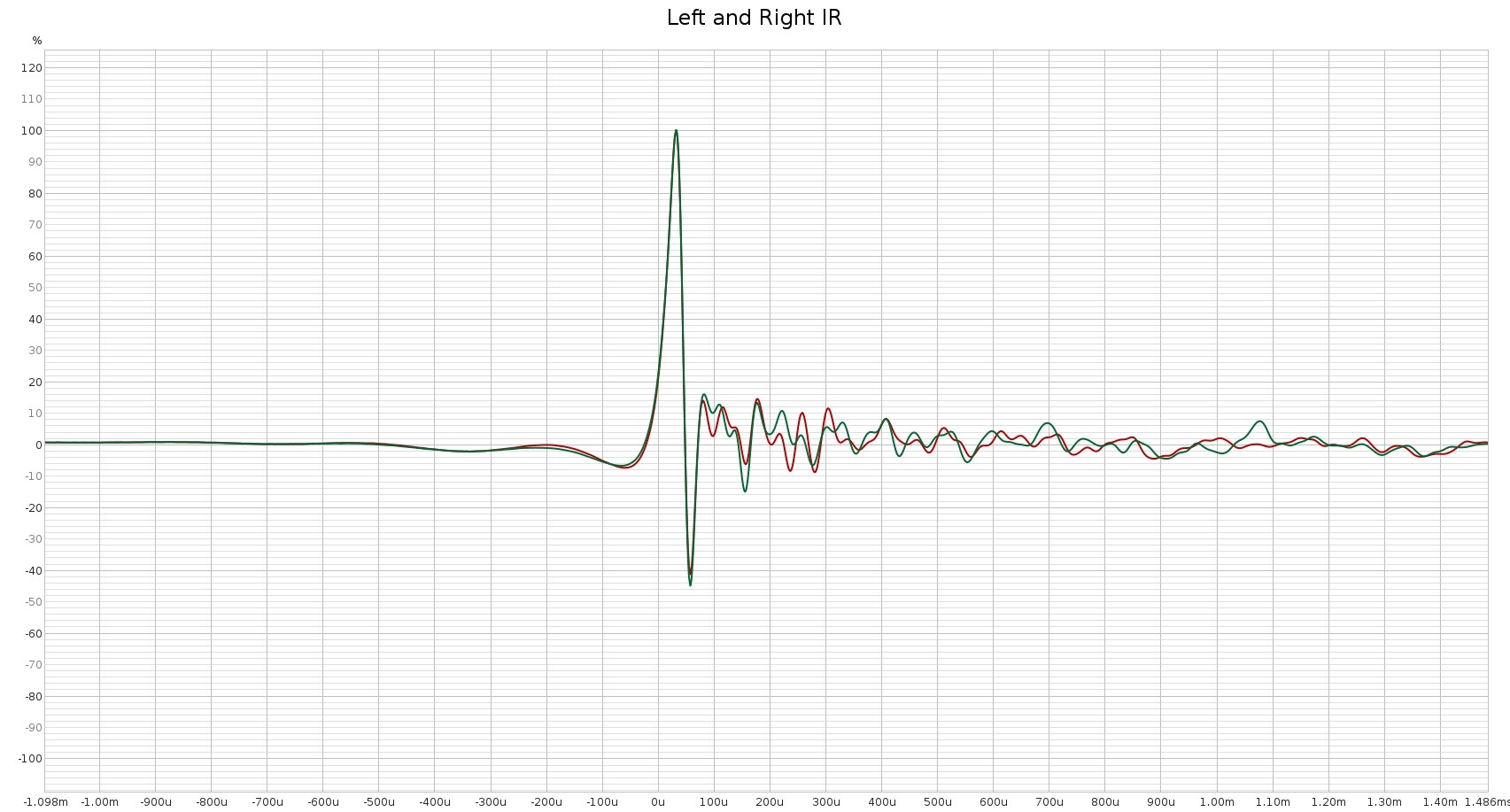

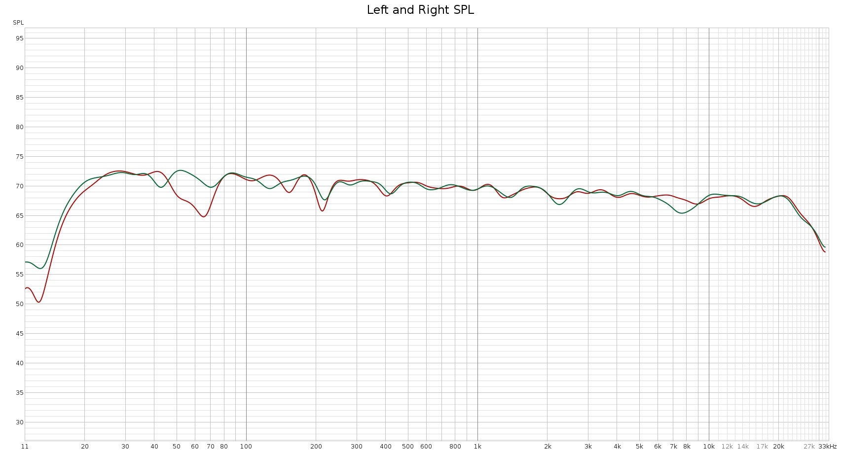

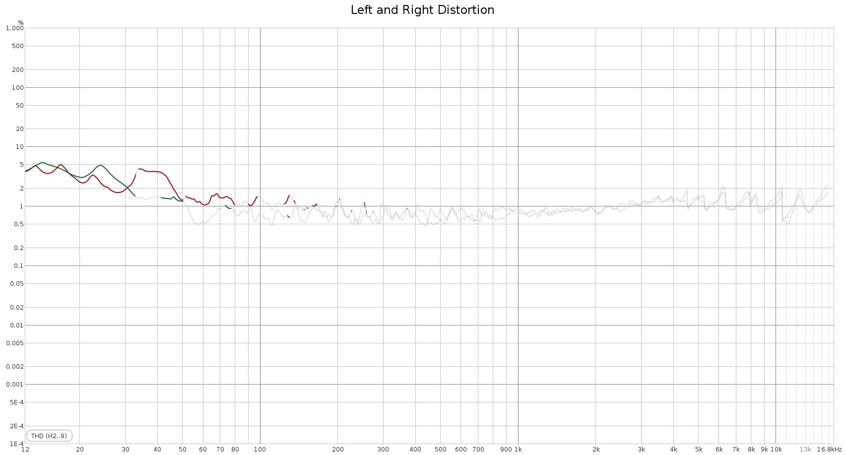

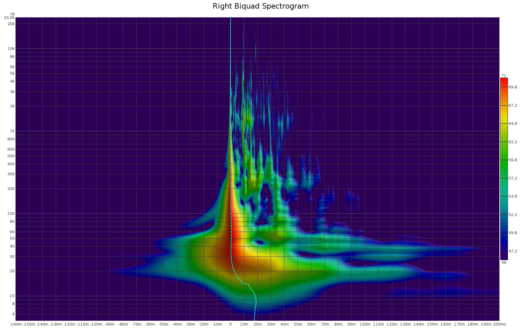

Some in room measurements taken at the listening position:
I still have some refinements to make to get rid of a few remaining warts.
Sound-stage is extremely precise and detailed. Very happy with the sound.
Still have some time alignment work to do between the separate baffles.
- RePhase Symmetric Linear Phase 96dB XOs at 50Hz, 250Hz and 3kHz (Kudos to RePhase)
- Biquad slight tilt house curve generated from REW's EQ function and output in CamillaDSP's yml format (Kudos to REW and CamillaDSP)
- 176.4kHz measurements made with REW through Alsa CDSP and CamillaDSP via REW's external chirp-gated sweep file playback function (Kudos to SeaShell)
- Time alignment done in both CamillaDSP and RePhase
- Each left and right channel consists of 3 separate baffles (Sub, Bass, Mid/Tweet)
- Measurements shown with a 6 cycle FDW.

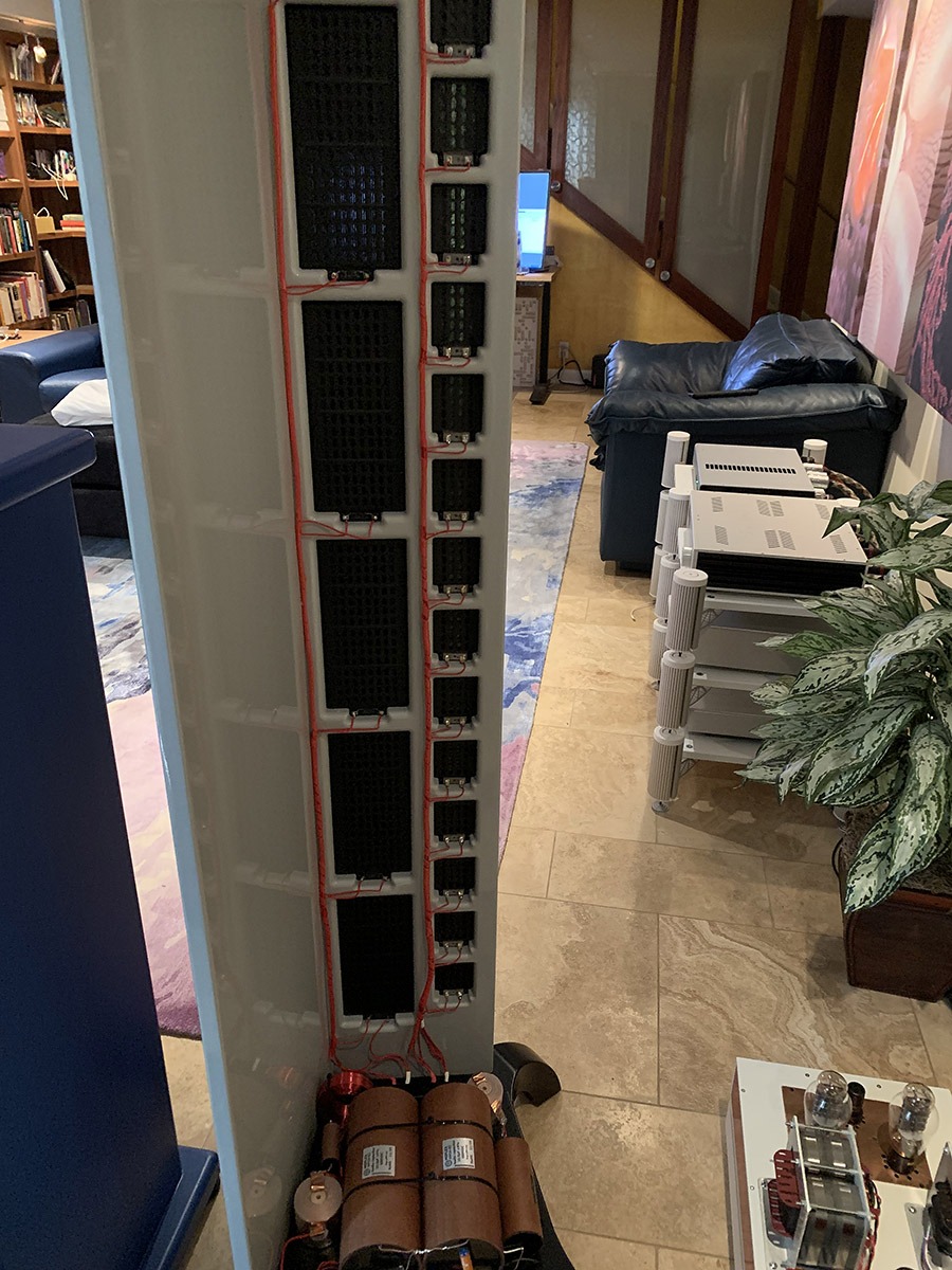

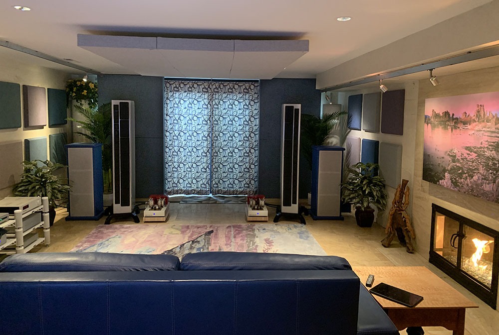

Those are my speakers mentioned in post 228. They are now fully broken in and sounding glorious. I had the cabinets painted with Mazda Ceramic Metallic paint which came out very nice. The cabinets are made from a polycarbonate composite.
I'm planning to replace the triple servo woofers with quads painted the same ceramic color. The triples have plenty of output, but since I doing new cabinets, I decided to go for the quads.
These are built using sixteen GR Research Neo3s and six BG Neo10s. I bought the NEO10s from PE when they got their last shipment. Danny Ritchie from GR designed the crossover which I built using copper foil caps (Miflex and Jupiter) and foil inductors (except for the notch filter which is built with lower cost parts). The NEO10s are rolled off at around 180Hz using an inline cap in front of the amps. They blend very nicely with the servo subs.
I'm driving these with a DIY parallel 300B SET amp which produces about 15W. Danny claims these are about 98db/w efficient, and they play plenty loud with these amps.

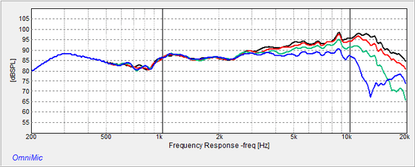

GRS mid options: my use case would be an array of GRS planar drivers about 60” in height, covering 500 hz - up to at least 3 khz, although I might want to experiment with taking them up as high as c. 7 or 8 kHz. There would seem to be 3 options: PT 6825 8”, PT 6816 8“ slim version, or PT 5010 10”. Ignoring relative costs, I’d welcome peoples thoughts on which of the 3 would perform best across this frequency range.
@Jaytor Great build! I am curious if you still feel the need for all the room treatment I see in the picture? Is that for this speaker, or for some previous boxed speaker? I ask because in my living room about 1/3 of the walls is glas, not that much sound absorbing furniture either, but sounds very good indeed, which is a very nice overall characteristic of dipole systems.Those are my speakers mentioned in post 228. They are now fully broken in and sounding glorious. I had the cabinets painted with Mazda Ceramic Metallic paint which came out very nice. The cabinets are made from a polycarbonate composite.

I would not use the slim version below 1khz personally. Maybe 800hz in an array. It's distortion rises dramatically below 800hz.
