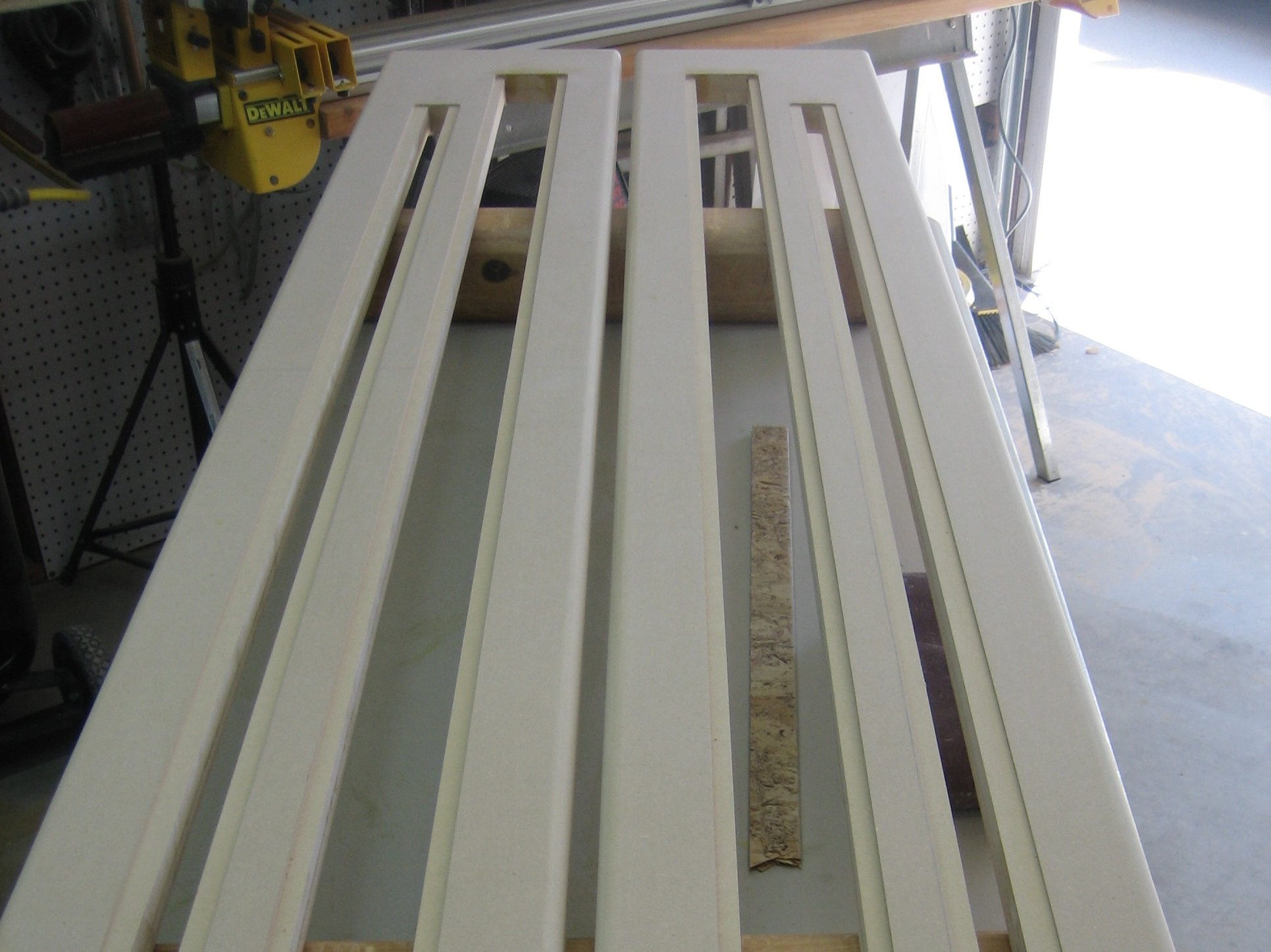

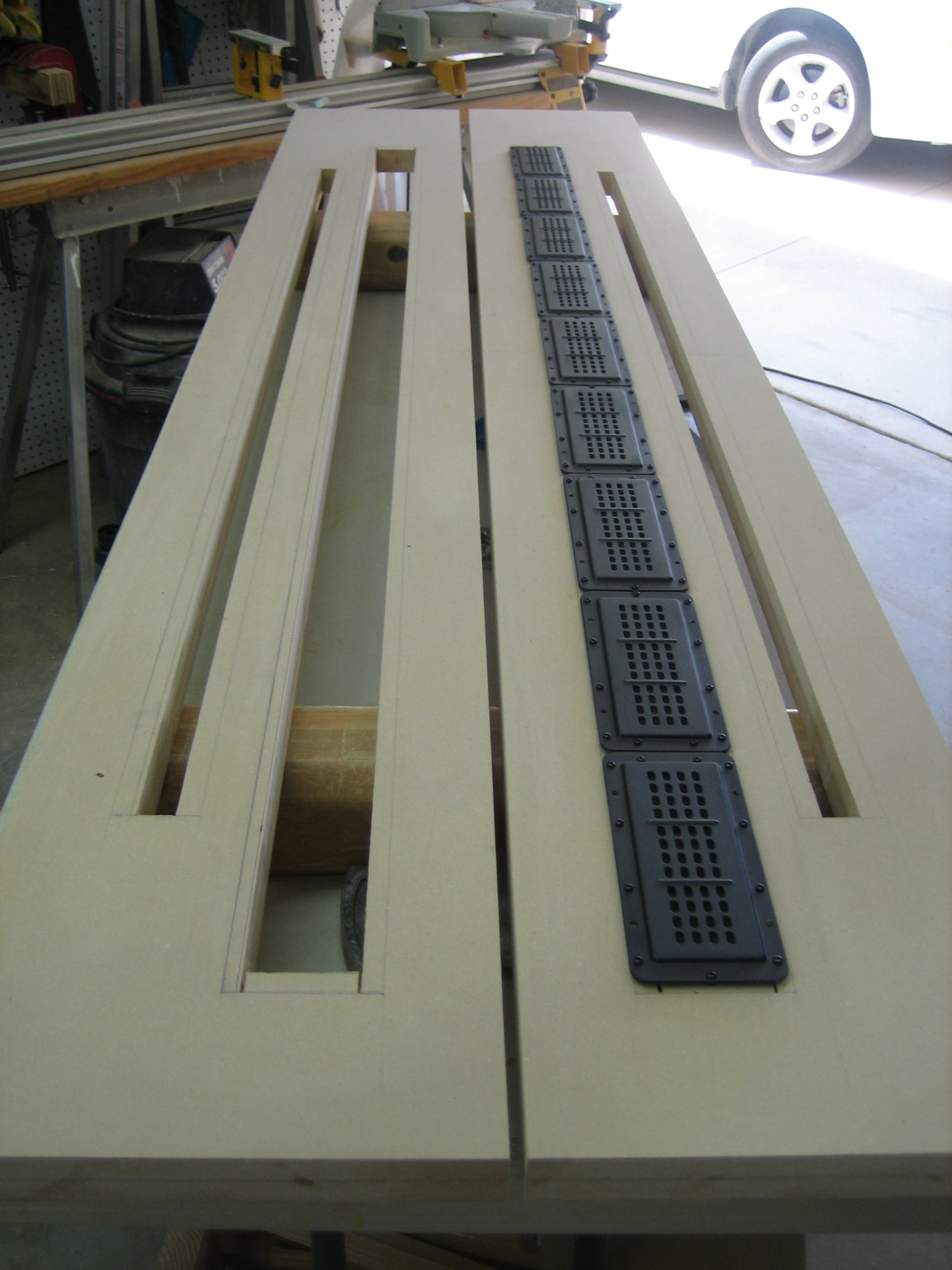

A couple quick picts of my WIP NEO8/Ribbon line array baffles.
(6 foot midrange line) flush mounted 9 x GRS NEO8's per side paired with (5 foot tweeter line) flush mounted ribbons in 12" wide baffle.
4" center to center. Half-round outside vertical edges and 45'd slot backs.
Top end of a 4-way system.

I got side-tracked over the summer and have recently resumed the project. Finished the milling (front flush mount drivers, 3/4" roundovers in the back slots and 180 degree 1.5" bull nose on the sides to minimize edge diffraction). Sealed the baffles prepping for paint which appears to have put a harder shell on the MDF that shouldn't suck up the paint. Ordered more parts that came in last week and this week. Ready for paint soon and then mount, wire and fire up.

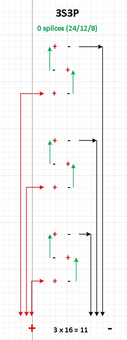

Decided to use Canare 4S8 and 4S11 for the hookup wire and cables in a 3S3P configuration (fast free shipment from PerfornanceAudio dot com). 3 serial strings of 16 gauge in parallel makes 11 gauge at the speaker terminals. 4S11 star quad is then 11 gauge back to the midrange amps. 16 gauge from the ribbons to the binding posts and then 4S8 going to the tweeter amps.
I will determine the NEO8's low end XO once I have the array up and running but currently starting at 250-300Hz from my prototype experiments. It may change if I use DIY OB/Dipole bass panels and am able to run them higher.
Here is a simplified wiring diagram that does point-2-point connections with no splices, only junctions at the binding posts.
I am rotating the drivers in each group of 3 to make the wires as short as possible in each group (not indicated in the picture below).
The arrangement (drivers and wiring) will be mirrored between the 2 speakers so the wires run down the same portion of the back of each speaker with out crossing over one and not the other.
The resulting NEO8 array should have the same resistance as an individual driver.
