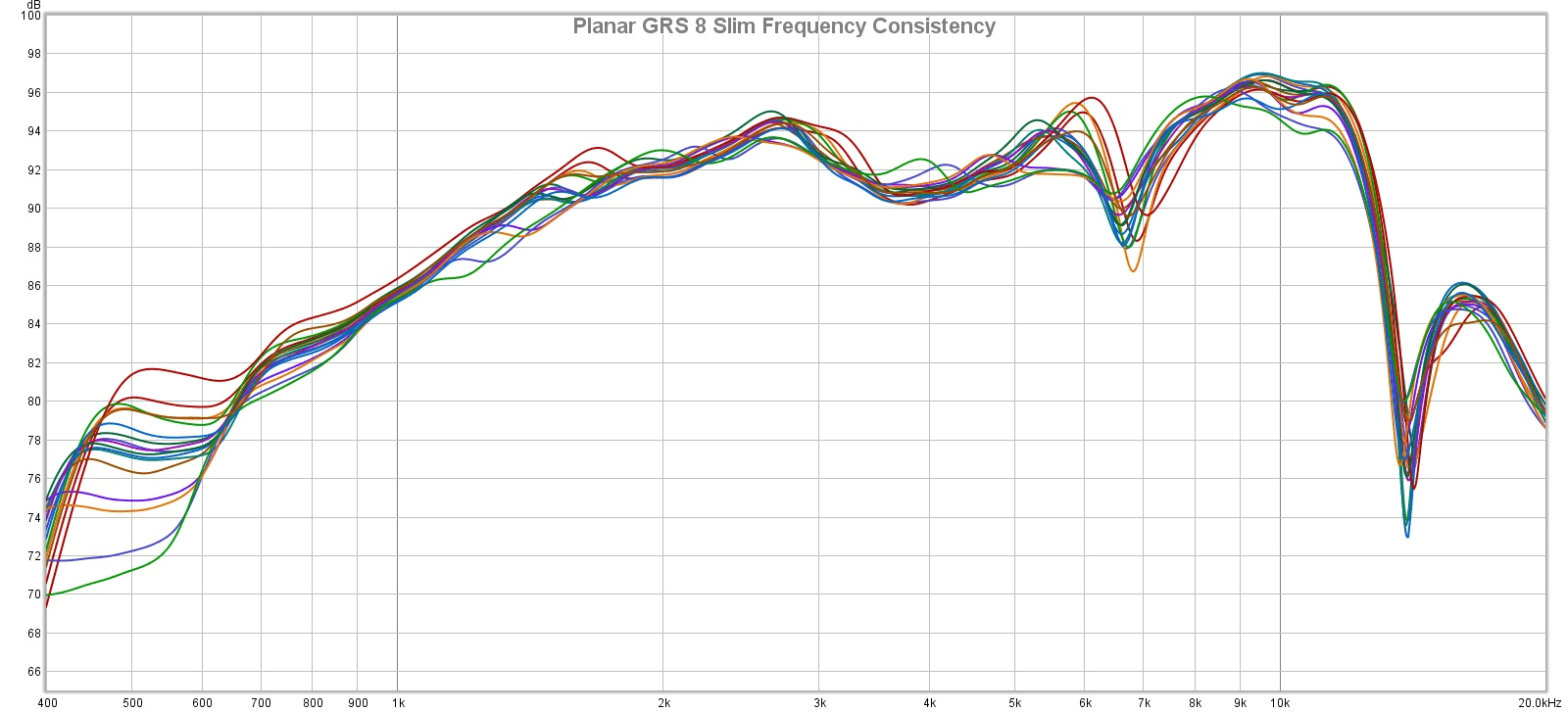

I was looking at these measurements:
A near ~20dB dip at 15kHz is def not similar. And this was across 17 units
Admittedly I have seen other measurements more in line with the official GRS measurements so maybe it's a non issue.
Those specific measurements were not done at a normal listening distance. The distance was very close and they were mounted close to a table in a vice. They were specifically made only with the purpose of having a consistent mounting method such that I could measure the difference between the drivers i.e. the driver consistency.
When I have measured normally then they perform close enough to PEs measurements that I'd say they are accurate.

Let's hope they have better consistency than the standard Chinese BG knock-offs.
