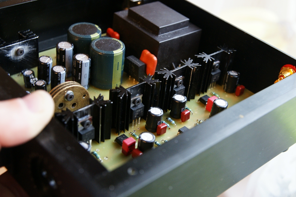

Yes, it's a meanwell PD-25.
Regarding ground loops: I've tested with a laptop and a phone - both produce the same result which is a quiet but still audible hum. Since neither a laptop nor my phone were connected to mains during the test I'm thinking I may have a ground loop somewhere internally then.
The amp produces quite a lot of noise when no input is connected - is it normal?
I know I may be fighting an uphill battle here with a SMPS but I'm willing to spend time to debug this one and add some more filtering if necessary.
I'll try to draw all my ground connections later today so that you guys can have a look and tell me if I'm missing something here.

Well thus actually is a grounding problem.
With floating ground
I had similar issue in another head amp. Whenever it was connected to a non grounded spruce simialr to yours there was hum.
How is your volume pot wired btw?

No volume pot for now, feeding it straight from the source. I will try to unplug some redundant ground connections and see what happens.
EDIT: I think I solved it. I wired the headphone jack in the wrong order 😉 I'm testing the amp right now with HD600s and it's super quiet. I need to wait till I go back home to test with my IEMs as they are more sensitive.

It looks from your photo (a nicely detailed one too) that the 0v grounds for each channel are common together on the power supply output terminals, then go each amp (with it's own input ground/shield) and you have taken a separate ground wire output and commoned up these on the headphone socket - try removing one from the amplifier output terminal and see what happens - I use the 4 pins wiring system these days to avoid this possible complication
I remember somewhere that a resistor was sometimes inserted in the signal ground wire but can't remember if this is practical/suitable here
Check the Meanwell ground/0volt scheme - You could also make up a metal mesh cage to cover the PR2525 and fasten it to the chassis
On the Neurochrome amplifier switch-mode power supplies, Tom uses a choke and a cap on the output of the switcher supplies - I don't know the values (a proprietary design) but it illustrates that it might be worth looking at this later on.

Thanks for the suggestion jameshillj, when I rewired the headphone jack I had to disconnect one of the ground wires from headphone jack (no soldering iron at hand) so maybe that helped as well!
