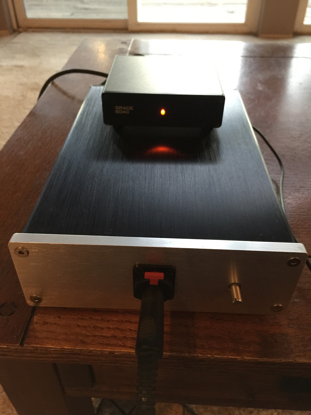

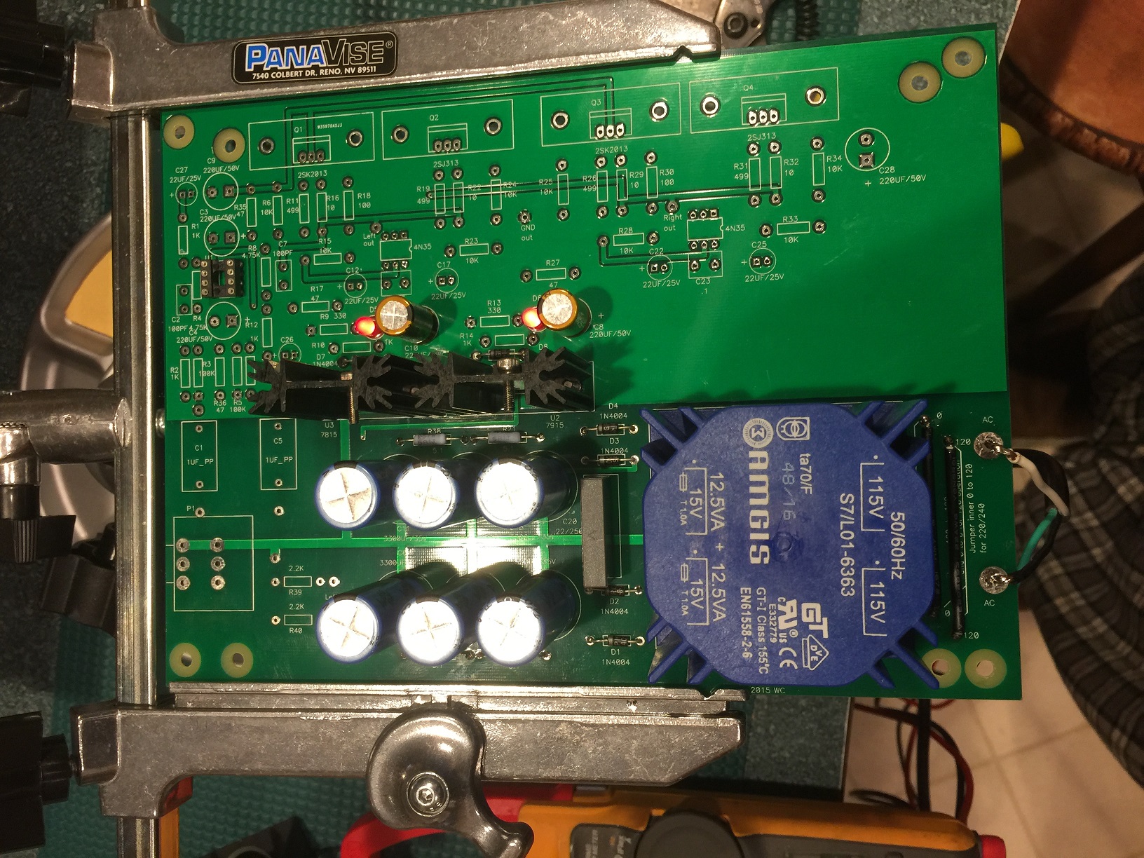

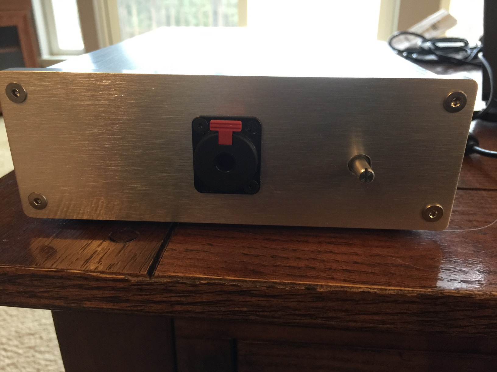

I completed my Whammy build yesterday and thought I would share some thoughts and pictures. My main use will be listening to music while working at my desk. Right now I am streaming Tidal through a Grace SDAC which sounds pretty darned good for a budget rig especially with a “Master” quality file. First and fundamentally - many thanks to Jim (6L6) for the build guide and to Wayne for giving us a great design to work with. Their ongoing support of the DIY Audio community makes it a heck of a lot easier to have a successful build.
My Whammy went together easily, and worked almost without incident. There was one brief moment of panic when I first fired it up and heard a strong 60 Hz hum in both channels and low output in one.😱 After a deep breath or three, I started troubleshooting and found the 3.5mm jack feeding the Whammy was not plugged all the way in to the SDAC. Sometimes the solution really is that simple. 😀

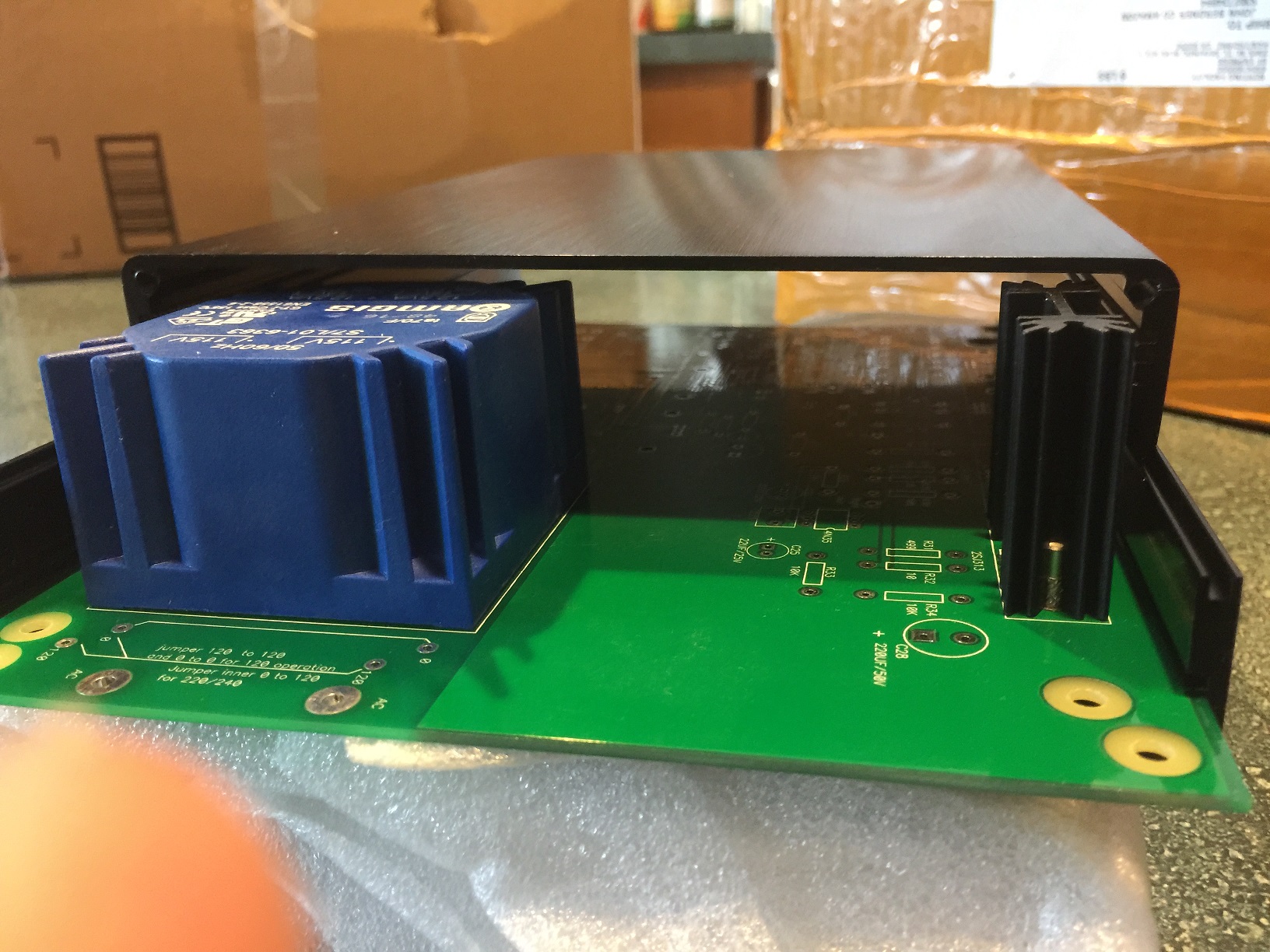

I used a 1706 enclosure from AliExpress but payment was kind of a pain in the neck due to security alert issues from my bank (took three times to get it to go through). I later found the enclosures are also available on Ebay which is much easier at least in the US - just do a search for 1706 enclosure. When I scaled the dimensions of the enclosure off the AliExpress drawing it looked be very close to the height of transformer and heatsinks (1.5"/37.5 mm). Fortunately, everything fit fine - see picture below. Also, the enclosure is slightly too wide and so the board can fall out of the groove on one side or the other. I added some standoff feet and solved this minor issue. Some tape on the corners of the board also works to take up the extra space and keep the board cented and in the grooves. The enclosure did not come with any hardware but a quick stop at the hardware store solved that issue. Overall, I like the enclosure and would recommend it for this project.

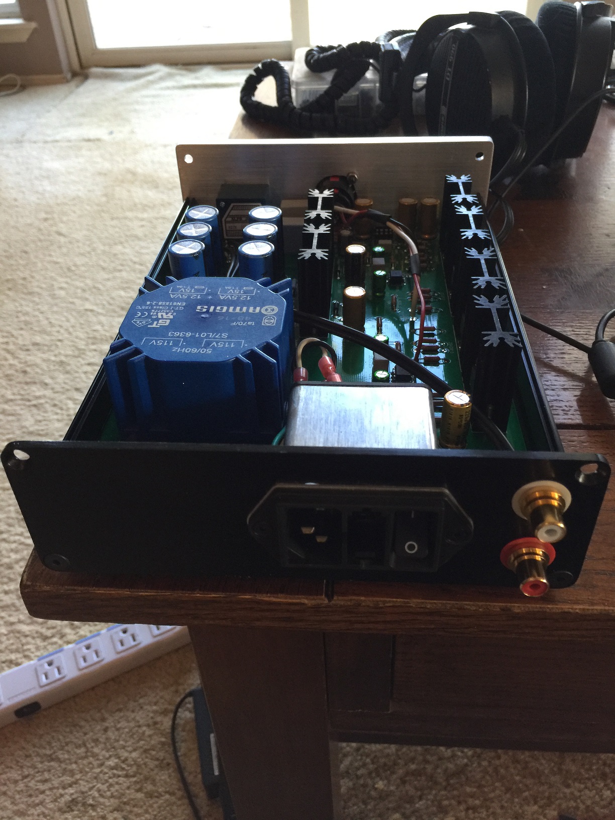

In terms of components I pretty much followed the build guide and got everything, other than output transistors, from Mouser on a single order. I did use fast recovery diodes throughout and purchased some extra / alternate caps (Nichicon, Panasonic, and Silmic II) to try swapping different caps in and out – if I get around to it. Some op amp rolling also seems likely in the future so the op amp is socketed. The transformer is +/- 15Vac, the Op amp is OPA2134PA and the output transistors are Toshiba 2SK2013 / 2SJ313 from my dwindling stash.
Also, I added a Schurter filtered, fused, and switched AC input module. It is the largest single cost in the project and probably overkill. I had great luck with it on my Pearl 2 (silent) and Pass uses filtered input modules on their preamps so I figured I should use one here too. The input module is big so it only really fits in one spot - but it does fit. Cutting the hole for the input was the hardest part of the project. I made a paper cardstock template of the backplate to make sure everything fit. I then put masking tape on the backplate and transferred the layout from the template to the backplate. I pre-punched then drilled some holes in the diagonally opposite corners and used a fine-toothed metal jigsaw blade to make the cutout. FYI – I always cut a little bit inside the lines and then file to final fit. This takes longer but insures a good fit.
