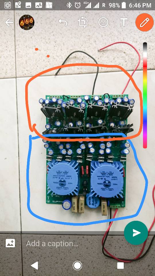

Does anyone have the meldabo psu build guide?
I have finished mine
Configured for 230v.
Trafo inouts are jumpered with one jumper each for 230v
Output up to filtering caps is 24vdc.
Outout section with regulators etc in orange semeto be powered but there are no readings on the output and regs. Everything in the orange square
Output jumpers are set up.
I am thinking whether I might have missed another section to jumper?

I don't have a build guide but recently completed mine (15V AC Talema's, 15V DC output, LM317) and at 300mA the output voltage is rock solid with a very very small ripple.
The only jumpers I used were the 230V jumpers you mentioned.
I used a bom that Meldano sent me. What did you use?
Nore: I would advise that you connect your AC protective earth to the AC input on the board.

Thanks Albert,
I have used meldano's bom as well but I don't have building guide, can't find it.
You are right abiut the ground will add it as well.
I have only used the common ground jumpers on the output, I think they should be set up. The Baird is very good, I am trying to see if I did a mistake anywhere

Ok found it.
I did not solder x01 my bad. Should have left them for later and forgot to do 🙂

Glad you found the problem 🙂
I did not put the optional Rx02 in. I thought I would mention it in case you were not sure. I kept to the bom as much as I could, but used half the amount of large caps, because I had 2000uF caps in my drawer. I had some nice United Chemicon GPD 2000uF 25V that I bought cheap a few years ago. They are automotive spec and overkill at -40 to 135 Celsius rating, but this is diy 😛

Can you please tell me which AC input on the board you connected your ac inlet socket earth to ? I thought about doing that to get rid of a 50Hz hum, but I thought it would short the ac input and blow a fuse !

If I am not mistaken, the 2 outer (of the 4) pads of the ac input are live and neutral and the 2 middle ones are protective earth. Check the top or bottom of the board to see if the 2 middle pads are connected by a trace.

The outer two pads are AC live and neutral. The inner two pads are also AC live and neutral. The two inner pads aren't connected by a trace. If they were the two primaries would be permanently connected in series - it would then not be possible to connect the two primaries in parallel.
The resin potted pcb mounted transformer the board is designed for doesn't have a separate earth wire or pin to connect to protective earth. I guess the regulations don't require one because the resin potting insulates the transformer, but I am no expert.
Can/should you connect a neutral pad to protective earth ?

I thinks we mean different pads. I referred to the ac input (where you attach your ac mains) and I think you are referring to the transformer pads.
