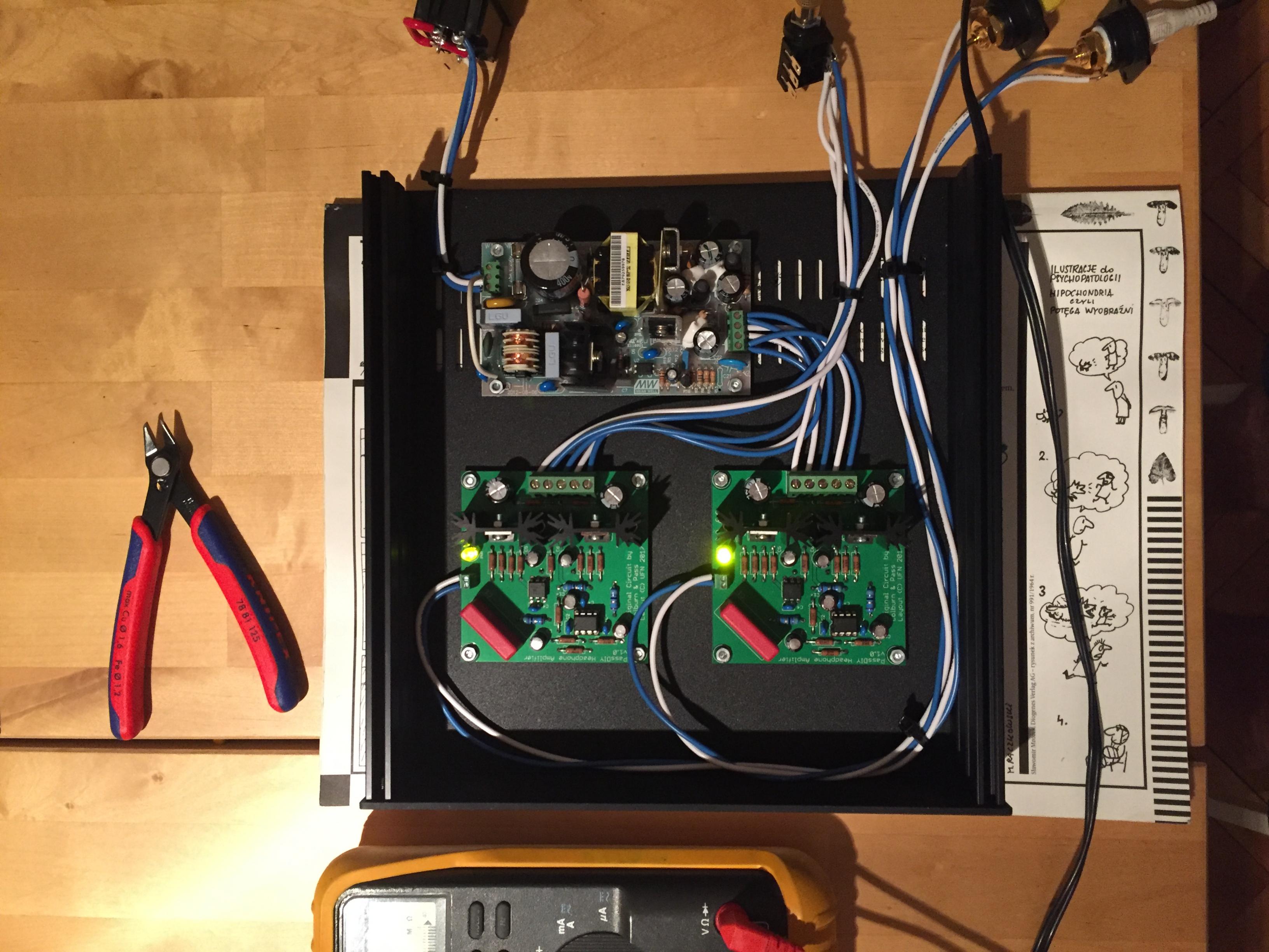

Just fired her up for the first time! The boards from Nisbeth call for a single opamp but I had only doubles - nothing a couple of jumpers and some IC legs cutting couldn't solve 😉
Now, the amp is dead quiet with inputs shorted to ground, but when I connect it to my laptop I hear a familiar mains hum. Did I mess up the grounding?
EDIT: uploaded a higher res photo
If the circuit is quiet with inputs shorted and appears when you connect both channels to a source, it's not mains hum, it's a ground loop...
