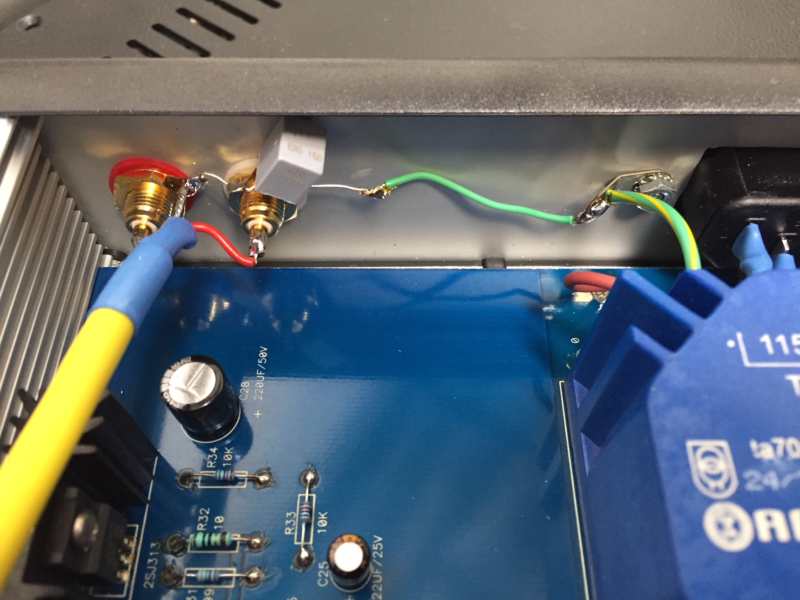

stijn001 - It's a .33uF 630V, chosen for the following reasons; I had it, and I had only the one. 😀
Wayne used a .1uF in one of his builds -
I definitely have some faulty components, but I can not figure out which one. The part of the power supply seems ok, the output voltages from the regulators are constant at +/- 15v. I can not understand now why on pin 7 I have 2V Dc

If you add together the dc voltages on the mosfet gates the remainder should be what the output voltage is on pin 7. So if one gate is -2.5v and the other is 2.6v pin 7 should read 0.1 volts. So something is not right there, it should not have that much dc voltage on pin 7.

look at the other side of the 47 Ohm on pin 7 and see if it is higher or lower.
Today I made the measurements, now at the output of pin 7 I have 14.56V, after the r 17 = 47ohm I have 14.42V
Turn the amp off and measure resistance between each pin on the opamp and the ground.
Should I take my first measurement or do I have to wait for the physiological charge of the capacitors?
If you have 14.56v at pin 7 it could mean you have no negative supply at pin 4.
Yes on pin 4 I have a -14.96v
