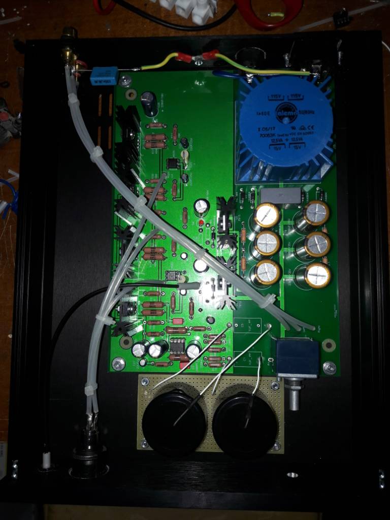

One cause of hum might be the wiring from input RCA jacks to the pcb input. If I understand the picture in post #982 correctly the wiring is done with three individual cables? These should be at least twisted together and it would be preferrable to use shielded cables.

I noticed that I now have the Left channel out 7v DC 😕😕😕
This is the new board with a build ..
Sweet looking build. What value is the brown cap connecting signal ground to chassis ground?
There is probably something wrong with your power supply.
Check all soldered joints.
I reviewed all the points, I removed the potentiometer, now I measured on pins 1 and 7, on pin 1 I have 230mV on pin 7 I have 2.6 V. pin 8 and pin 4 +/- 15V.
