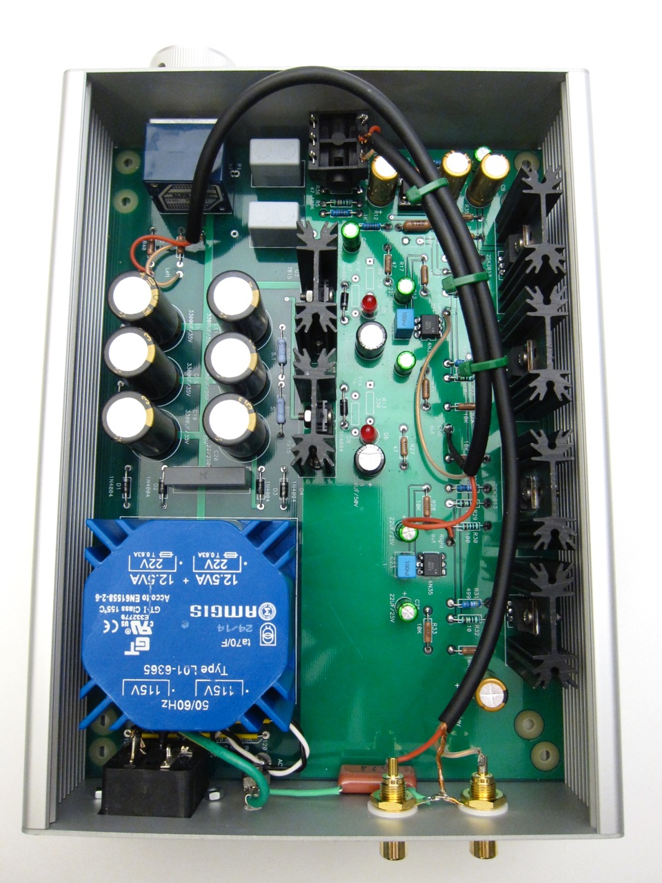

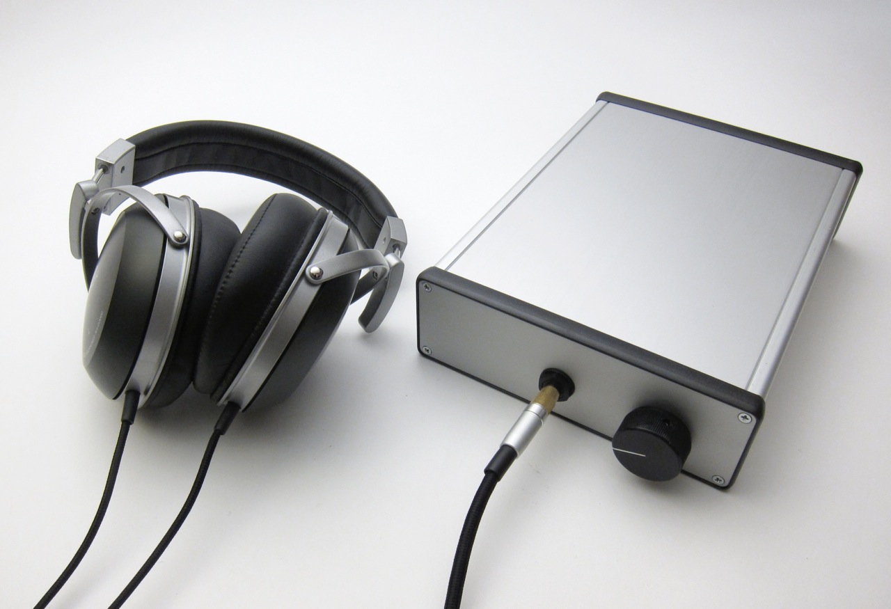

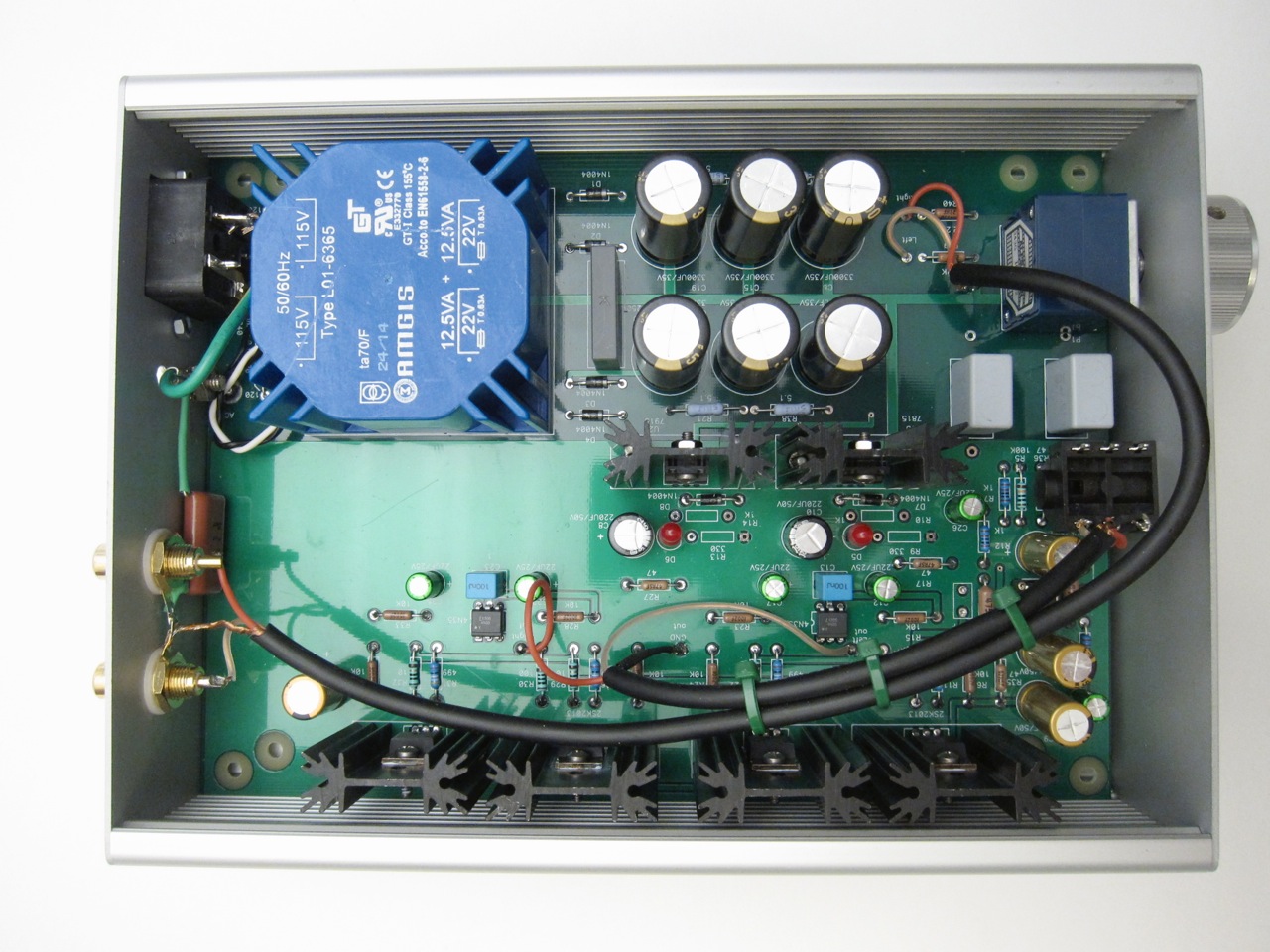

This is the new board with a build using no exotic parts. It sounds absolutely wonderful! (In this example my favorite has been a $0.50 OnSemi LM833 and IRF610/9610 output mosfet.)
The official guide is in-progress. PCB will be in the diyAudio store in the not-distant future.

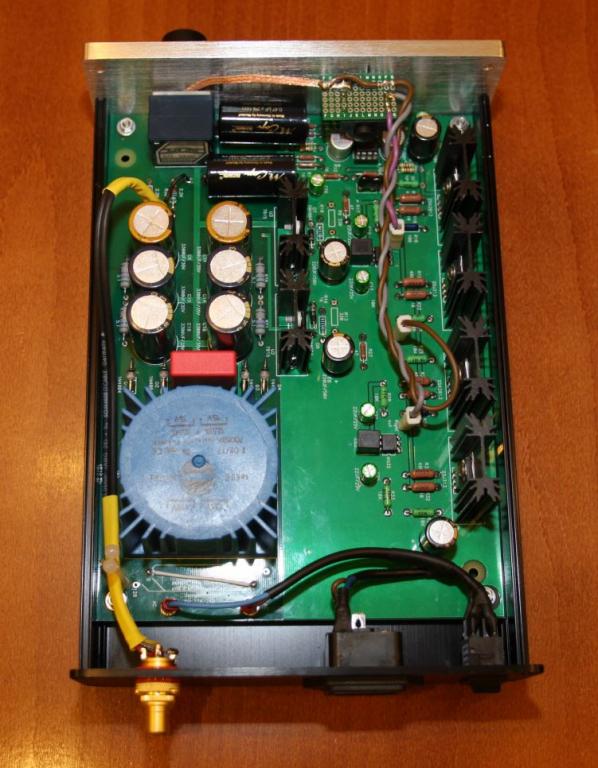

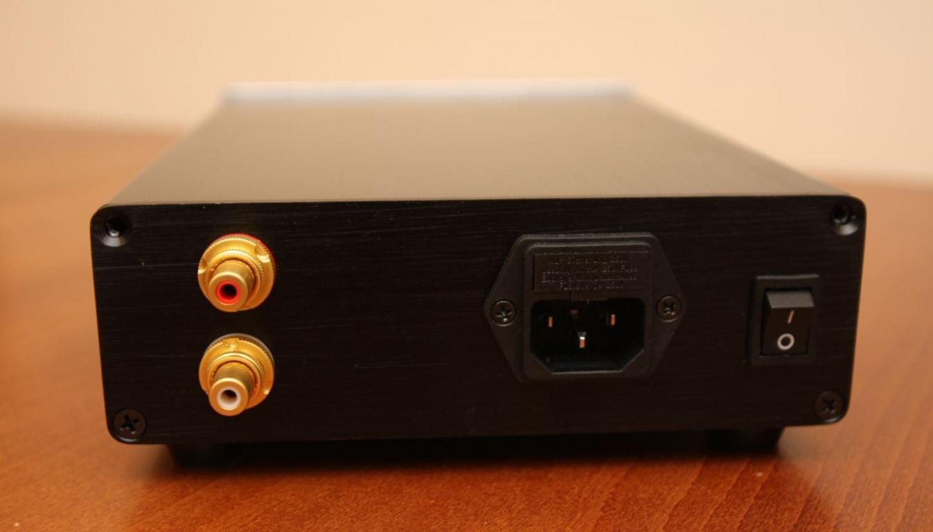

A build of mine. No CNC finish on the case yet, maybe later ...

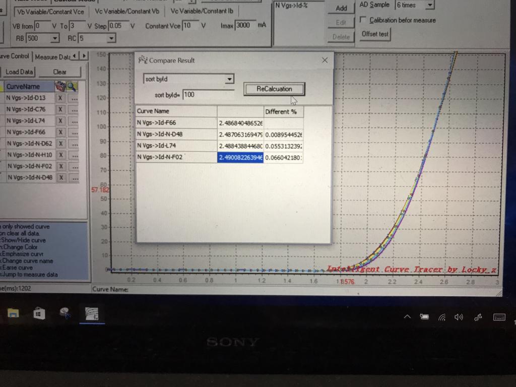

The most dificult were the the output transistors 2SK2013/2SJ313 - matched quad (2N,2P) was bought form liubincalvin forum user.
Plays nicely, however, the default gain setting is a bit low my taste (Senheisers HD600 needs more)
and , worst thing is that you don't need any matching with this circuit
Yes, I agree, optocoulpler bias regulation works like a charm.
Nevertheless, 2SK2013/2SJ313 available on the market are just fakes. You better use FQP3N30 / FQP3P20 instead ... or just buy from a trusted source, were matched transistors are also available 😉
Jim, I don't know whether this is the right place to ask - how did you cut the rectangular hole in aluminum for power entry module?
Thank you!
