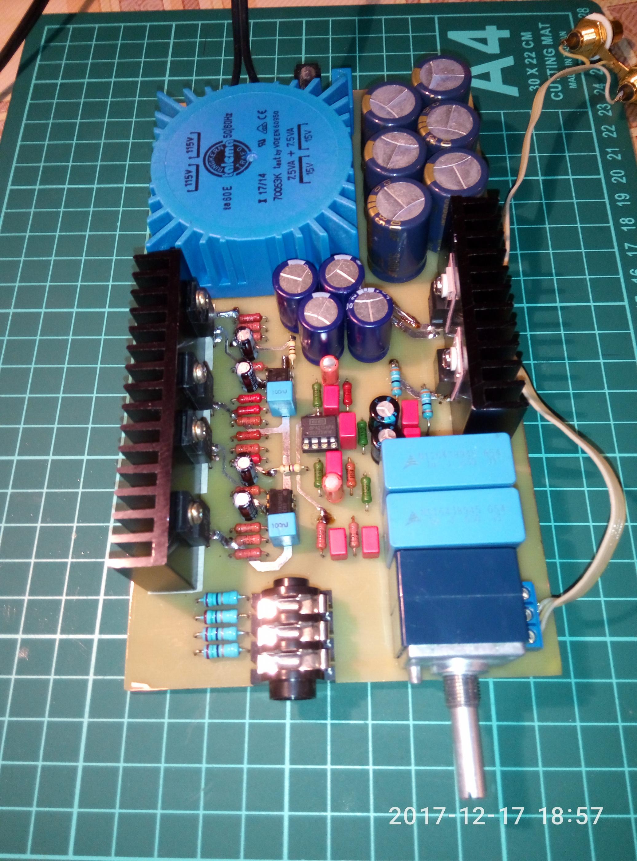

Hello everyone .
I have completed the amplifier, but it is not silent, I hear a buzz from the headphones, the buzzing increases by turning the volume knob. Partially delimits the buzz by connecting the gnd out with the ground.
What can it be?
What can it be?
Please post well-lit, in-focus photos of your build. 😀
Try removing C2 and C7, the 100pF capacitors in the feedback loop

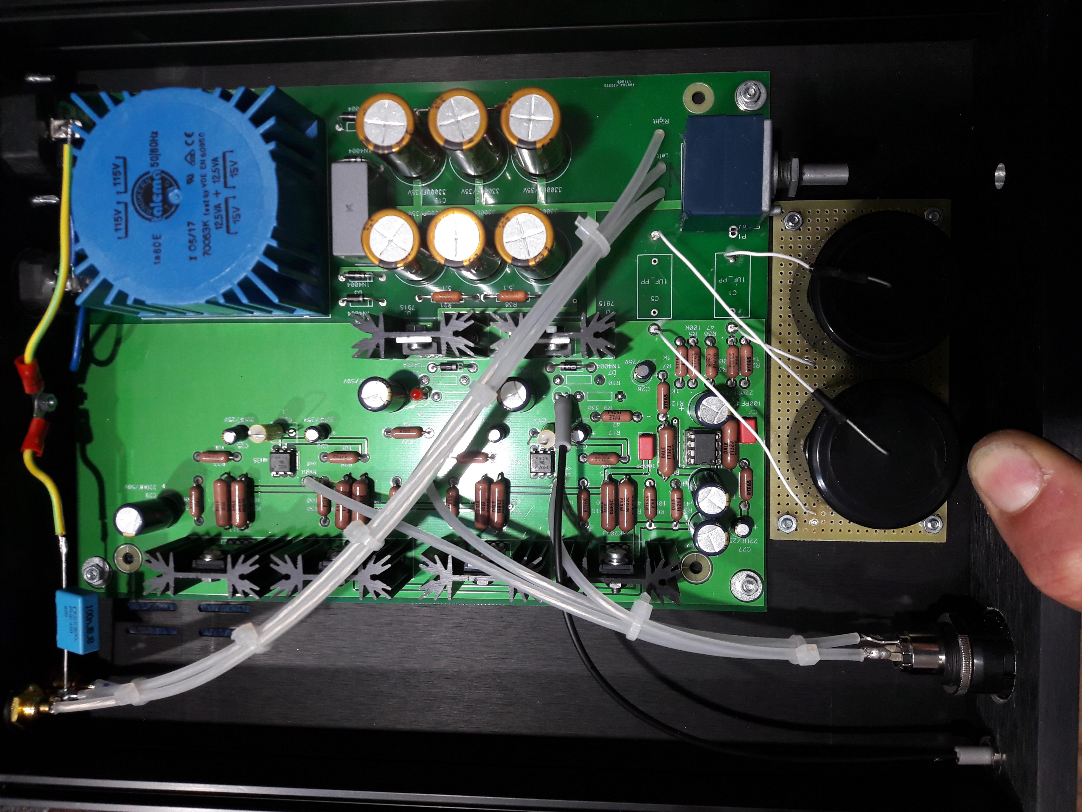

In my (just completed) build, it was buzzing until I fully closed the box. I guess the buzz depends on the volume control, as the pot affects the impedance between the opamp noninverting input, the ground, and the signal source. In any case it went quiet with the box (a Hammond extrusion) closed and sealed.
I had a similar issue previously with my build of Pearl 2 (thank you Wayne 🙂 ), and also could only solve it by fully closing the box. There I had to use lock washers under some of the flat head screws to get electrical contact between anodized panels of the enclosure.

Problem solved guys, it was a noisy led, I eliminated the leds and cap, and I jumpered r9 r13, now everything is perfect 🙂
