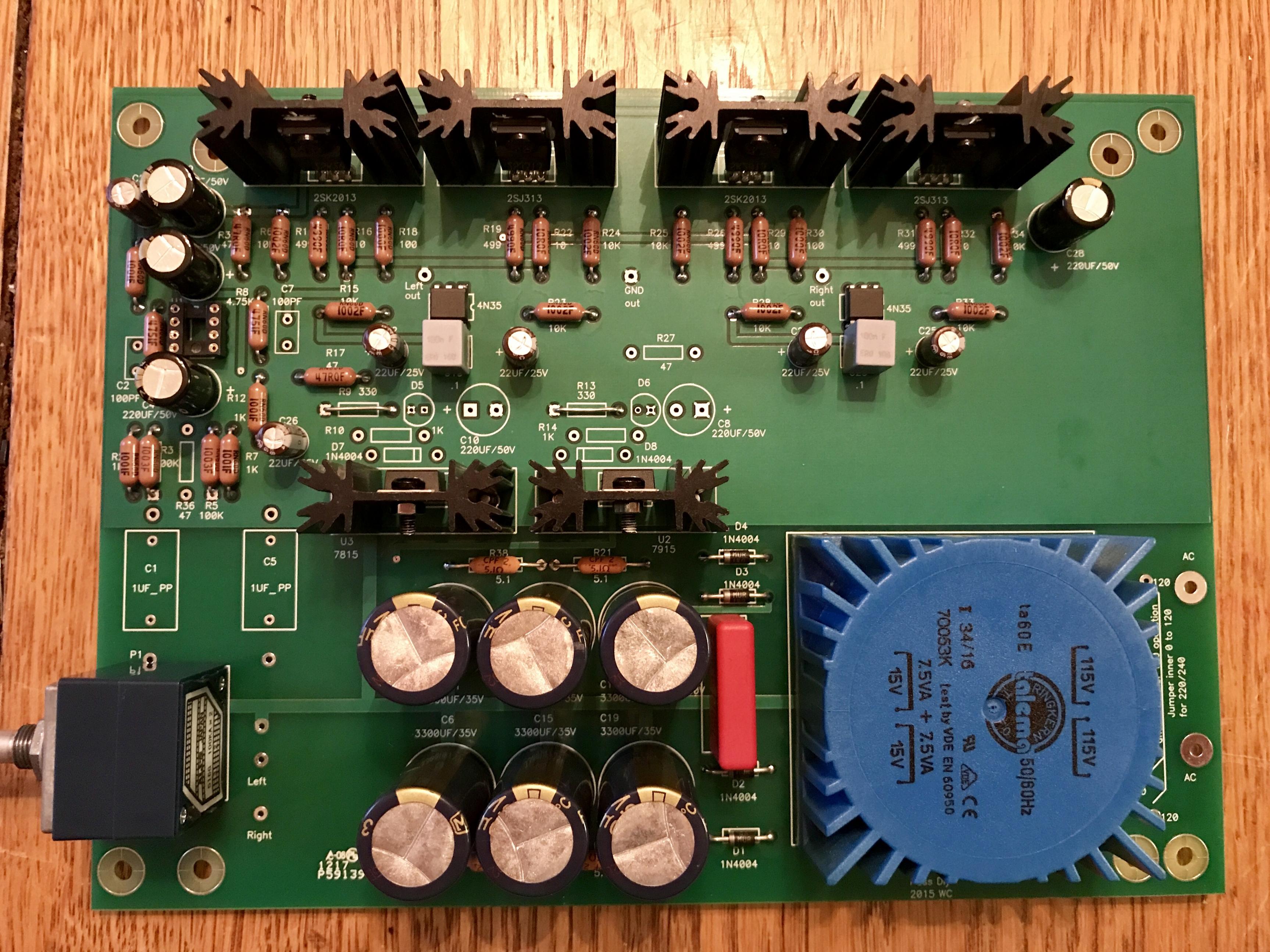

On wayne's PCB, I'm assuming R17 and R35 marked 47 ohm get jumpered? They look like they can be used to drop voltage from the FET rail to the op-amp rail ...
R35 & R36 ... sorry

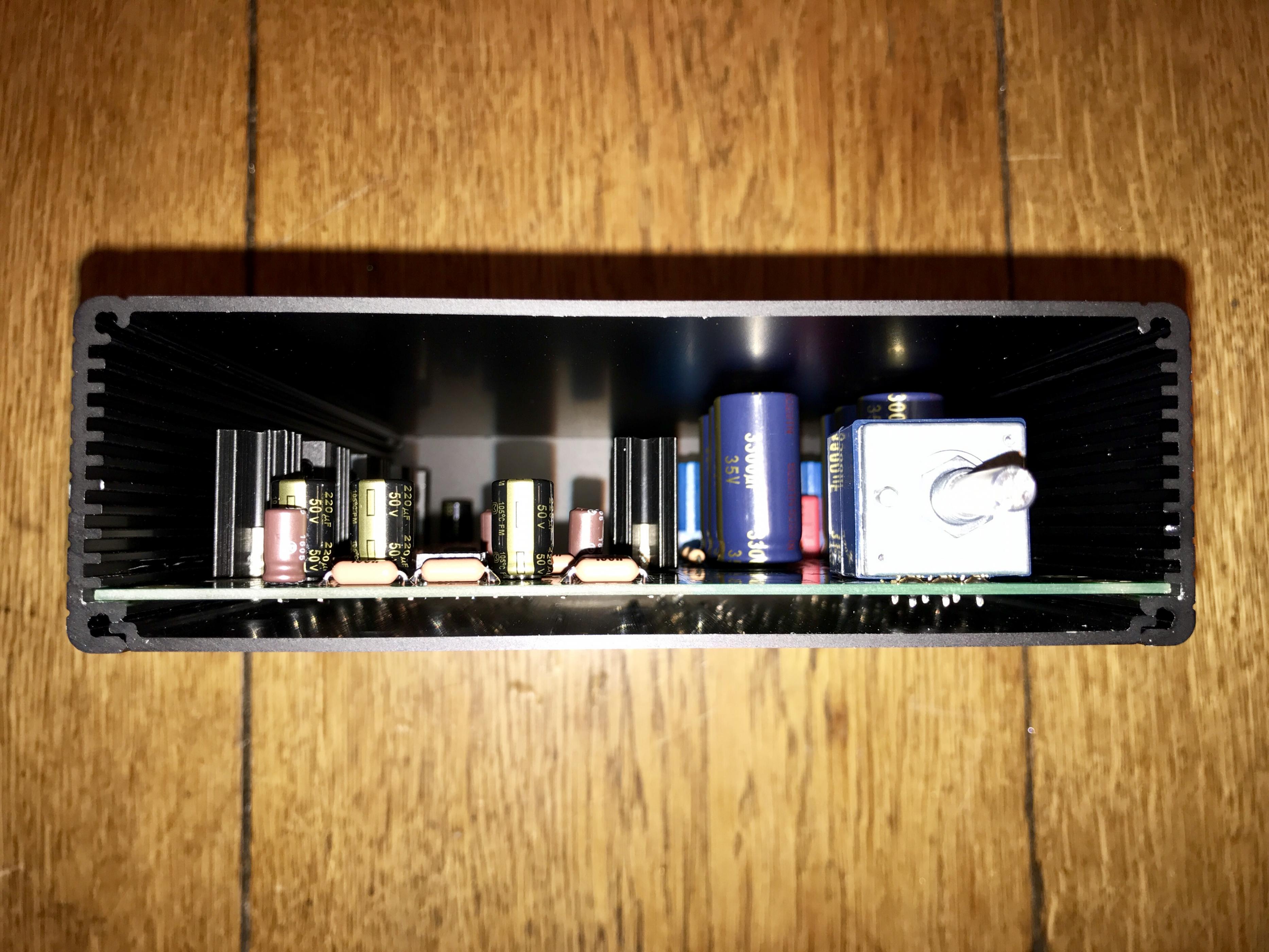

Anyway, got the PCB stuffed and test fit it into the chassis ... so far so good!
Where are you finding the Toshiba 2SJ313/2SK2013 transistors?
