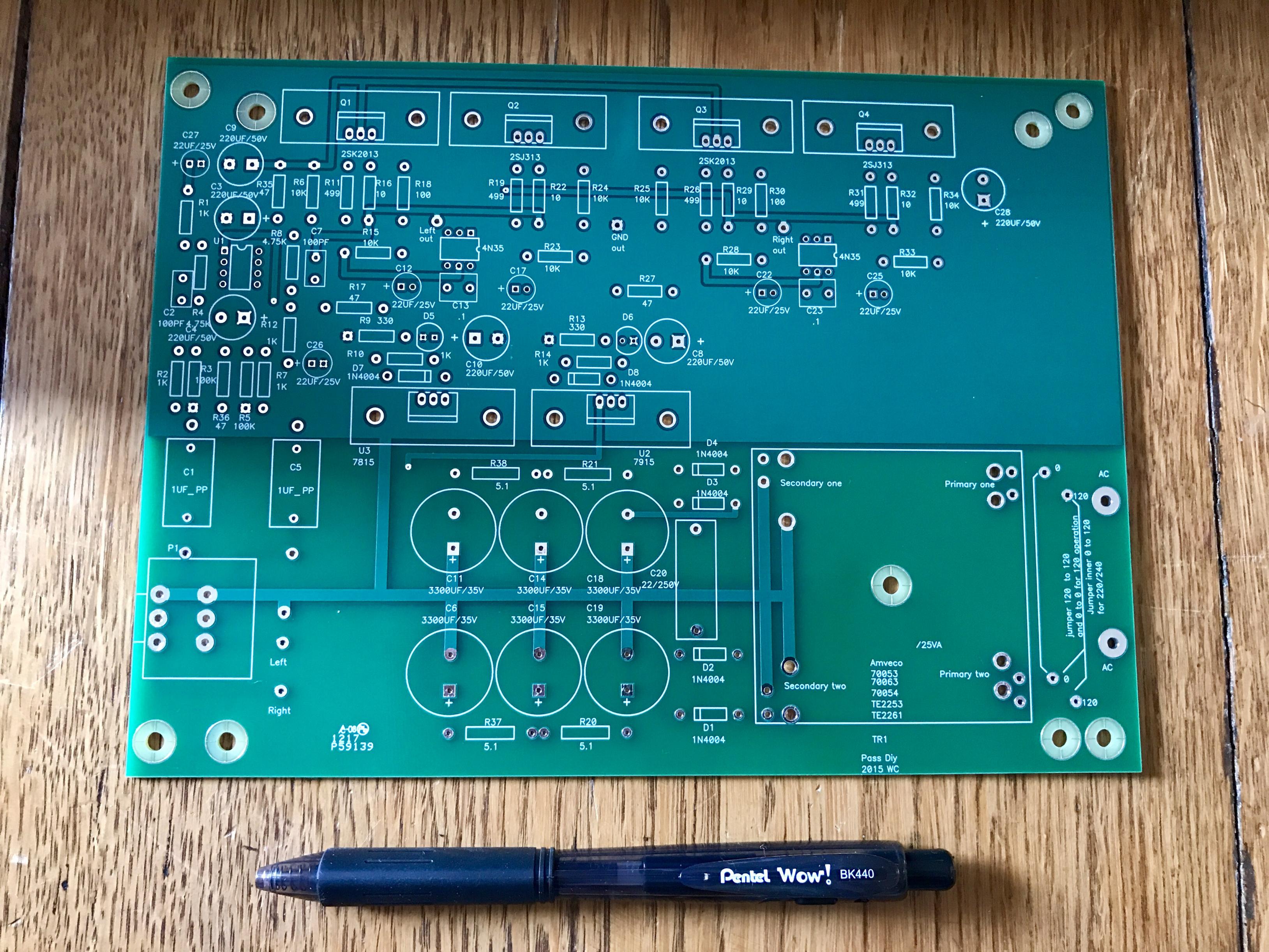

Getting ready to order parts ... I'm thinking 2W 5.1 ohms in the PS and RN60's everywhere else. FC filter caps for high-ripple and FM after regulators. Silmics in bypass locations and Auricap coupling. MUR140G's for bridge. Going to try a Burson V5i since I had excellent luck with a V5 in a Rotel phono stage!
For +/-15V I leave out R10, C10, D5 and jumper R9, correct? (Same for -15V) Want to stick with 15V to not limit my op-amp choices.
Any other thoughts/comments?
I'll be running Grado GH1's most of the time but also have some DT-770 250 Ohm when the house (read kids) is noisy. Is the 60mA sufficient or should I bite the bullet and go straight for 120mA?
Yes that is correct on the parts for 15 Volts. I would start at 60 mA it will drive anything well and see how your heat is.
Will this work well as a line stage for a pair of ACAs?
I like the idea of having both headphones and speakers as options.
