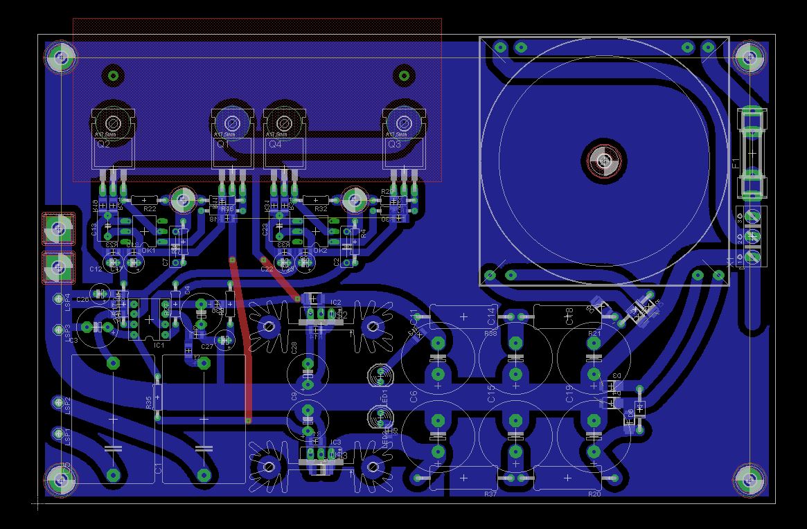

PCB single sided, 2 wirebridges, L shaped Alu-Profile for mounting to case.
used SMD Parts (1206) where possible.
Could be done by everyone by tonertransfer method.
Before to go further with this design I would suggest you to review creepage and clearance for mains connection side of the PCB. You routed audio ground too close to the mains input (they share the same terminal).

I can post the gerber files if that will help. Just been kind of busy with a few other things.
Please do! 😀
Gerber Files
Yes, Please do post the files.

I loaded Wayne's file into Online Gerber Viewer and the drl file does not align with the rest. Has anybody noticed that? Or is it PiCNiC (problem in chair not in computer)
No ... the file appears incorrect. The drill seems to match the original PCB design 6L6 posted, not the latest.
wayne - can you please repost the latest drill file?
