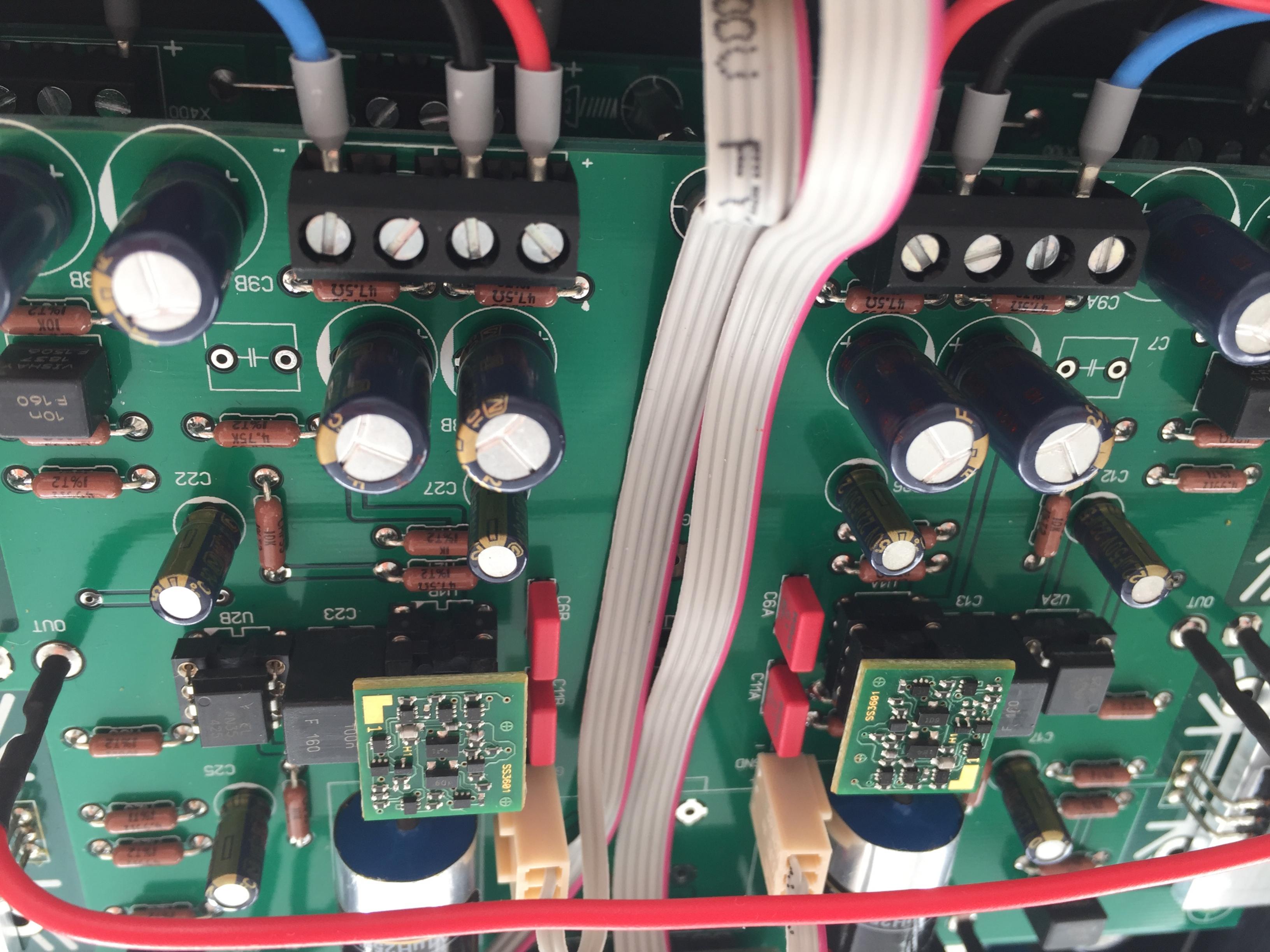

Also check for brainfart mistakes eg wiring of rca connections as well as checking quality of all interconnecting signal cables.
What dc offset do you have on the headphone amp?

DC offset left channel is is 175mV and right channel is 50mV - I expected better.

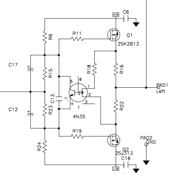

175mV seems quite high for a headphone amp. I'd personsally want below 10mV.
Are you using 2sk2013/2sj313 on output?
Totally agree
Yes
Some sensitive headphones could be driven to near their Xlim stops with an offset of 175mVdc.
I would be expecting <2mVdc of output offset for a headphone amplifier.
Did you use these output stage:
I found out that the R6, R15, R23 an R24 which are all 10K, must be real close, to have an almost zero output offset. Especially R6 and R24 if I remember correctly.
Also the V+ and V- of the PSU must be real close and stable.
Variations between v+ and V- give offset.
When I measured a few 10K resistors and picked the closest together, I now have output offset around 0.8 - 1mV at both channels.

I will look at my PSU.
I did change out the 2013 and 313 to no avail.

You can fix dc offset by changing R6 to 9.8k and add 500 Ohm trimpot.
That doesn't help you fix the main issue though.
thanks pico - nice solution to that problem

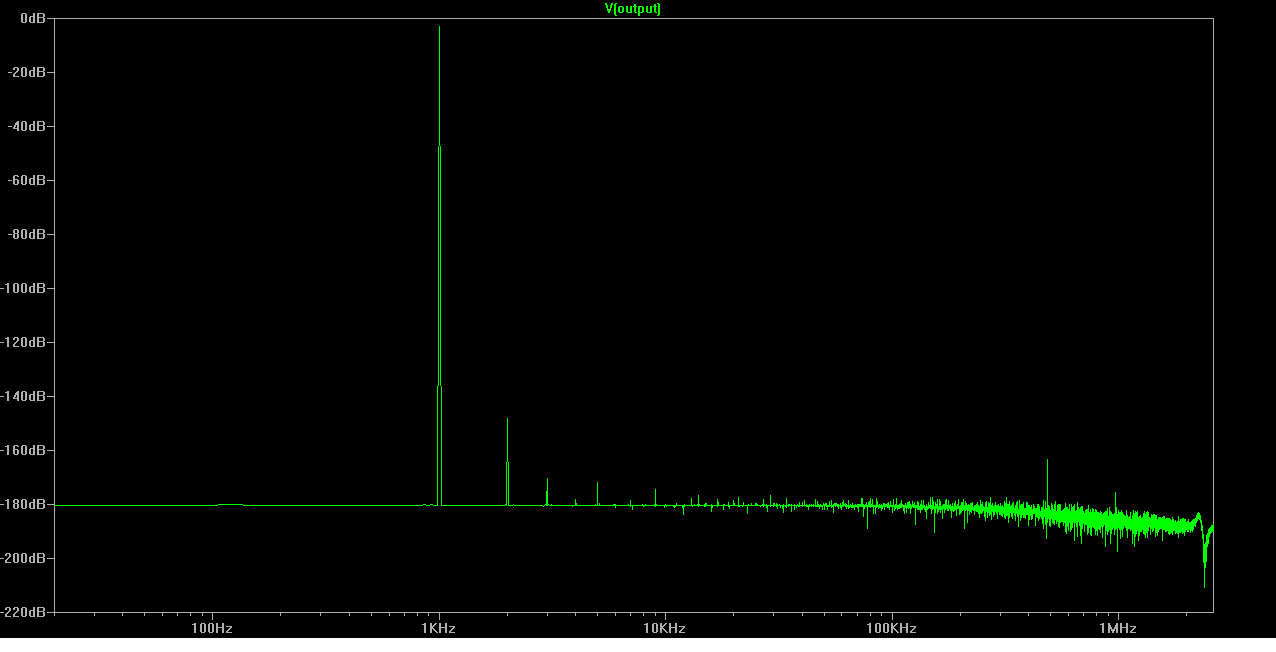

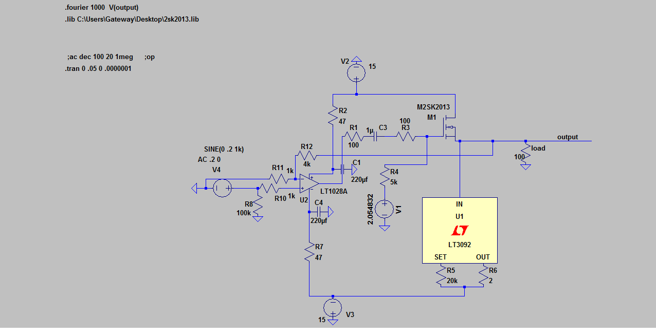

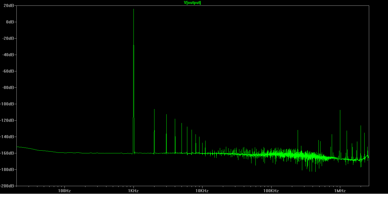

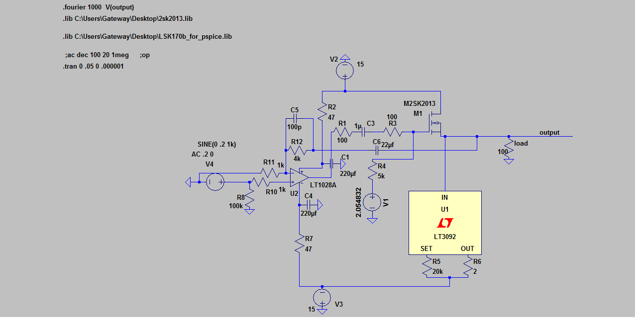

Well since I am waiting for boards for this amp and also only have a few 2sk2013 and no 2sj313, I removed about half of the passdiy headphone circuit and made it work with the one transistor. Well at least it works in simulation. I wonder if it will work in the real world?
I've been using ltspce for only a very short time now so I don't know it very well but I will take a guess that the FFT analysis for this circuit is pretty optimistic. The Passdiy amp looks even more optimistic. I assume that accurate FFT circuit simulation can't be done. If not I'll just have to wait and measure the passdiy board with the Arta program, I'm sure it will show a more realistic
picture.
picture.
It will ultimately depend on the accuracy of the models, but I do suggest you retry it with a more realistic 2.83V AC on the input.
