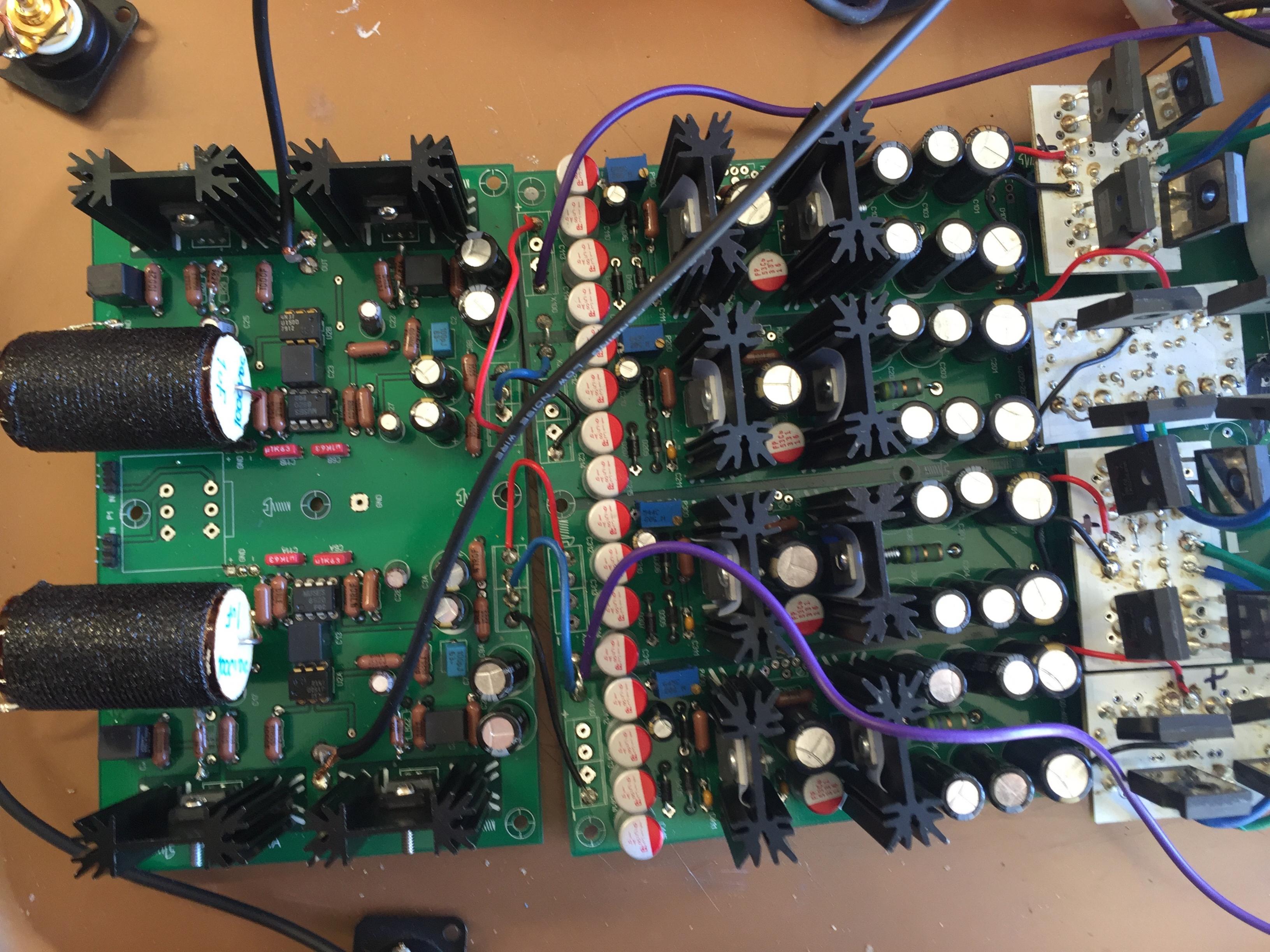

Help please
Used Meldano boards (thanks Daniel)
+/- 14V from the PSU to board
jumped in/out connector (at vol control location
bias is about 120mA to each JFet (.6V/5 ohms)
using XP10 as source
nothing from either channel
Muse op amps an LN37s have voltages at appropriate pins.
Resistance measured from input to output greater than 20Mohm on each channel when powered up.
I'm stuck

What is gain of XP10?
What is gain of Headphone Amp?
What is Vout of source (cd player, ipod, dac, etc)
Just trying to get the full picture.
Initial gut instinct is problem with muse opamps or some associated component connected to them.
