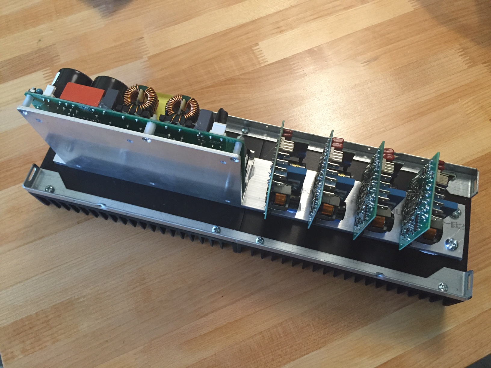

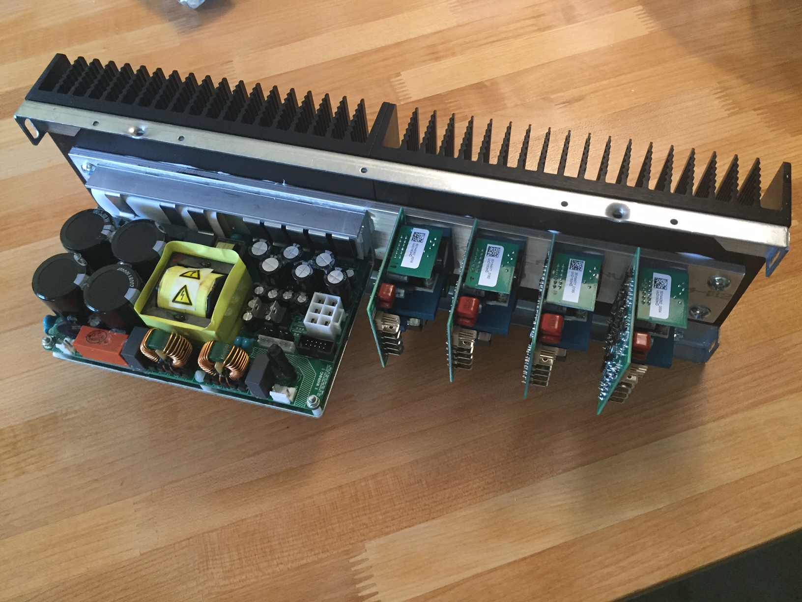

Well, I've finally got four channels and one power supply attached to the heat sink! I've also located and installed a 20 amp DPST paddle switch, rated for motor use. I'm moving forward assuming that the surge current would be given as worst case (240V operation) and it will be a lot less here with my 120V mains.
I did the thermal interface plate by hand, laid out with calipers and a center punch, and if I had it to do over I'd probably send that out to a machine shop too. Oh well... it saved me probably $100 to do them myself, and they'll work.
The speakers these are meant to drive are mostly assembled now, so I'm quite eager to wrap it up.

Clean !
Now you are ready for the wiring process 😀
An update - it turns out that the inrush is too small to measure with my clamp meter. When I flip the switch I hear a small delay before a click, but I see no surge current. That's a relief! I guess I worried for nothing.
You can't measure the inrush current because you have not enough time resolution.
The rush current is way too fast for a multimeter.

nice work on the heatsink and plates. Could you share the source?
Thanks! I got the heat sinks from Modushop: Modushop by Hi-Fi 2000
The rear plate is from Front Panel Express: Front Panel Express: Front Panel Design Software and CAD Conversion Service: Home
The interface plates are just 2"x1/4" aluminum bars that I cut and drilled over my kitchen trash can, laid out with calipers.
