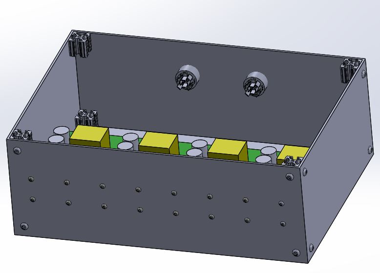

I looked around for a while to find an enclosure that I liked, but I wasn't crazy about the looks, size or cooling of anything. I can do some metalwork though, so here's my design idea. I want to use a 1/4" thick sheet of 1100 aluminum as a front panel, then use 1/8" thick panels for the rest. The corners can use pieces of 80/20 as 3D corner brackets... I already have plenty of scrap 80/20. The idea is that the front face will soak up the transient heat loads and act as the main heat dissipating surface.
Based on this convection calculator, assuming a 1/6th duty cycle for music compared to max power, assuming some paint to get radiation up and reasonably good thermal grease, the outer face of just the front panel should be able to dissipate the heat of the eight modules while keeping them all below 90C, indefinitely under worst case conditions. I've heard that 1/8th is a more realistic power figure for most music, but I want to be a little conservative.
I don't really want the front panel to be hot enough to burn skin, so I'll likely add a small fan to move air from the back of the unit to the front, exhausting through holes in the top and bottom plates.
So! The big question that I come here to ask you all, if anybody wants to offer an opinion-
I have a choice of two SMPS1200 power supplies, or four SMPS400 power supplies to run the thing. If I use four supplies then all four amps can connect to the DC error protection, and I get a nicer power supply rail for the tweeter and upper mid. However, if I use the SMPS then the maximum instantaneous current is a bit higher, and it will be possible to mount the power supplies into the side corners. This would give a central area for signal wires to pass through away from the power supplies, and it would enhance cooling.
For interconnects I'm using XLR balanced inputs, and output will be through two 8-pole Neutrik Speakon connectors.
I welcome any comments, and will be back with pictures as I build it up!

Thanks! I'd seen those before, but for some reason I thought they were even more costly. I'm mulling it over. They look good, and might result in temperatures low enough that it the electronics will last much longer.
I'm still trying to figure out the SMPS400 vs SMPS1200... In a four-way active speaker I definitely want to avoid crosstalk, but I still don't have a handle on how close that is to being a problem. The spec that seems to say how well I can avoid that is the PSRR, which is 65db. That sounds like if one amp module was causing serious ripple in the power supply rails, that would show up in the output of the other amp channel but attenuated by 65db. Obviously there would be more isolation if each module had its own supply, but I can't fit that and don't want to pay for it. I'm not even sure it's a problem. My best guess here is that by having two 1200 watt power supplies that I'm not fully taxing, the rails will hold a nice solid voltage and the 65db PSRR will keep the spurious signal *very* far down in the noise. I'm dogonne close to pulling the trigger on the eight UCD180HG and two SMPS1200A180.
I'm not all that sure that this should be much of a problem, as long as one PSU serves only one side. If you want to be certain, use a SMPS1200 for the woofers, and a separate SMPS400 for the mid, upper mid and tweeter channels, as these channels doesn't really draw much power... That'll run you €180 extra.

Thanks, Johan-Kr! I've ordered the 450mm deep 3U Dissipante enclosure. It's more than I was really hoping to spend, but it will let me move the power supplies to a reasonable distance from the modules and greatly simplify wire routing. It seems like wire routing and device proximity is something that separates the best from the rest, and if I'm going to jump into this thing then I shouldn't hamstring myself for no good reason.

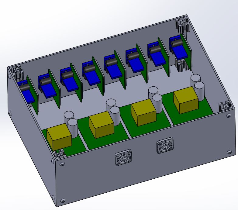

The latest layout is attached. I'll run the AC power line along the centerline of the bottom panel, route the signal lines in twisted pairs out to the side walls for routing, and then run the speaker wires up near the roof (twisted) to keep them away from the signal lines. I'm happy enough with what this does for the SMPS1200 supplies that I think it's worth the potential drawback of sharing the supply between different frequency ranges. Lets be realistic- the majority of the time I listen with peaks below 90 db at two meters.

I can't help noticing that you've attached the PSU cooling profile to the front. Wouldn't it be better to have it attached to the front part of the cooling fins, or are you trying to minimize space usage?

It would be nice to have them on the fin walls, but as long as they are, it just doesn't leave a lot of space for the modules. I suppose I could try it out to see if the power supplies fit on one side while the modules run along the other side.... I did get the 450mm 3u version, and I have seen people fit seven channels and two smps1200s into smaller spaces.
If I used the four pieces of smps400 they don't even have heat sink attachment brackets, so I assumed (maybe incorrectly) that these don't have the greatest need for cooling beyond a big flat plate.

Also, if you don't mind my asking, how did you attach the UCDs to the heat sink? They looked to me like the blue T-parts are tapped, so the screws would need to come from outside the enclosure, through the heat sink. It looks like you made a machined interface plate between the parts and the sinks... is that right? That's what I had assumed I would need to do.

4U (210mm) and it is too big for the UCD but it has been retrofited with them.
The eight amps were AB class big solid state :crazy::flame:
You are right, the UCD modules are interfaced by a CNC milled aluminium plate :
