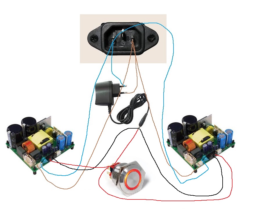

I'm still undecided about just using the 20A switch or using a relay with a 120V coil. Here's a link to such a relay: T92P7A22-120 TE Connectivity Potter & Brumfield Relays | Relays | DigiKey
It's rated for 30A, but I'm unable to find the rated surge current. Probably OK for 74A, right? Maybe at reduced longevity? I'll probably only cycle it once per day, so if it lasts 20,000 cycles instead of 100,000 I'm OK with that.

So how does the timing work? The small power supply comes on quickly enough to send the large power supply to standby mode before it can draw the surge current? I understand that once it is plugged in you would use a smaller switch to control the small supply to toggle the standby input, but what about initial connection? I suppose they've thought of that, I just can't find where it's listed.

So... the Meanwell RS15-3.3 and the Hypex SMPS1200 are permanentely connected to the AC... and you put a small (or big) switch on the output of the Meanwell RS15-3.3 to feed (or not) the standby pin of the Hypex SMPS1200 in order to switch it on of off.
"Applying an external DC voltage to the Amp Standby pin will put the amplifier in standby."
PS: if the swich is closed at a the cold start... i don't know what may occur 😕

All you need is cheap low voltage power supply, like I said, mobile phone charger at 5V is perfect and a NC (normally closed) switch, current rating irrelevant for this application, led illuminated antivandal switches are nice.

Sync is easy, I am using one mobile charger for two hypex smps, just split the wires, AC side of wallplug goes via switch.
I am using this solution for two years on a daily basis, so you can guess my opinion.

This thread is getting weirder and weirder, and I am not sure if it is a language barrier or you are pulling my leg. This is how it should be connected. I was lazy to look at the manual for real pinout but it should be obvious what to connect where, amp will be off when you connect IEC receptable to the mains. If you have trouble using cheap mobile charger for the purpose, use 4,5V battery, I am sure it will last a long time in that position.

There is a NTC resistor which protects against inrush over-current. On VSSA threads some users even replaced it with a wire as a modding exercise, along with caps change.
