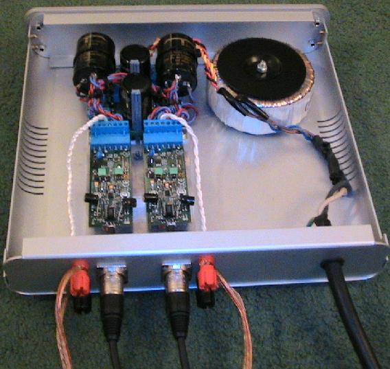

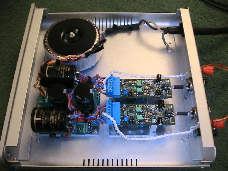

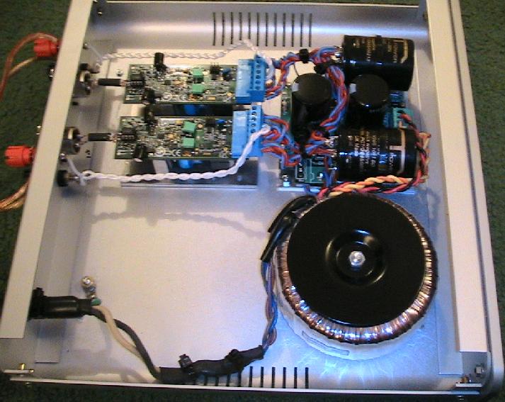

Want them compared to a UcD? I've done all I can to put them on a level playing field... so it gets harder to wash your hands of the results, you see? How evil is that!
They're fairly equally implemented now, both have balanced inputs, all bridges are snubbed, they all have T-networks, 15 000uF per rail per channel Vs 10 000uF per rail per channel as opposed to the stock 5 000uF. They're both wired with one channel in opposing phase, and noise floor is now equal on each channel. Aside from the transformer which is twice the voltage and half the current capability (nerf) with no additional shielding, they are fairly equal, and I believe can be compared, somewhat honestly, allowing me to retain some level of credibility I hope, but I'll get to that later, I'm typed out for now.

I'm glad for that, it really should.
Don't worry though Lars, it's not going to be all bad. They are different animals after all, and I intend for my comments to reflect that. So here goes:
Fact is I find your amp is alot better now, although more so on less efficient speakers, otherwise the hiss still gets to me after awhile (tiring). Call it a side effect of such high gain maybe? Call it higher EMI too. So what happens is, I turn it up enough to bury the noise, and then play something dynamic...... it gets a little crazy! I'm able to listen to UcD at far lower volumes far more comfortably, because it has no such noise.
The changes I've made to the supply really helped with the sloppyness, as did going with fully balanced inputs (big difference, do it!) and inverting the phase of one channel, along with the extra caps, it now acts like a fairly stiff supply even on my cerwins at louder volumes than I enjoy for casual listening.
In terms of soundstage and holography, you come up markedly short Vs UcD, but it does perform enjoyably none the less, and I'm willing to bet your Nerf xformers plays a big roll here. I do intend to swap xformers later on to rule that out, but I'm just in no hurry for that. I also think a better supply in general would go a long way here.
I hear the switching noise on my speakers over the hiss now (reduced hiss) so there's still a heterodyne problem with it, absent on the UcD (entirely) but the heterodyn noise doesn't follow along with transients anymore, not audibly for mostly all my recordings (ty spaghetti) which I have to say, it was kind of bad at first. So I now find that acceptable. This can possibly be improved further with some added filtering (ferrites etc), but alas, I've made no extra effort in that respect for the UcD either (equally implemented, equally treated).
On the Sound Dynamic speakers (lower efficiency) none of that bothers me much at all as it's far less audible, as is turn on/off noise, which the UcD does not have at all. So I actually find it really very enjoyable on the sound dynamics, extended listening is a real kick on them, I can also better enjoy the dynamics without it being too crazy for the neighbours.
On the Cerwins, UcD is deathly quiet, but it has lower gain, also enjoys a better transformer, far better supply (fully floating.. I couldnt' help you there Lars). EMI performance is also alot better for it though.
So yeah, they're just different, really different. I've listened to your amp for a week straight without tiring, it's still smooth, but not overly so, as I found it before, and "very" musical, there's nothing cold about it. UcD is also musical, put is pushing more analytical. Don't forget though, that's stock (and wont' be for very much longer).
You enjoy the result of some slightly more expensive components at first, UcD has that stock thinness, yours doesn't, but that's too easily fixed for it to really be an issue.
Yours is now imaging half decent, with weird holography at times, certain sounds just fly right out, some surround you, others not. UcD is fully enveloping at all times across the entire frequency range, with a dark black depth, just amazing. Truth is, there's no real comparison here at all. Not yet, but I do still see further potential.... then again, UcD also has alot more potential.
I'm afraid there's really no small difference in the character between the two, to be bluntly honest, they're very different.
I imagine all aspects of soundstage /imaging/etc of NCD would further improve with a better transformer and even more so with a better supply altogether. There's still untapped potential here. So there's no newfarce amp o the year award, but it's not in the trash bin yet either, not by a long shot.
