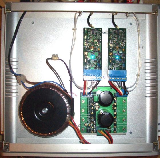

I read in HIFI4allDK Forum Digital that all preorders except those with 15000,80V caps (?? why haven't we been told about that option??) are now packed and I suppose will be sent out on monday.Is that correct?
Hmmmmmmmm.
With the 63V 10 000uF caps on my NCD supply, you kind of have to sandwich the cover on the case. My T-networks squeezed in nicely as well, but 80V 15 000uF, going to need a bigger case guys.

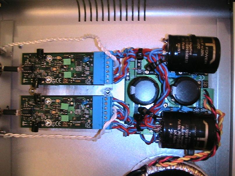

I'm aware how the wiring of the supply looks, like some sort of a spaghetti incident. Trust me, there's a method to the madness, and it has reduced heterodyne to much more acceptable levels, that's to say for the most part, it's now imperceivable.
If you have a careful eye you'll note alot of little changes. XLR are implemented, the obvious T-networks, magically floating above the supply (how'd he do that??), snubbers snuck in there somehow too, along with bleeders, unused plugs/connectors removed and a little twisting here and there.
You can't see the black gate caps installed, they're on the bottom side. The caps you see added near the op amp are panasonic FM's, 25V, 220uF. A good addition. This is how they stay.
I also took the outputs and bent them over the connectors as you can see, the goal here is obvious I should think, get them away from the power rails as much as possible.
There's no doubt more I can do... but this to me is the bare bones basic stuff I feel required in order for it to stand next to my UCD amp at all. Sadly I'm not granting Plitron the sale of another overpriced hunk of metal. Dealing with them just once left a bad taste in my mouth.
