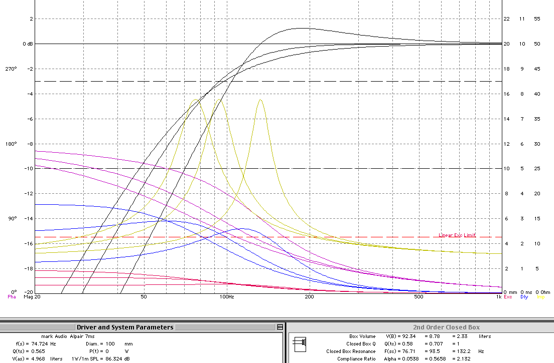

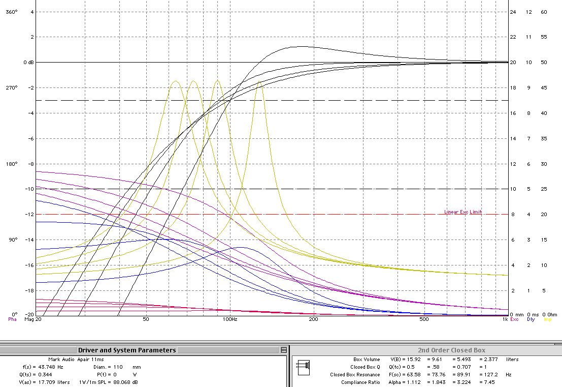

How low a box goes depends on Fs Qt and Vas.
But if one considers Hoffman's Iron Law and we consider that the A7ms is not as efficient, and the optimum box is the same volume, one has to get lower bass from the smaller driver.
The main reason is th every low Qt of the A11ms. Perhaps a trade-off to get the sensitivity up.
Now i hope these sims don’t make a liar of me. Edit: they only show that they are really close sealed.
Now the sealed sims don’t say anything about vented wizardy and keep inmind optimum vented volume is close to the ).58 sealed box.

OK, looking at the sims, the difference is not all that significant, maybe 2 more hz for the A7ms when nboth mounted in optimum miniOnken,
Small enuff that differences in alignemtn could make thigns quite different.
At least with Nosdtromo you can mostly adjust for the ampifier's highidh Rout. Less bass wilnot excite the bass modes inyour room (or do so less)
