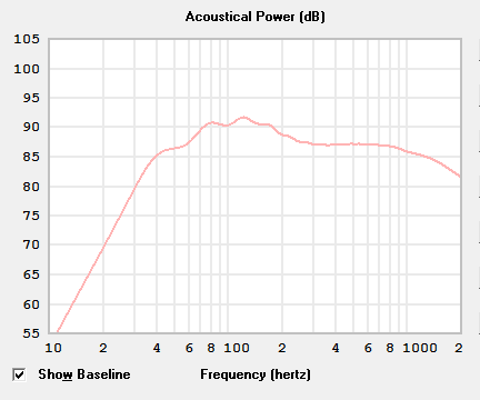

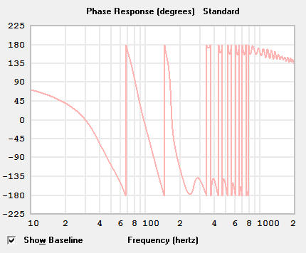

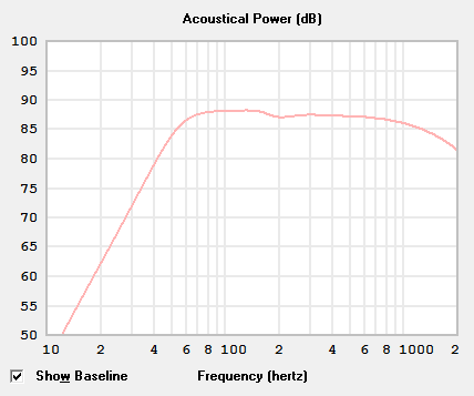

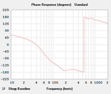

Don't have the XL plans, so just did a 'quickie' MS 11 scoop bin/BVR/BLH and the MS 11 Pensil to give you a 'ballpark' comparison.
Note the mid band efficiency is the same with cab volume [Vb], shape accounting for any mid bass gain [~200 L Vs 63 L].
GM

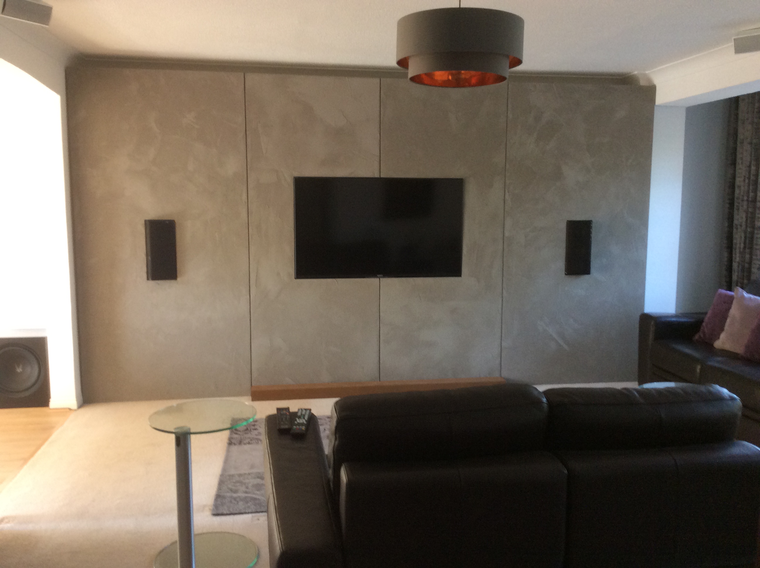

Dear all,
These drivers look extremely interesting & I’d really appreciate some advice from you experienced guys.
As shown in the photo, my system has the left & right speakers set into a decorative partition (covering an old/unsightly fireplace) with an active bass unit either side, a Lyngdorf integrated amp performs xover/time alignment duties & powers the L/R speakers, listening distance is 2.9metres from the face of the partition.
I’d like to replace the L/R speakers with a pair of these Alpair MS & flank them with a floor to ceiling stack of four 12”woofers per side, advice on target xover frequency appreciated but I’d guess around 200-400hz ?

That is an interesting and good looking setup you have got there 🙂
Anything from 200 up would be good, you could get a little lower maybe but you might have to take into account the impedance slope of the A11MS, from 200 up it's fairly benign so filters will simple. On the other hand, you could just run the A11MS full range in a sealed box as you suggested and then just bring the subs in below that. I'm not sure which subs you've got but not that many are happy up around 200Hz

Hi Stefan, thank you very much 🙂
The Lyngdorf integrated amp that I have & would be driving the A11MS, has user selectable digital xovers/time alignment & room correction built in so is very easy to play around with different configurations once the system is up & running.
What kind of size cabinet would be needed for the A11MS sealed (assuming 200hz upwards xover)?
The current subwoofers will be making way for a new pair that are suitable to xover up to 400ish hz, my initial idea is a floor to ceiling array of four 12” pro style drivers each side, I didn’t want to ask for driver suggestions on this thread as it’s dedicated to these new MA beauties.
