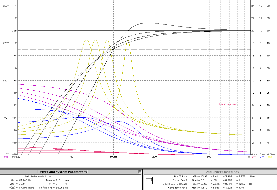

Hi all,

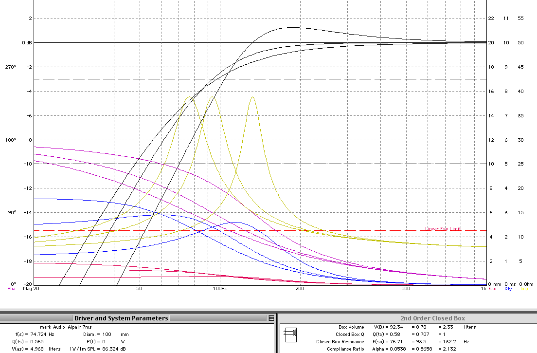

Re. the Alpair 11MS, if only using from approx 200hz upwards, what volume would be recommended for a sealed enclosure & would an irregular shape be desirable ?
Typically one would choose a butterworth Q — 5.5 litres undamped, so 5 litres or so with. That will give max flat with a 2nd order rolloff at 90 Hz.

Hi Dave,
Is that unusual for the smaller driver to require nearly twice the volume of the larger, also, would you recommend making the inside of the cabinet/enclosure an irregular shape ?
Many thanks
Jason
There is a significant difference in Qt between these divers… the much higher Q of the A7ms means it will need a larger box despite the lower Vas.
Scott is designing big boxes for all of these, but like the P7 & P11 (13/9 l)the A7ms has a larger optimal miniOnken (11 litres), vrs A11ms (9 litre). A miniOnken alignment looks for a very specific shape of the box HP filter (ie simulated FR).
The A7ms also has a slignthly lower F10.
