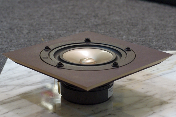

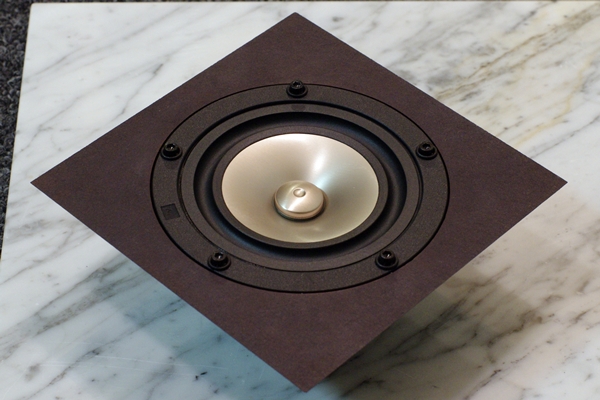

I received a pair of Pluvia Sevens yesterday; they look very nicely made. My question is for anyone who has cut a rebate for these. My circle jig uses 1/16" increments so I'm wondering if 4-13/16" would require too much sanding and if I should go bigger. I recently had to cut two sets of baffles for drivers I'm probably not even going to end up using so I'd like to get these right the first time. Thanks in advance for any help. --Greg
If I'm not mistaken, one of MA's intents with new Pluvia low frame profile and resin formula was to eliminate the need for rebating for flush mounting. I built a quick pair of small vented boxes for these just recently without the rabate, and by hand made circle router jig.
As of yesterday, they had less than 50 hrs breaking in as TV speakers, so,it's probably too soon to seriously assess them.
You could probably forgo the rebate and get he same performance with less fiddly labour, and just to make for an unforced fit I'd allow perhaps the closest imperial increment above the metric conversion of required cut-out (144mm, wasn't it?) for which your router jig is calibrated, and still chamfer the rear side of cut-out as steeply as your bit's bearing will permit.
Thanks for the reply. It's very tempting but I just love the look of flush mounting, and I can't help thinking it would be especially nice with inverted surrounds allowing for a truly flat profile. At 3mm depth, I could do it in one pass although I'll probably use two. I guess the decision comes down to having 1/32" space around the frame or just running some fine grit sandpaper around the smaller hole. I seem to be a glutton for punishment lately when it comes to getting this stuff perfect so of course right now I'm leaning towards the latter option.

Here's mine, but using the CNC helped a little...
I think the drawing published on Madisound's website show outer diameter as 172mm X 4mm deep, internal cut-out at 143.6mm
That's the Pluvia Eleven. I would have tried those but they won't fit in the enclosures I'm currently working on. I think my jig might cut very slightly on the bigger side so I'll try the tighter fit first and feel it out before I cut all the way through. Thanks, everyone.
Nice job, thanks for sharing that. Do you remember the diameter of the recess you used?
My drawing shows a 4.90 in dia x 0.150 in deep rebate, and a thru hole diameter of 3.98 in. I also measured the spare one I made and it was pretty much on as the drawing indicated, so I assume the ones I actually used in the build were too.
