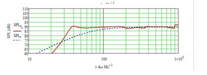

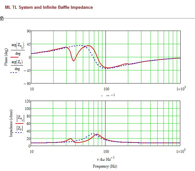

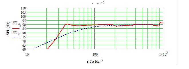

Wiggle,
Here are the mathcad results.
I haven't had time to optimize the design, but IMO this design is tuned too low.
The saddle-shaped hump before roll-off usually results in a bass response that is perceived as untidy.
Furthermore, I have attached the cone displacement graph should you need it.
The model contains 0.3 lbs/Cft of damping material in the top third part of the enclosure.
Simulated at 2 watt input.
Also note that MJK's worksheets do not take into consideration the added resistive component that comes with a high aspect ratio port.
Hope it helps.
Regards
Nick

Thank you hajj and Valeric. Perhaps I should be looking at modifying the tuning. I will also find these tools and try to figure my way around them.
Few do and the difference is major, so as is the cab will be tuned enough lower to make an audible difference/reduce power handling. The main cause though is that with a shelf vent, three of the four vent walls are very long, so the shelf must do all the compensating to average out its acoustic path-length.
This calculator will get you a lot closer, i.e. much shorter vent, though it won't factor in any 1/4 WL TL loading nor any very high aspect ratio acoustic resistance, so still will be a bit too long and why you may want to experiment with different length shelves and even no shelf at all, the most often choice selected in the MLTLs I've done or spec'd for others: Car Audio - PORT Size Calculations and Formulas for WOOFER and Subwoofer BOXES
Note that 'bjorno' posted a very comprehensive vent design tutorial here some years ago, but lost my link, so recommend finding it to help with the various types of vents and their 'end corrections' that combined with its physical length makes up its effective acoustic path-length.
GM
Wiggle8,
Probably, but it's not a big change in tuning. But I would suggest tuning in to 50-55 Hz range.
Regarding the tools, I only have direct experience with LATL, but my impression is MJK's worksheets model stuffing better. That said, LATL is easier to load (doesn't require MathCad), and, I suspect, a easier to use. I highly recommend downloading LATL and playing around with it. If you find that it is useful and you enjoy doing it, you may want to put in the extra effort to get and learn the MJK worksheets too.
Eric

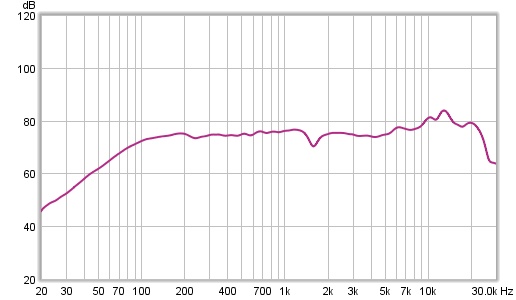

I merged (at 3kHz) a 3" and (gated) 18" measurement of each of my P7 speakers and averaged the resulting responses (which match very well). I think the response is very close to the published graph (I tried to match the scaling). My dac was calibrated but the mic (UMM-6) was *not* calibrated.
How about a little less smoothing though. I'm guessing things get pretty ragged after 5khz...
I used the 1/12 oct. freq dependent window in REW which gives similar visual results to 1/6th oct smoothing. The driver's response even with 1/24th oct. fdw is actually amazingly good with the exception of the 1.5kHz dip and peaks at about 10kHz and 13kHz. I can get the response very flat with EQ if I want to...
