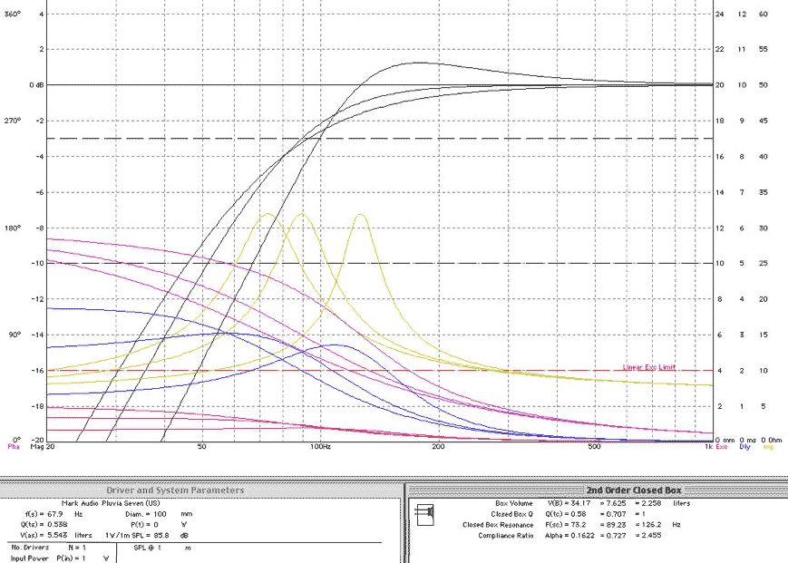

I am fairly new to the speaker building community, having built three sets of speakers to date which I'm fairly happy with. However, I'm still overwhelmed by the sheer number of factors and nuances that are involved in this wonderful hobby, but I'm trying to get better with each project. Anyway, to the point at hand...
I bought a pair of the MA Pluvia 7s and am thinking of using them in my mid-sized living room. The enclosures I'm thinking of using (just under 3 liters in volume) would sit on bookshelves mounted to the wall, and they would be supported by a separate subwoofer hidden behind the sofa, so they don't have to do much low bass production. I was thinking about putting a high pass filter on the driver with a value somewhere between 100 and 200Hz, so the Pluvias would only have to handle freqs above that. I've tried modeling this in BassBox 6 Pro but the graphs all look like a mountain, with a peak at about 130Hz and a steep drop off on both sides, which seems impossible. This is for a closed box enclosure. I've also tried this with a vented box and its not much different. So either I'm doing something wrong (I've checked all my S/T parameters that I've entered in Bassbox) or this driver cannot be used like that. Anyone have any ideas on whether my plan will work or not or is this just a dumb application of these drivers? Any help from you guys would really be appreciated! Thanks!
I don’t currently have access to my sealed simulations, but 3 litres is likely too small for the P7.

It is impossible, that's the downside to purely mathematic based calculations (not that BBpro is a bad box designer for simple enclosures -it's quite good).
Depends what you are referring to by a high pass; 130Hz is a bit on the low side to avoid excessive changes due to the rising impedance around tuning / resonance, especially if low order. This is a fairly common issue with very low XO frequencies, reduced somewhat with it raised a bit. Always a tradeoff.

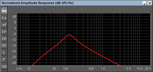

If BassBox 6 have feature to export response and impedance as frd and zma files, you could try out free XSim and see if over there in XSim by linearize impedance somewhere can get your desired response, here is link to XSim http://www.diyaudio.com/forums/software-tools/259865-xsim-free-crossover-designer.html.
Other possibility is if your Pluvia 7s have dedicated power amp not shared with subwoofer then you could do the passive XO at input of power amp where impedance is nice flat instead of the normal at output, math for PLLXO (Passive Line-Level Crossover) is to find at this link and notice at top there is a nice helping spreadsheet for calculating values shared for download TLS.org | Passive Line-Level Crossover.
That is a big help!
