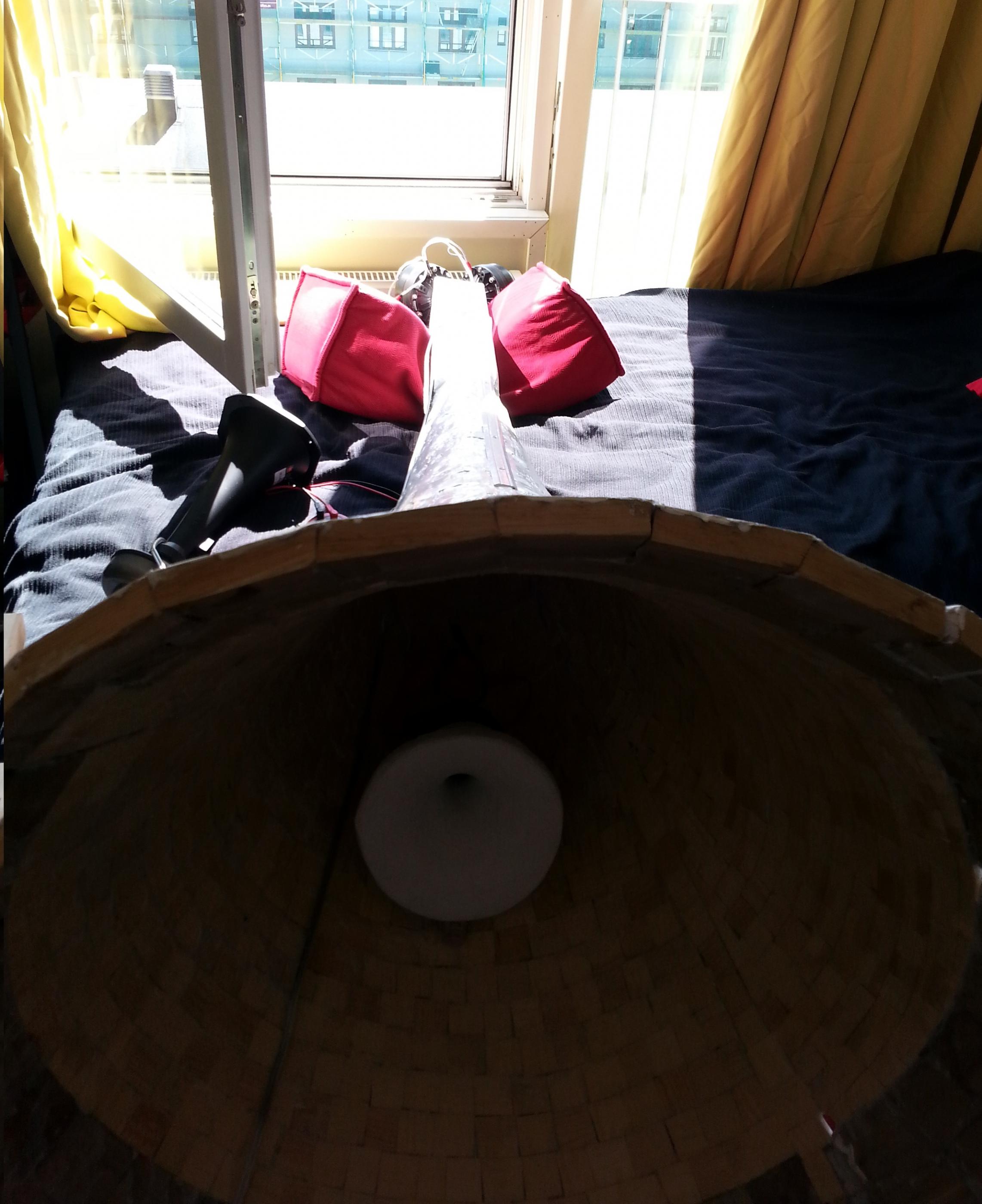

Yep! They go 50-100Hz lower than a single K55, to my ear, when I play with the minidsp. Used very steep crossover slopes and also normal slopes. Some day I could try twin K55. Everything has sounded very consistent with what Radian showed with Dietmar's graphs.
I tried the K55 as a tweeter in a JBL 14-25 horn. Great sounding midhorn, BTW. Cheap too. Fits well with the shape of the Goto S-150. But I ended up with the Beyma 1" in an Avantgarde Trio tweeter horn, that is a much better sounding tweeter. This is the third tweeter you see.
If not my tube amp starting popping I would have tried the JA6681B as a mid also. I wonder if the JBL 2204H can add anything extra. It could probably give a little nicer midbass around 150Hz. But I could force a future subwoofer to do that.
Sound is really nice for singer song writer music. Rock, and metal is scored for big cone drivers. I used my JBL 2204H up to 2kHz with a ribbon tweeter above yesterday with friends, and it can play everything I would every need for a party. Horns are for afterparty music and lazy Sunday afternoons.

Yes, more than the JBL. The JBL is clear but sort of boring and muffled, as if it was a speaker. Like listening to Nick Drake trapped in a box. And you can't hornload the JBL to increase its vividness, because there would not be the same amount of detail to gain as a compression driver. I feel a compression driver is doing everything in minitature, and a horn just enlarges that that detailed miniature world.
The big advantage of the JBL is that I can play any music, without any harsh sounds, that I can hear on som records. I guess this is what drove Angelo to go with a JBL and TPL-150 - great choices for party music. And then I mean pretty good sounding party music. Not like Cerwin Vega. I should not bash them too much as I am building a lab horn that is similar to a basshorn of theirs.

The SD-370 should not exhibit any harsh sounds, at least not in the range up to 1khz.
Phenolic drivers are not known for that.
How clean are the air gaps?
I can ask Dietmar if he heard any harsh sounds with his SD-370.
His whole chain is really revealing so if he did not hear any of that,
than there is something else going on.

I am speaking about listening to different genres. Cone drivers will usually play rock and metal music better. The distortion sound from the guitars were recorded from 12" cone drivers, and should also be played back with 12" drivers. For some reason that is true for some electronica music. Some electronica bands use distortion effects on their synths.
For analog music, like singer-song-writers, quartets, MTV unplugged, etc, compression drivers win almost every time. The recording has to have a certain quality for it to be worth increasing the detail with a horn.
Right now I am listening to phenolic and PM-4 polymer diaphragms.
