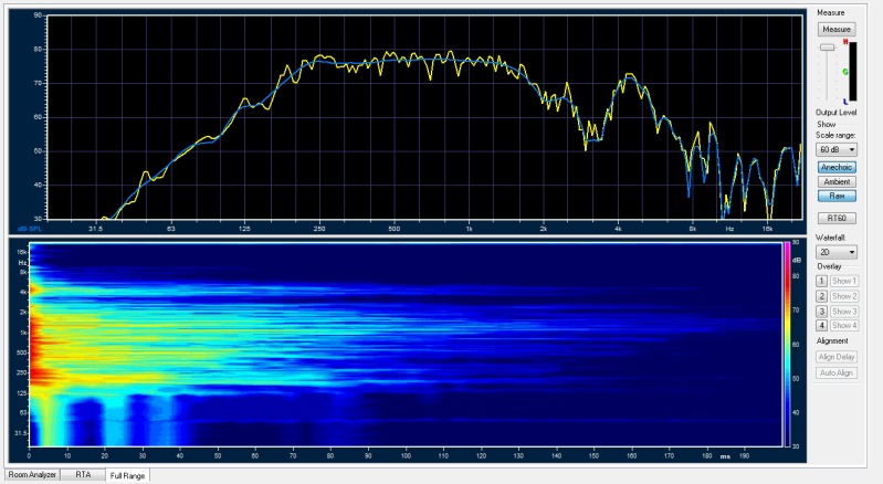

I haven´t read the whole thread but I believe i saw Eighteen Sound ND410 being mentioned somewhere. The attached image shows the on axis response of the ND410 in a 180Hz tractrix horn without phase plug or back chamber. At= 49cm2 IIRC.
