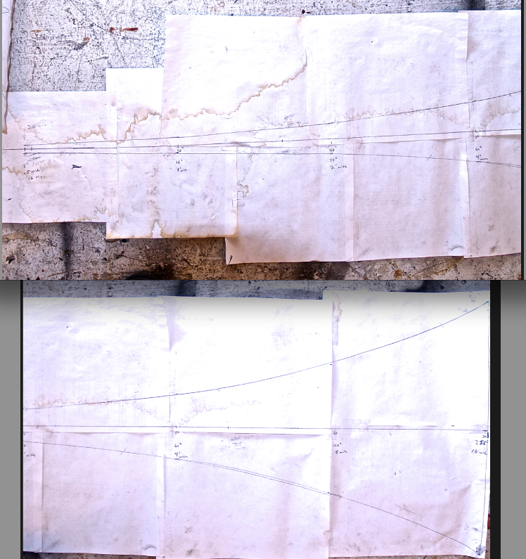

After digging out after a 1000 year flood, I recently finished building and testing a long folded horn.... the Fane S 8M or any other midbass cone driver can do that with less effort i.e. a lot more Oomph!, and without weird distortion. Plus the horn would be less than 4 meters long. I am sure one can hear a little difference in detail between a midbass compression driver and a cone driver but the difference will probably be subtle below 300 Hz. If only the Yamaha could extend lower... But they probably can't. The K55 reached lower than the Yamaha which means there are differences in the drivers. One has phenolic suspension, the other has copper with beryllium gimmick content. The K55 did have about 30 cm longer horn though.
The sound I have now is much more profound than before with the signal horns.

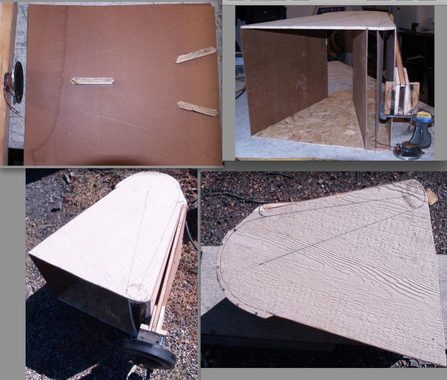

The four fold horn was built to see what low frequency could be achieved using various drivers, and how it would sound compared to conventional front loaded cone speakers.
The horn loads down to about 75 Hz, unfolded length is around 80 inches, a bit over 2 meters.

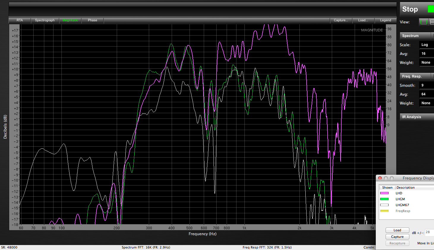

Tried two compression drivers, an EV DH1AMT (1.4" exit 3" titanium diaphragm) and a Jensen Hypex (screw on .75" exit, approximately 2.25" aluminum diaphragm) their response fell off below 400 Hz.
The sensitivity was unexpectedly low, only around 105 dB midband.
Even so, distortion was respectable, at 350 Hz less than 1% at 106 dB one meter ground plane for the DH1AMT .
At 250 Hz the distortion rose to over 10% at only 94 dB.
In free space, low response drops quite a bit, the horn is much more usable against a wall.
The frequency and polar response is quite ragged, even after much EQ the horn does not sound very good.
Next, a Goldwood GM-85/8 sealed back 4" cone driver (outside diameter is 5.5") was tried, it made it to 300 Hz, even though it's FS is 470 Hz. Upper bandwidth drops off around 1600 Hz
By drilling two 1/2" holes in the sealed back and using a compression chamber of approximately 100 cubic inches, low frequency extended to 75 Hz.
The driver now could go fairly low, but not very loud, a "full range" 5.5" inch cone diameter foam surround speaker in a small sealed box (200 cubic inches) put out around the same level.
