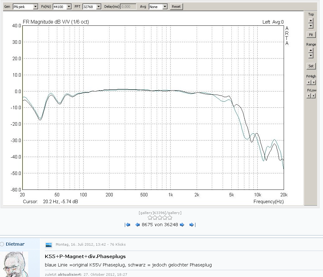

The only effect that the holes in the phase plug has is a bit stronger hf.......by drilling the holes in the phase plug the compression ratio is dropped somewhat. The uneven path length between the original path and the path through the holes doubtless has an effect at some high freqs, but that may be above the usable top end of the driver anyhow.
Important only for those who want to be able to get by with just a bullet
tweeter above the K55. There is no ill effect that we can see. Neither in the
response nor in the distortion department.
Noteworthy here is the fact that the compression ratio has almost no effect on
the frequency response from 100hz to 3khz. With that many holes we are
talking about a compression ratio variation of at least 30% .
In the picture I attached you see two identically modified units
only comparing holes vs. non holes.

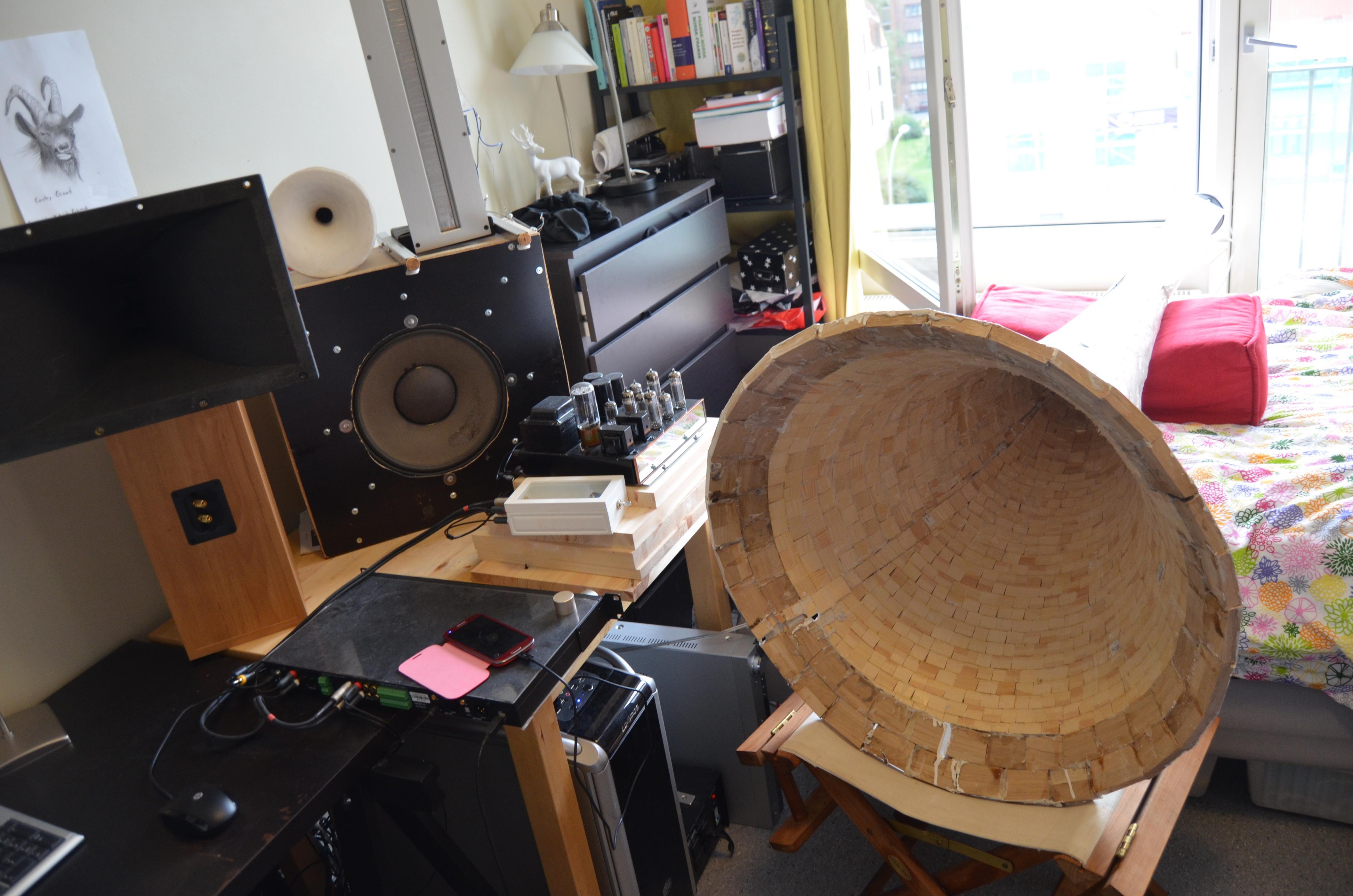

Okay, speed trials of the un-modded K55-V!
Setup 1:
¤ JBL 12" 2204H 60Hz-200 Hz.
¤ K55-V in a wooden 1.75m deep horn with 75cm diameter, inspired by the Goto S-150, that has 200 Hz as its lowest crossover point, hence the bandpass 200-650 Hz.
¤ JA6681B 650-4000 Hz.
¤ Beyma 1" above and beyond.
Versus
Setup 2:
¤ JBL 12" 2204H 50Hz-650Hz.
¤ JA6681B 650-4000Hz.
No ribbon supertweeter today. Too few amps are operational.
K55-V
+ The K55 gives me a feeling that Sinne Eeg, in the song "Brief Hesitation" is in the room , and not just in a speaker.
- The K55 sounds a little strained, compared to the JBL 12". Is this what could be horn honk? I suspect the culpret to be strange aerodynamical anomalies caused by a 1.75 meter cushion of air in front of the diaphragm.
- I was expecting the sound to be clearer, but maybe I am used to metal diaphragms and shorter horns. The deepest horn I have heard before today is the 40cm deep horn I use with the JA6681b. Do I dare to use the JA-6681b in the Goto horn? Naah.
JBL 2204H 12"
+ The 12" sound effortless. It does not have 1.75 meters of air to push against.
- The 12" JBL sound pretty boxy. As if was a speaker, and not a live performance. Go figure!
My room is too small to really assess it properly. I should really wait until after I have cooked lunch, because I get a way better, and very different sound walking into the kitchen, six meters away from my listening room, while still standing in the straight, and rather narrow beam of sound coming from the horns.
I doubt having a doorway between me and the system is the best way judge its performance. Still, it is slightly more enticing than the JBL 12" was before. It is a keeper!
I posted some pictures, as there are only some minor details left to fix. The horn needs some more sandpaper, another paint job, and a new appartment.

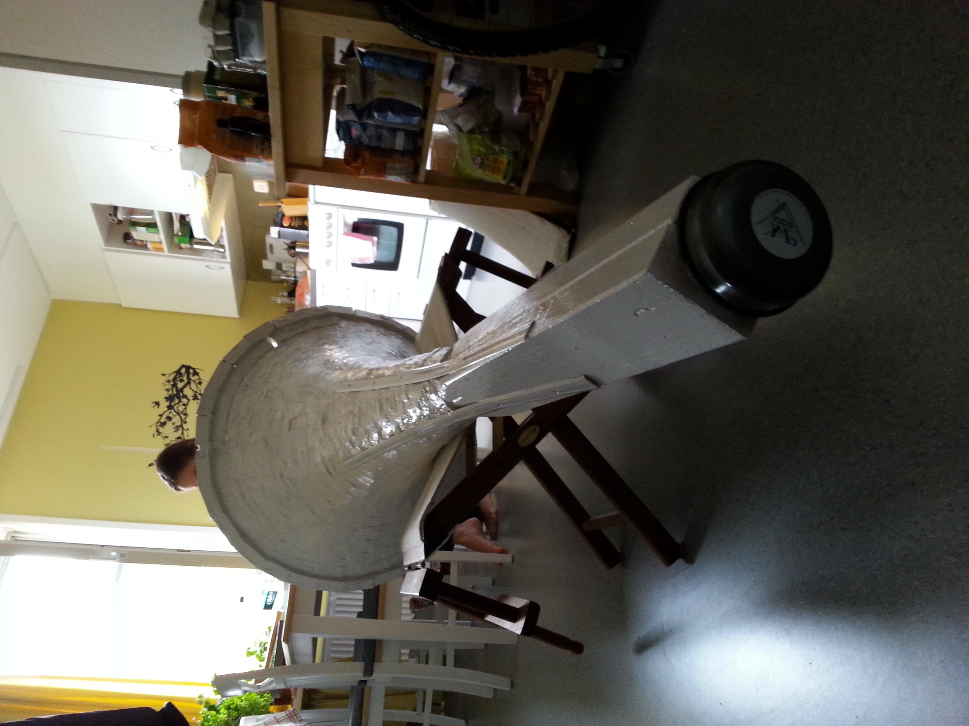

Seems like it was the 200-650Hz bandpass that made the K55-V go muddy. 200 Hz highpass works better.
Drop it, no. The wooden glue is not as solid as I expected. I will have to drench it in liquid plaster to make it not deform in the next years to come.
It is more sturdy, than you think, with a rim of oak on the outer edges of the horn. The first 50-60cm of the horn, starting from the driver, is in very solid wood, and I belive this to be the most important part of the horn, so I took great care to carve and grind it to exact specifications. Took me the two first days of vacation. Third day is for wine and re-listening to all my records.

Don't judge the K55 on this horn to early. There are just to many variables in a setup like this. Especially when it comes to small rooms.
When the SD-370 is bolted on this horn I expect a more authoritative output.

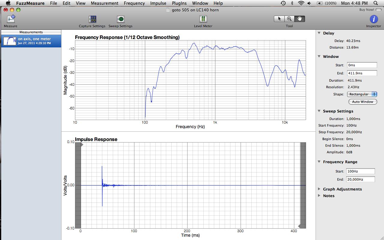

Not heard the Goto drivers, but the Goto SG-505 seem actually pretty bad around 100Hz on le cleach 140 Hz horn, see fig. I think Goto recommend 200Hz as the S-150 horn's limit, more because of the limitations in the driver they intended to use it with, i.e. the SG-505. If the FS100W sounds good to the ear, it has the ability to surpass the Goto SG-505, since it has good output down to 100Hz.

Rewind it is definitely ok to use the 6681b down to 250Hz. I do it all the time. Probably 200Hz is ok too.
The curve you put up seems to show the horn is only going down to >~300Hz. Maybe more like 400Hz.
_-_-
_-_-
It is just a curve I found from the Hifi Heroin blog, as a hint of the Goto SG-505 drivers performance.
