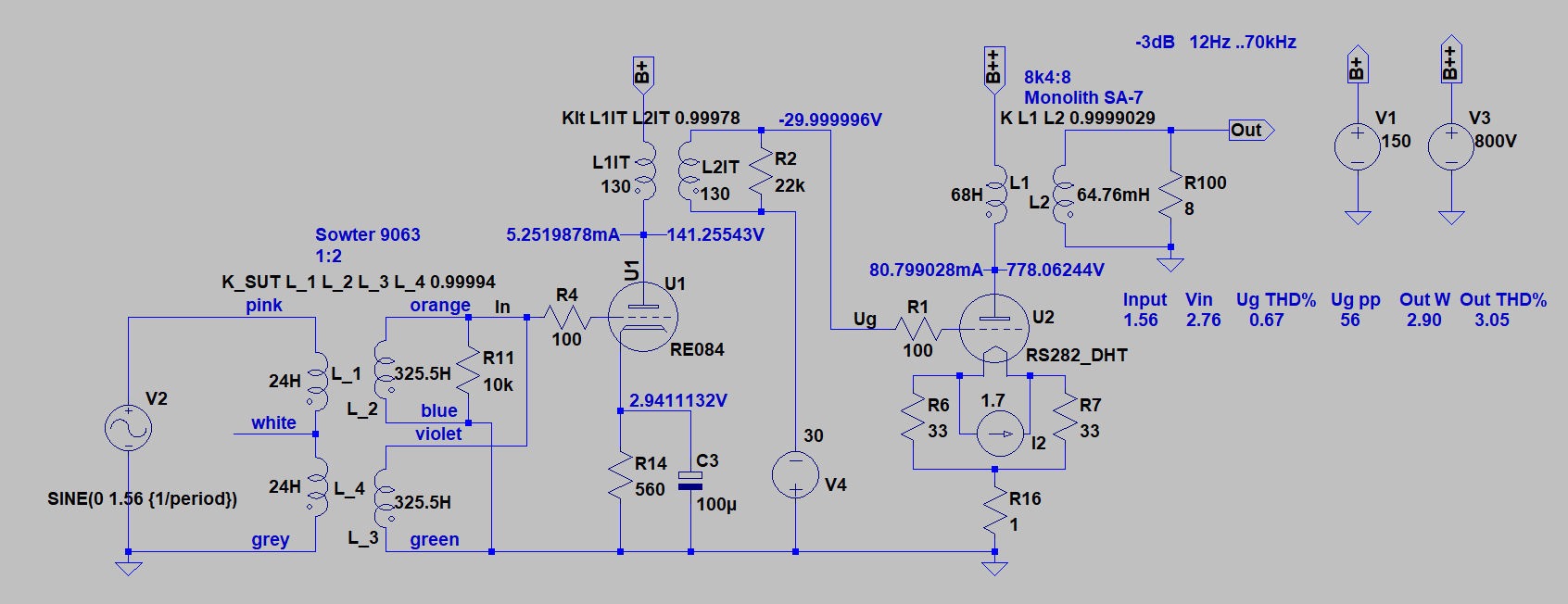

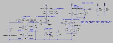

With this "driver" tube (no gain, low current, high impedance, high distortion ... ) this is the "ultimate" solution:
2.9W output with 100W power tube.
Worth it?
1:4 SUT, 10Y/801a, FET SF, fixed bias RS282 8k4 OPT (1200V B++) the simulation shows 14W output .... but with 8.6% distortion.

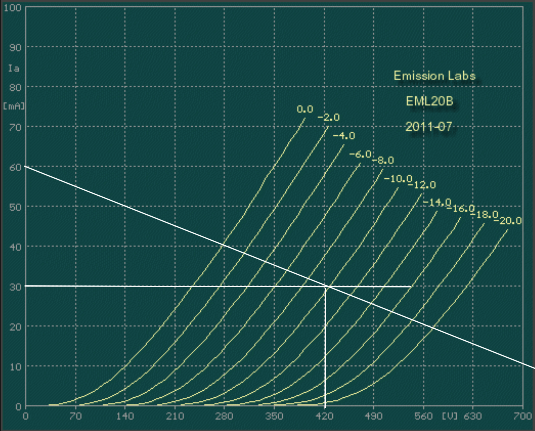

Thanks Bela, helpful. I have been emailing with Rob who uses the RS282 as an output tube SE at appr. 600V, 50A. As an alternative to the RE084, I could use an EML 12B or EML 20B. My interstage transformer has a max current of 30mA. Load lines of the EML 20B attached as an example of how I could use the tube. Thoughts?

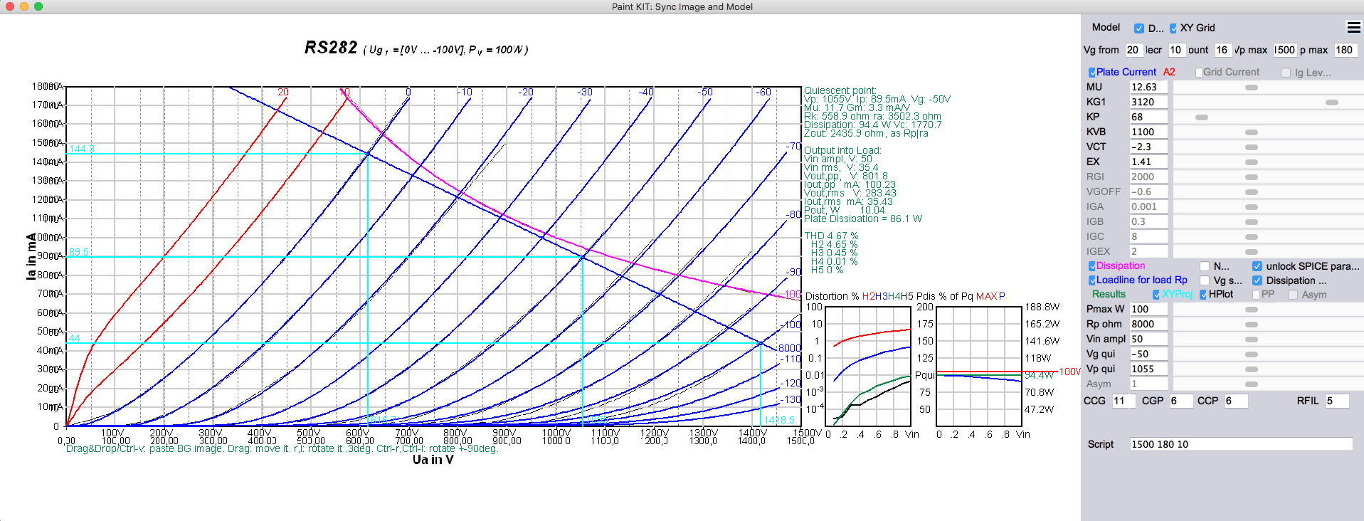

"What is causing this much distortion."
With this spice model, the simulated distortion is high ... higher, than Zoran suspected.
The real measurement would be different ... but these large transmitter tubes aren't distortion champions.

in these settings for RS282
input is 100Vp-p
output is 801Vp-p
Gain is
abs(-A) = 801Vp-p / 100Vp-p
A = 8
Cgk = 11 pF
Cga = 6 pF
Rg = 470 Kohm
Fo = 100 KHz
Vin(p-p) = 100 V
Cdynamic = Cgk + { Cga x [ 1 + abs(-A) ] }
Cdynamic = 65 pF
XCdynamic(fo) = 1 / [ (2 x PI x fo) x Cdynamic ]
XCdynamic(100KHz) = 24485 ohms

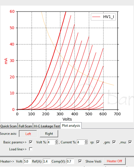

I found some informations about EML 20B tube.
Actually, one important set of parameters missing: Capacitances
(Probably it could be estimated based on similar tubes? Mu guess that is some RS series replica?)

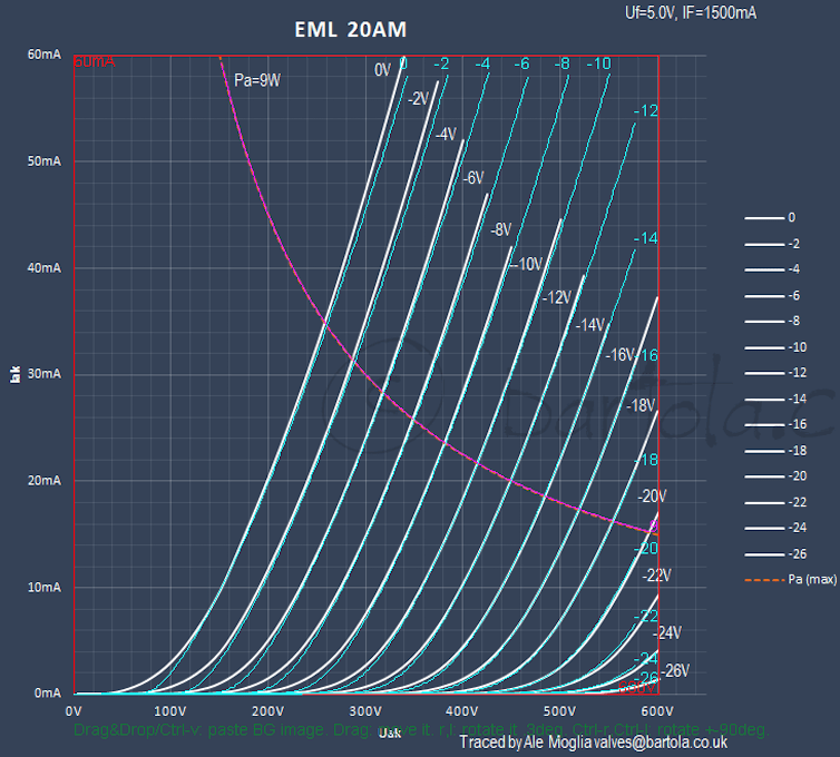

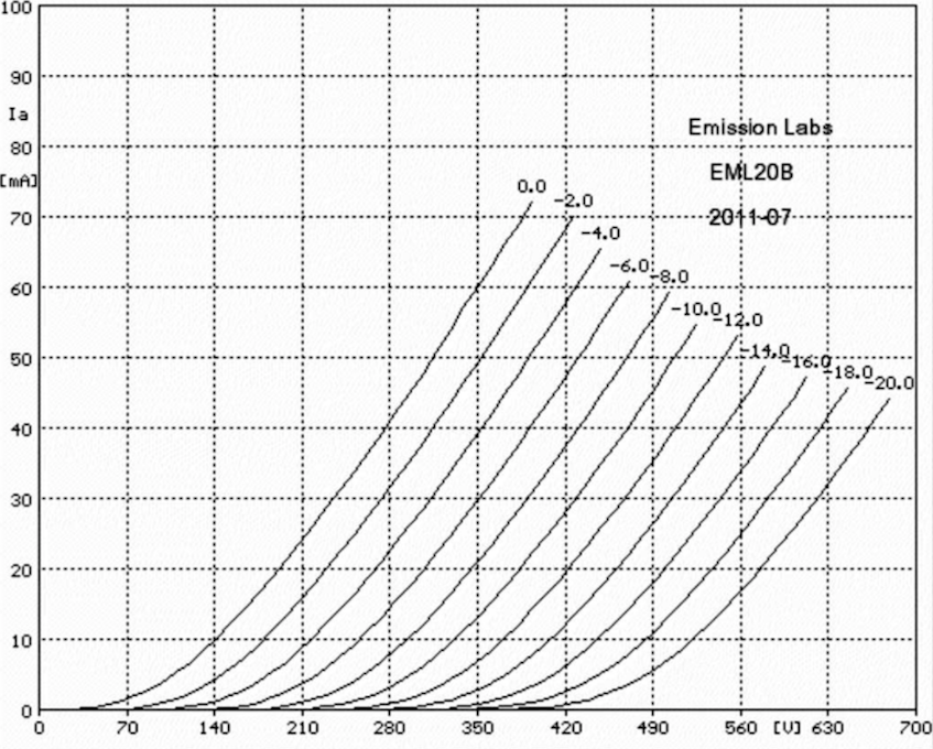

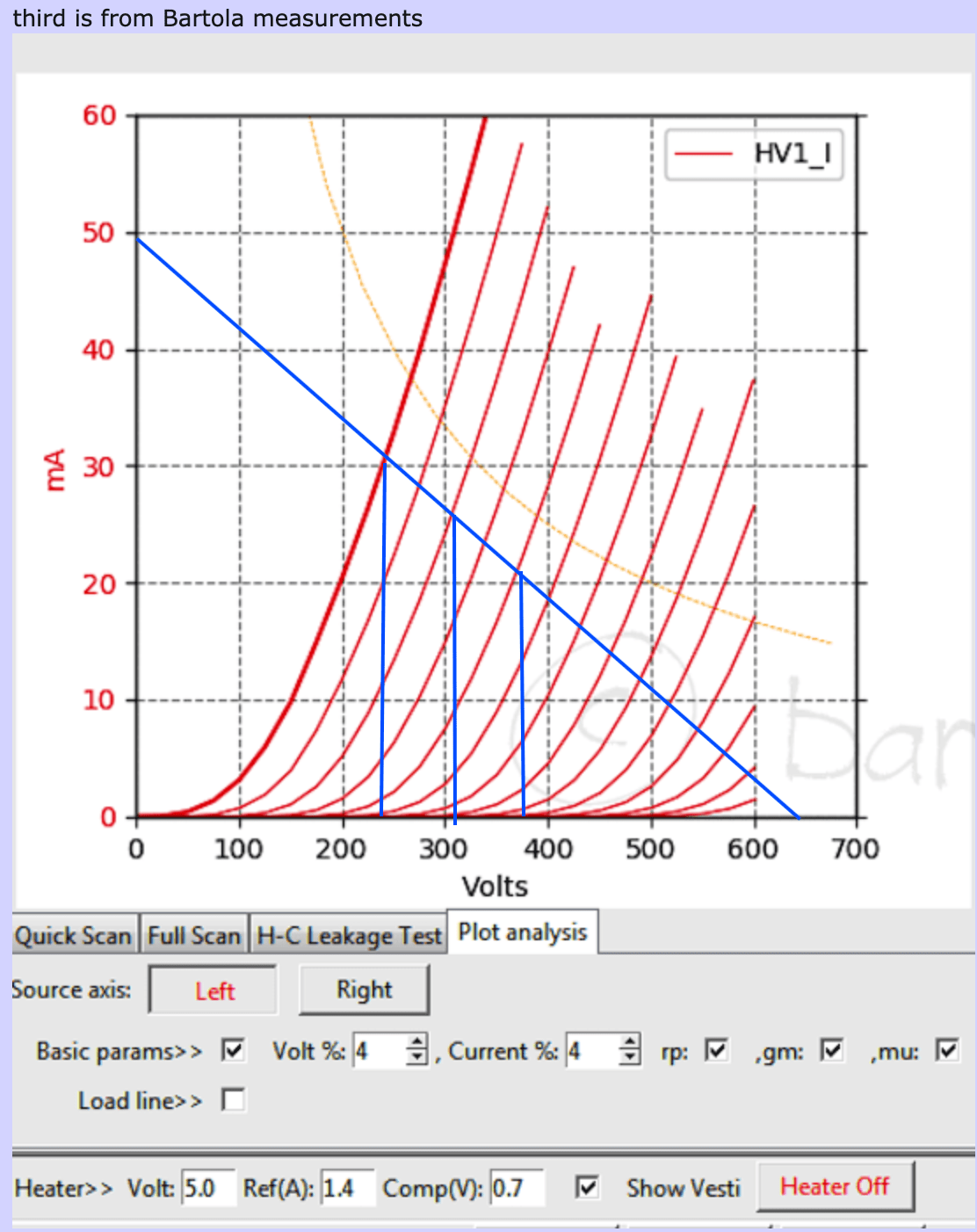

Second I found 2 existing measured anode chrs graphs by manufacturer.
They should be compared to have more clear insight of the tube.
(And one additional measurement of similar tube - different version...)
That is expensive pair of tubes and no need to rush-in?
first from EML site:
second is labeled as EML but not from their site...
third is from Bartola measurements
BUT note this is for 20AM VERSION, not 20B version
4th is also from Bartola
note hater values in the graph of: 5V 1.5A
BUT this is also for 20AM VERSION, not 20B version
The graph is set to max Pa of 9W
EML 20B maximum values:
Vamax=550V
Iamax=60mA
Pamax=25W
filament
Vf=5V 5% (+-2.5%)
If=1.4A
(Wf=7W)
The graps should be compared with manufacturers measurements
and estimate more realistic capacitances than one proposed in the spice model in EML site and on Bartola model

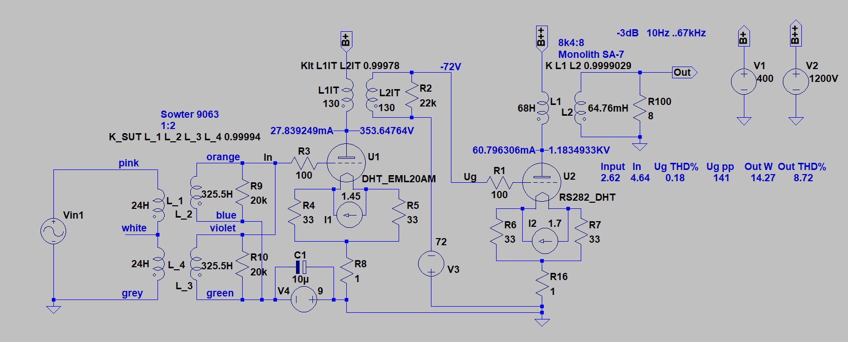

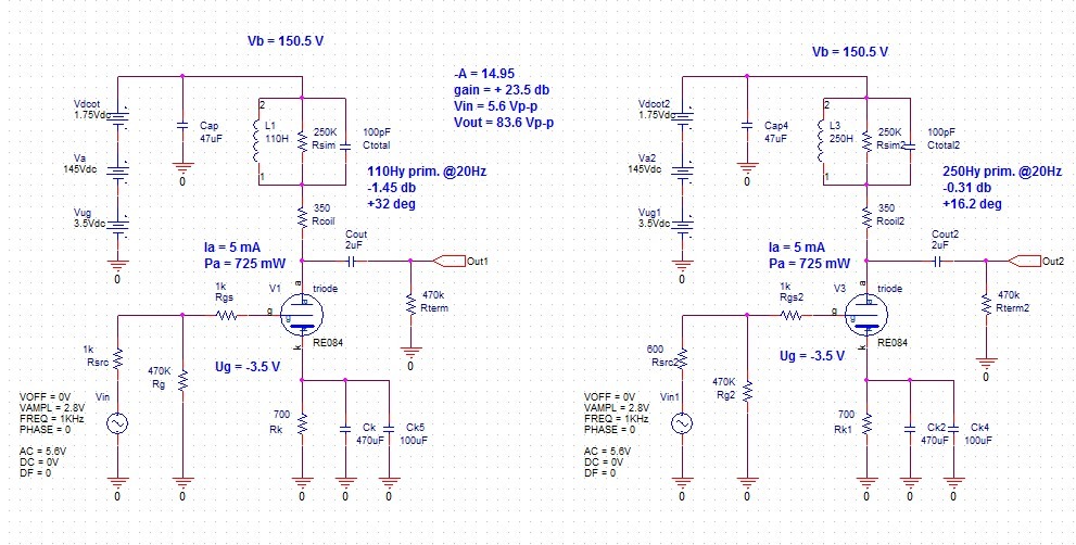

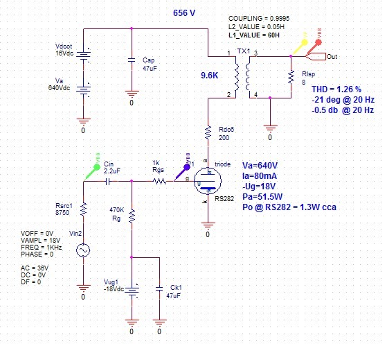

There are the settings You asked for specific points. I put the same RL = 9.6K, i didnt know inductance of Your piece just put 60Hy...
This is situation with undistorted input signal from ideal sim generator. I put the source impedance as RE084 Ri value of 8750 ohms
The HF roll of is dominant by Transformer Coupling factor (read capacitance and Leakage inductance...) more than higher Rsource value...
Add authomatic bias to reduce Supply voltage and to eliminate RC net in cathode - to isolate only inductance of primary as main factor in LF
